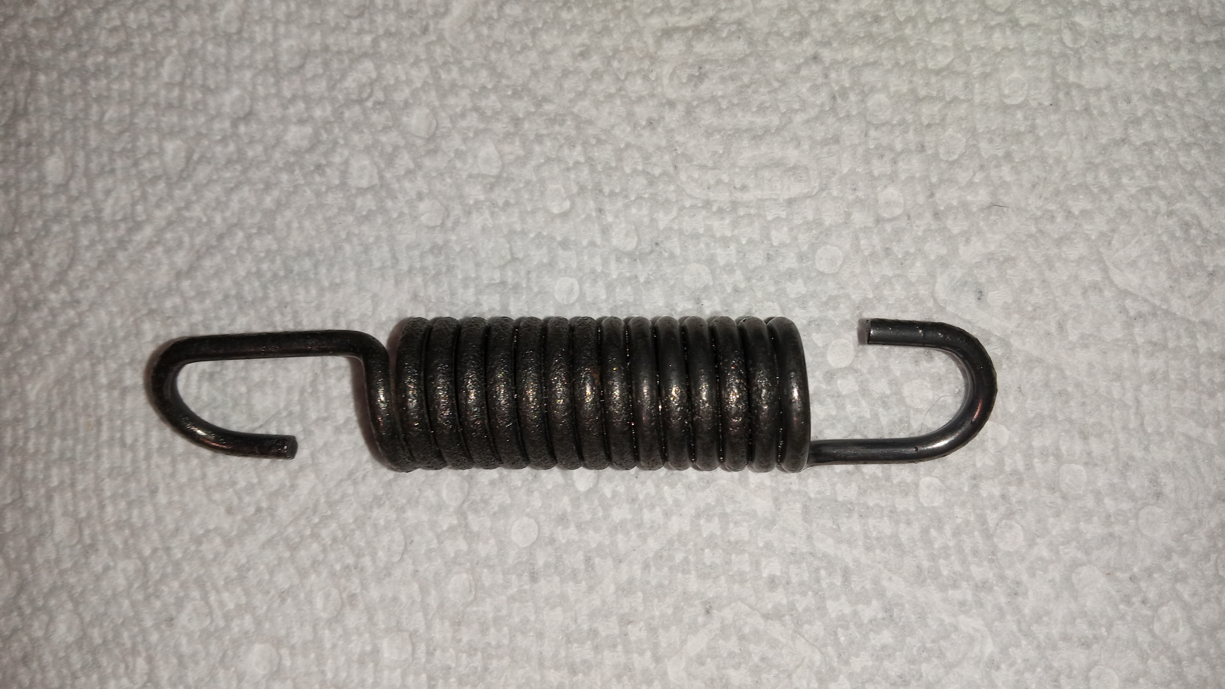

Re: '83 GPz750-A1 malarkey.

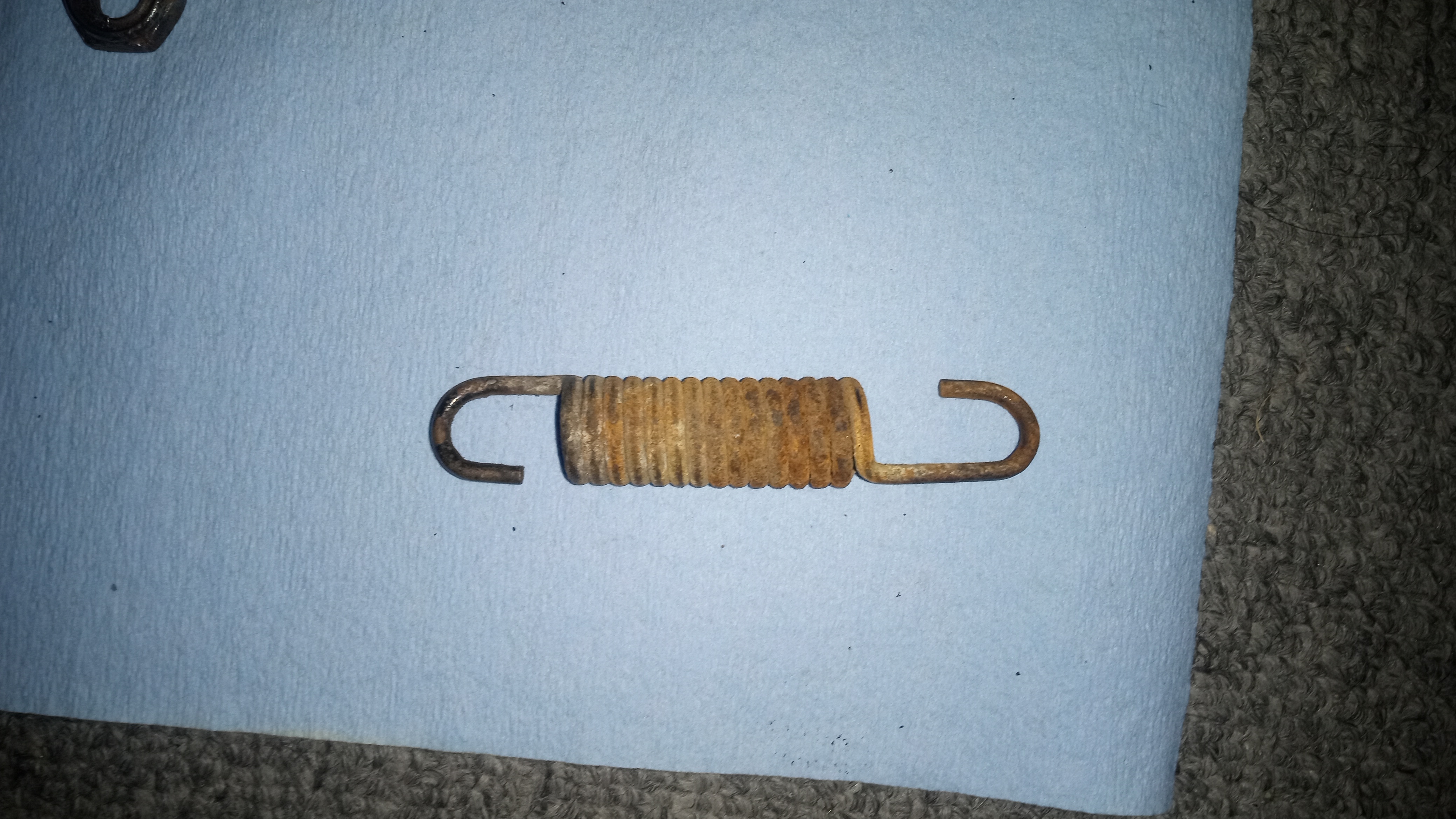

In other news:
That spring was sitting in the citric acid but there wasn't much of a reaction going on, then I put the jar it was in, in the small ultrasonic & it really started cooking off.

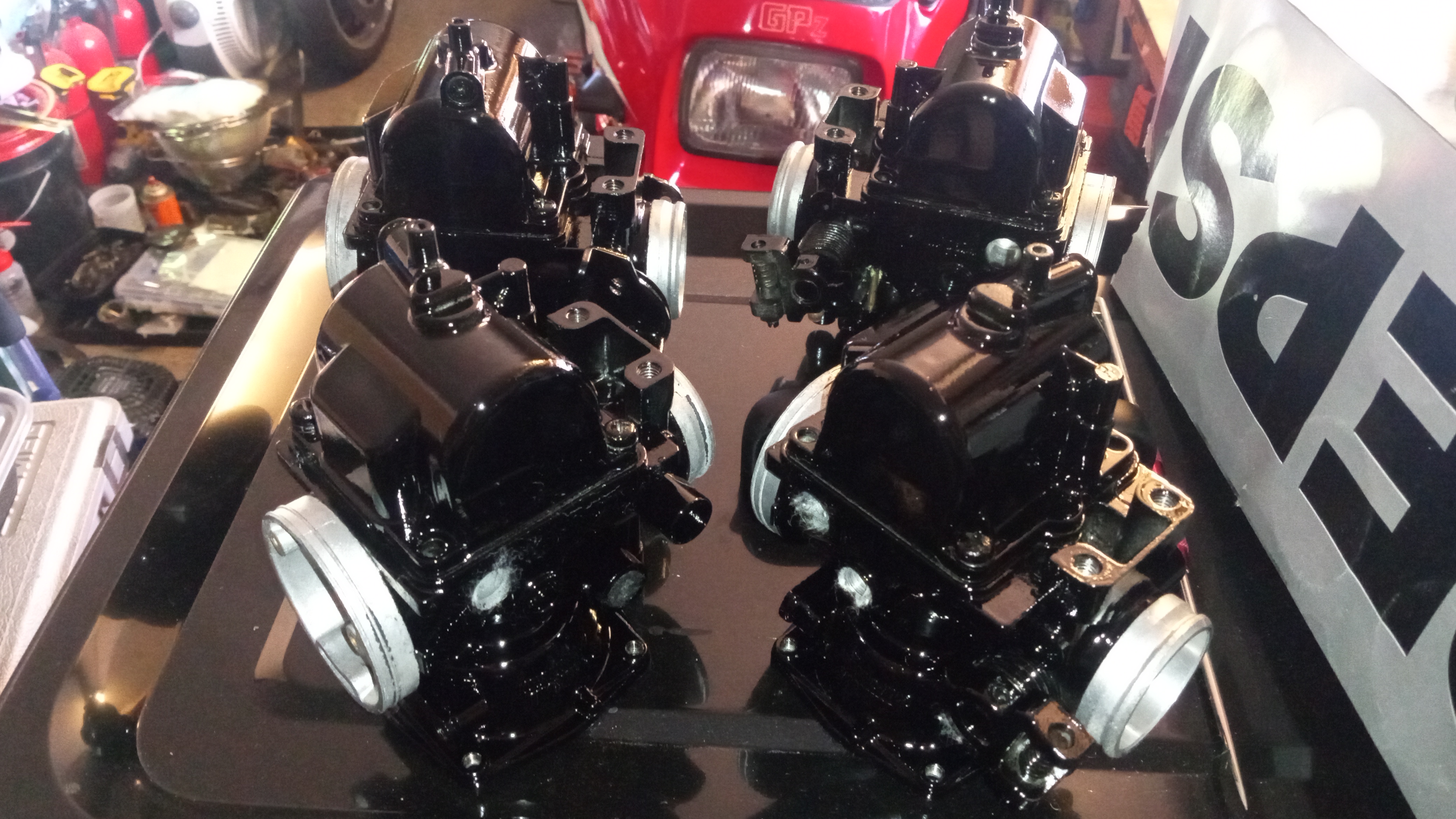

Threw some paint on the carbs & the two rails they all mount to....did it outside in 101deg sunshine :)

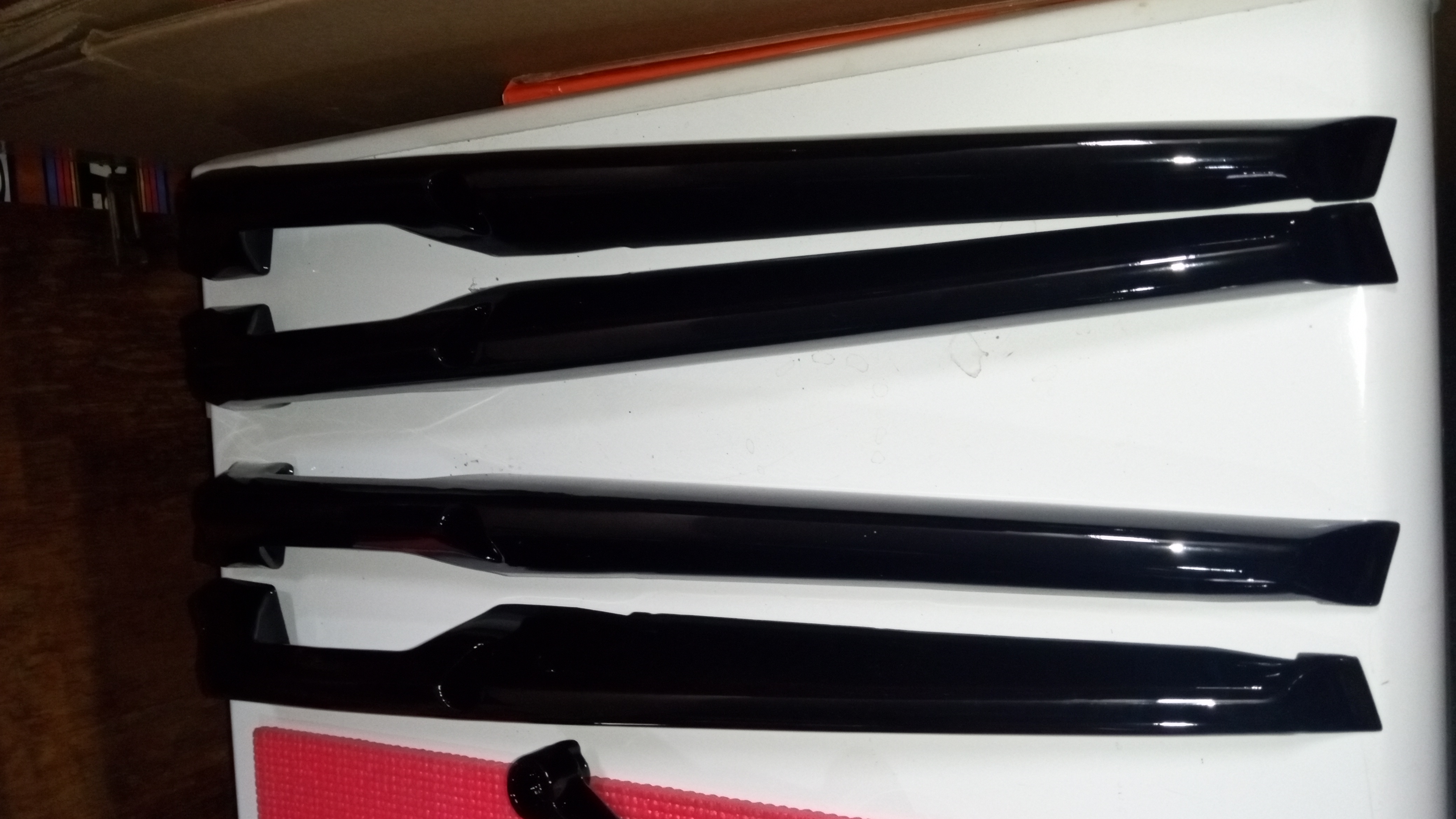

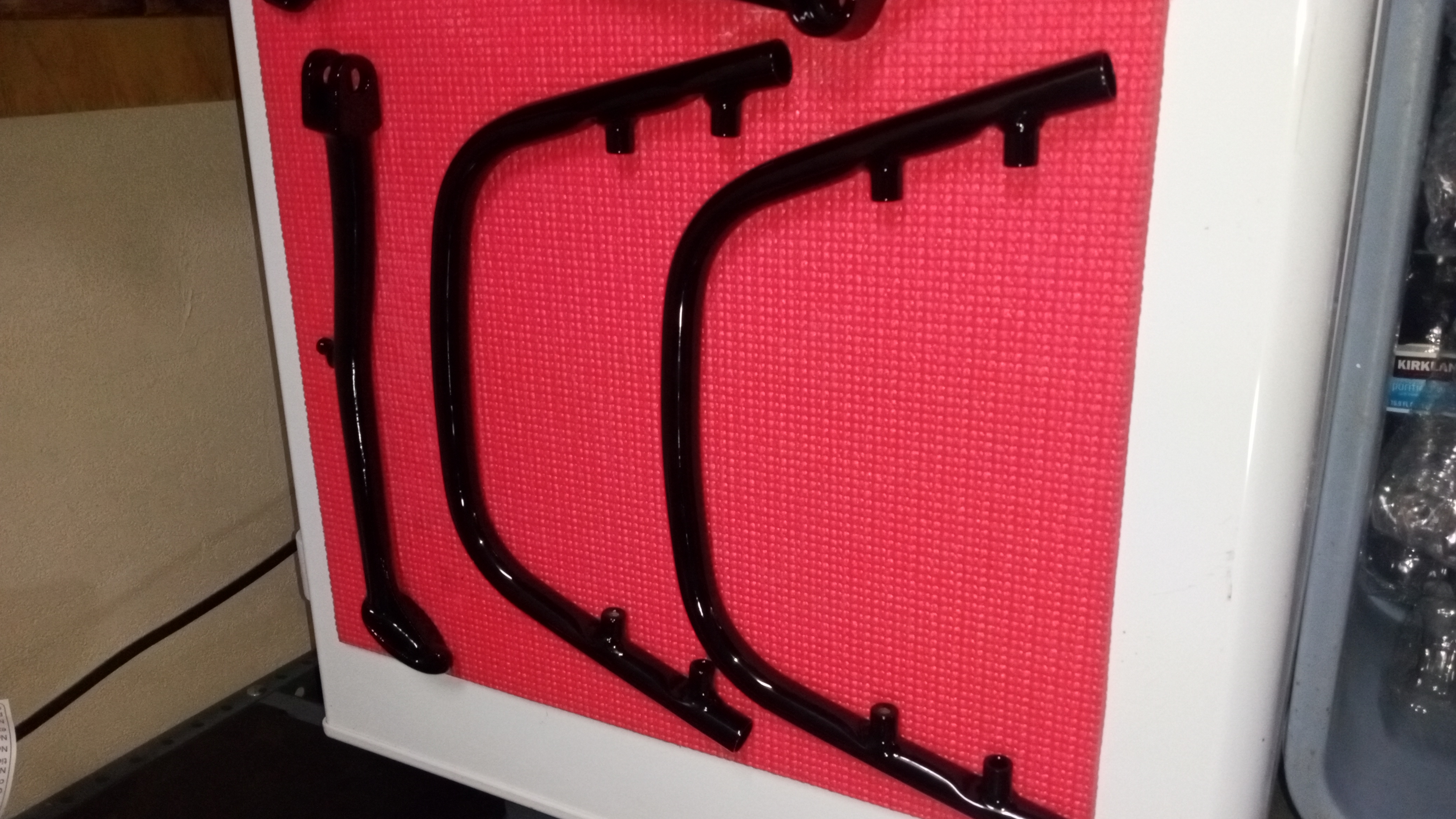

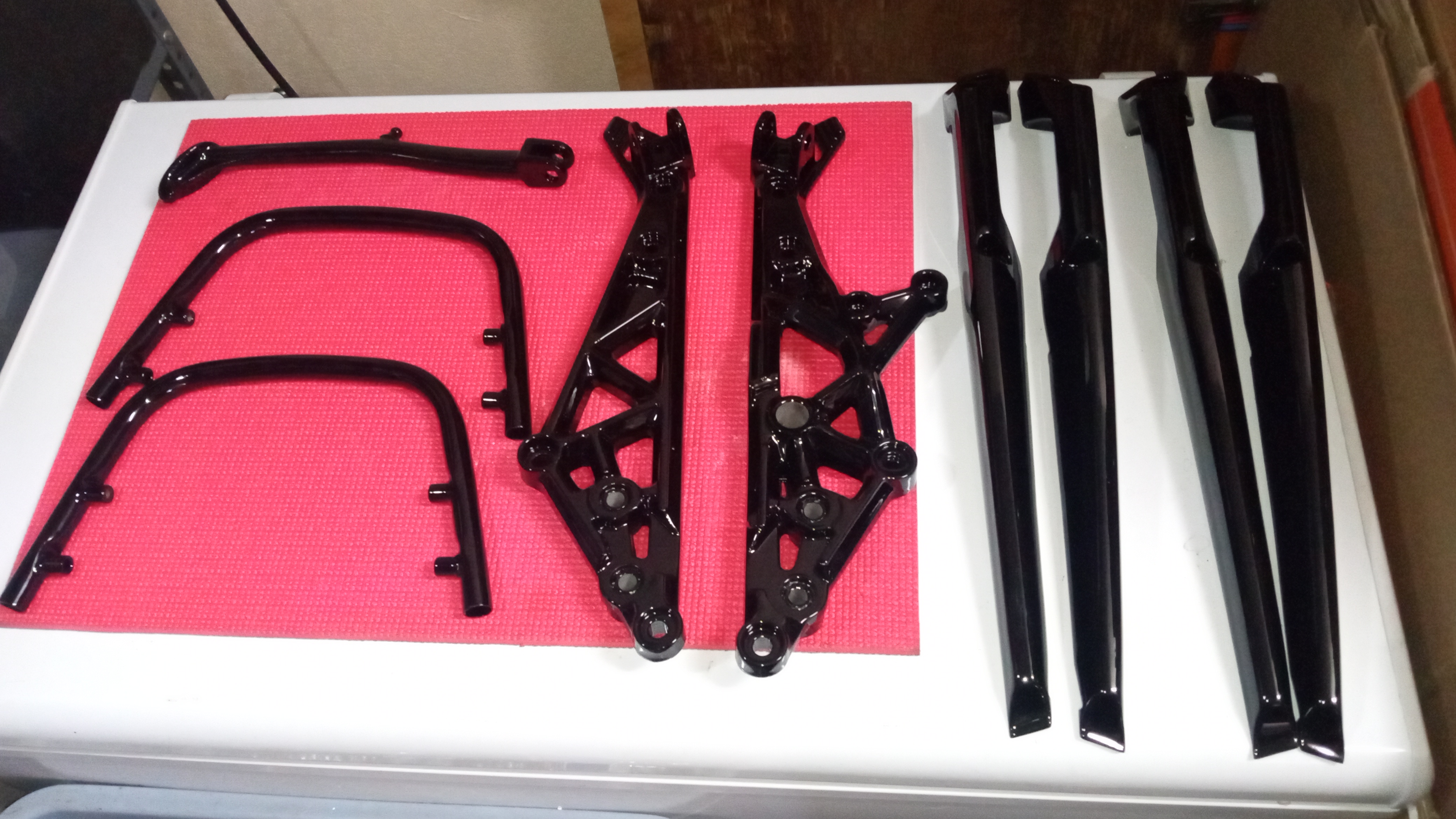

Powder coated doodads will be ready for pick up at 3pm Friday.

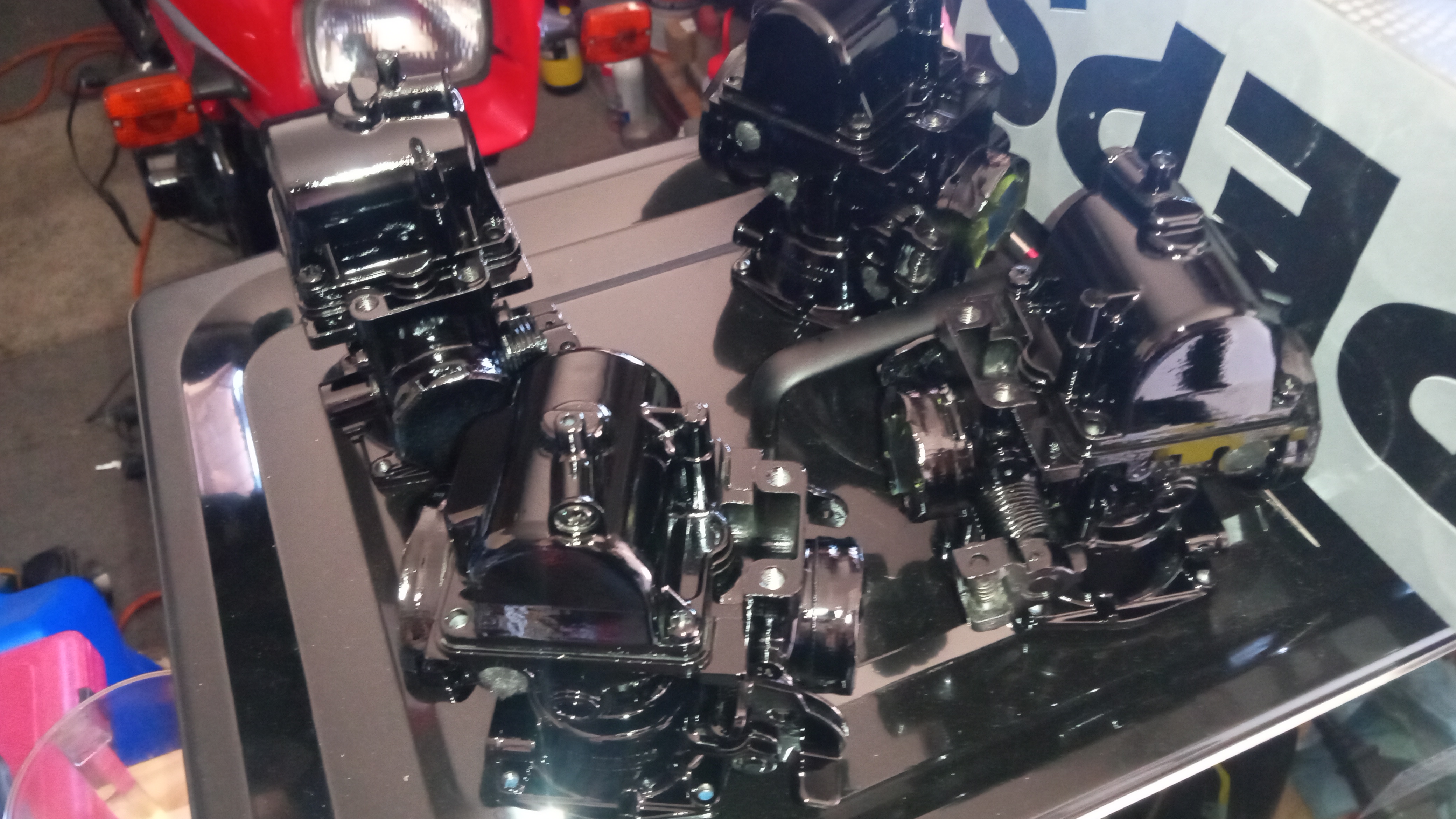

Unmasked... just need to remove what's left of the cotton wool I stuffed in various holes...

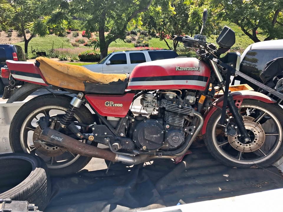

A_morti wrote: Thu Jun 11, 2026 10:42 pm From the first posts I thought this one was past (worth) saving, but you're certainly turning it around and quick
I could have bought a decent runner that needed nothing, but I'd rather bring this one back. Altho with that said, if this '81 GPz11 had shown up first on FBMP I'd have bought it instead... which I may still buy as well :shhh:

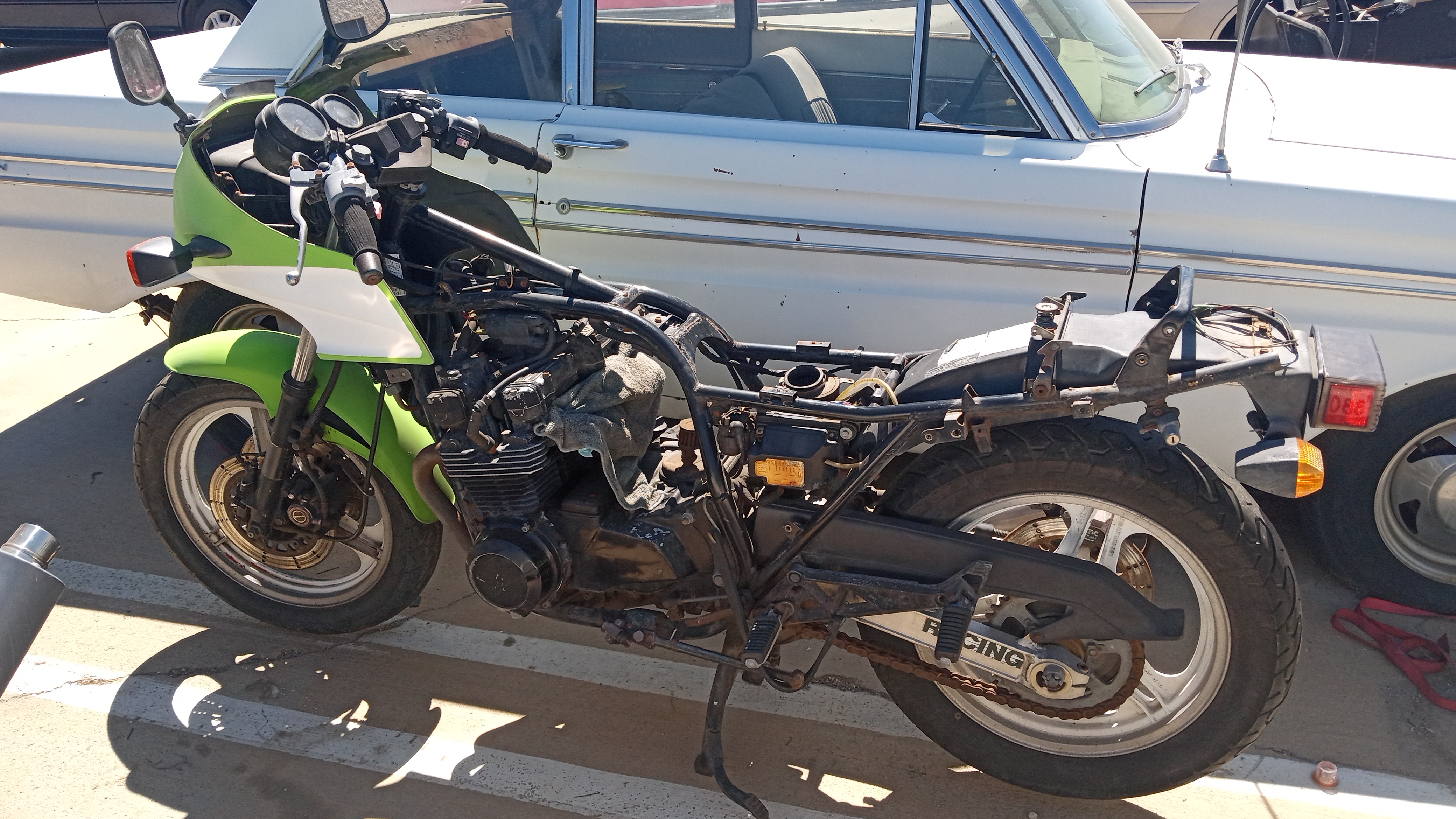

Bike looking somewhat forlorn...

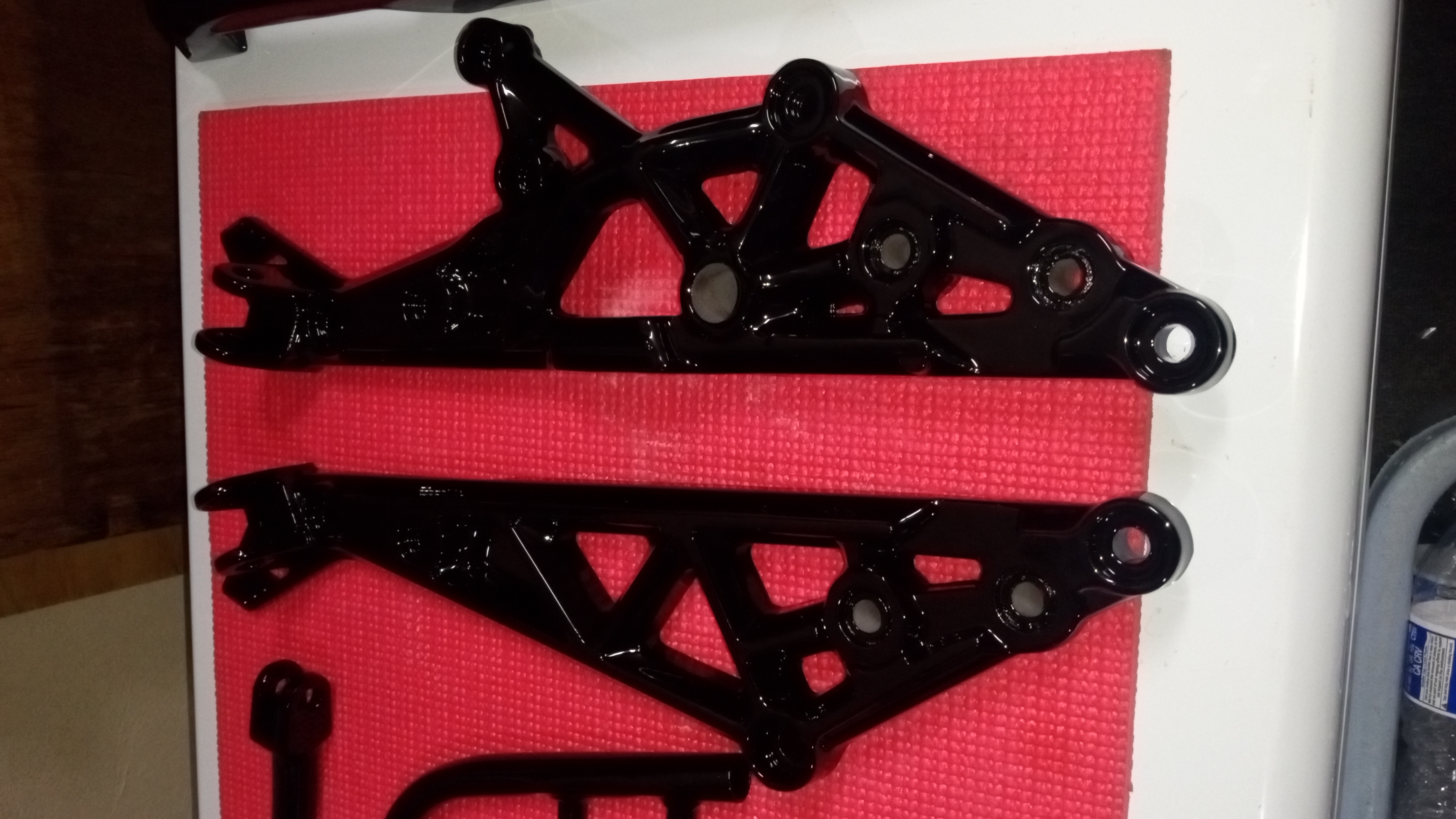

Powder coat doodads looking spiffy :banana-wrench:
I ended up with an extra grab rail that came with the tail & other set of rails I bought, so that went in the pile for p/c.
