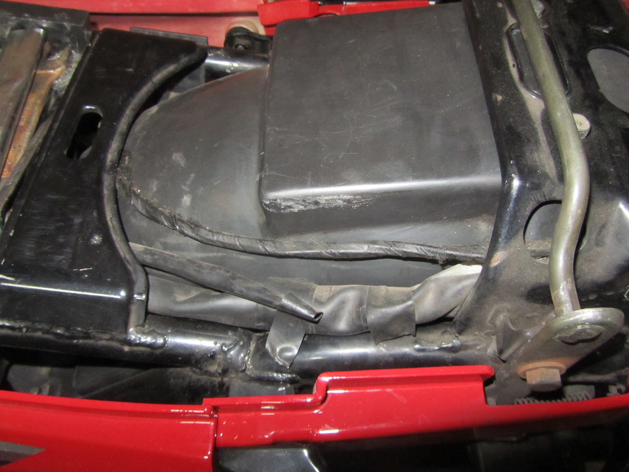

Found out there is a resistor between the heat sensor in the head and the computer, it's hidden in the loom under the seat.
Found that, opened up that odd part of the loom as it dead ends (it's next to the main loom)
Wire in that bit doubles back on itself... (pic from another Gpz11)
Metered everything & it all checks out... today... Yesterday it didn't (between the sensor & the brain). Bike hasn't moved. So at this point I guess I'm living with it.. unless I touched/moved something & ended the issue (which seems to be about 95% of the electrical issues I *fix*). Next ride will tell. It doesn't affect the way the bike runs when the idiot lights come on.

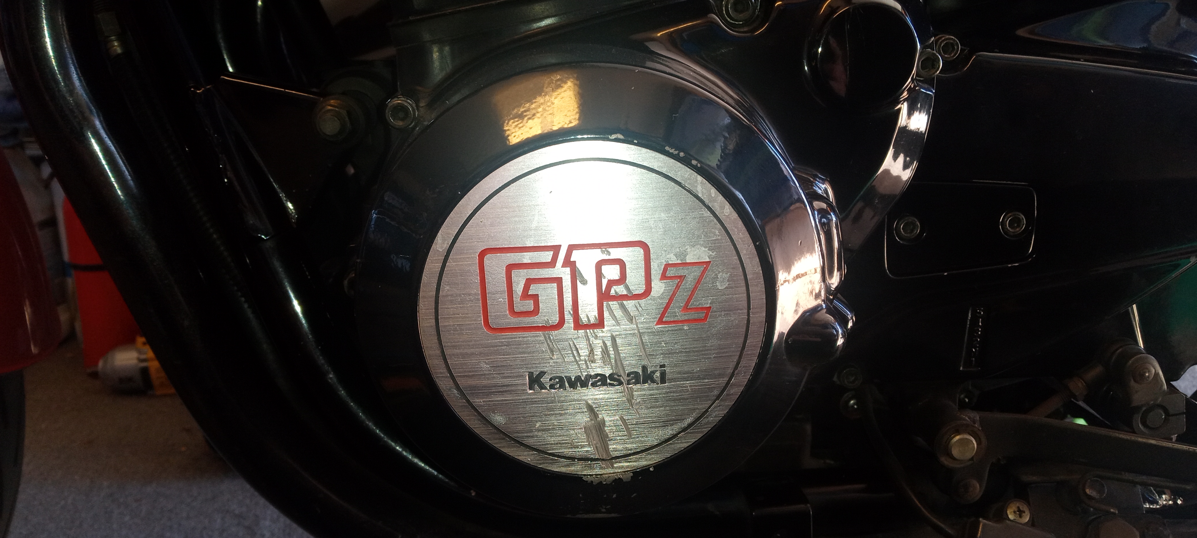

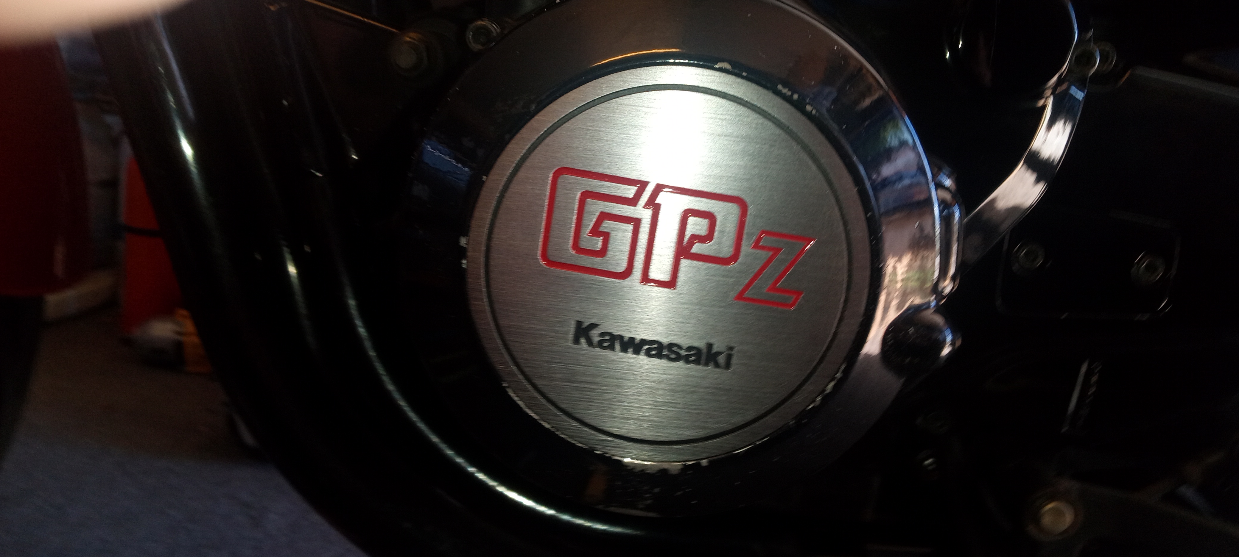

Supermofo wrote: Fri Jan 30, 2026 11:56 am Engine case sticker?
Yup, left side. Same as the GPz750 Turbo. At some point the bike has fallen over to the left & scratched up the original. Old one will likely become a coaster depending on how easy it comes off.
It's not actually a sticker as it's 1mm aluminum, pre-curved to fit the alternator cover.

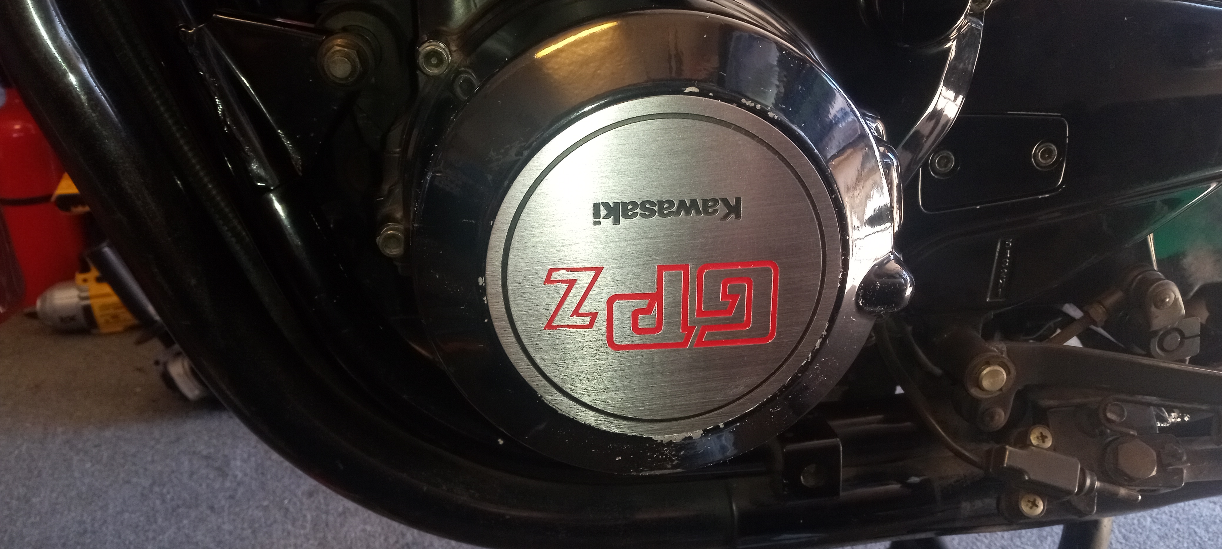

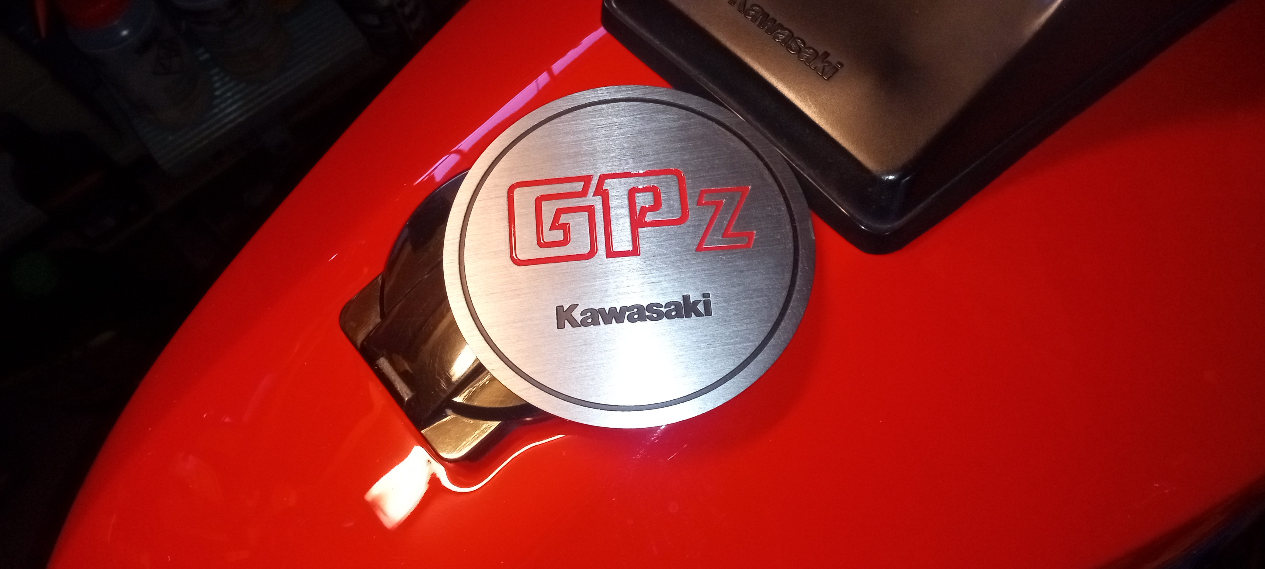

Removed mullared engine badge...
Discovered I bought the Aussie version....Bugger.
Oh wait...
Notice on the original that the brushed finished matches the angle of the logo... on the new one not so much.
& yes it's on straight, camera was at an angle is all.
