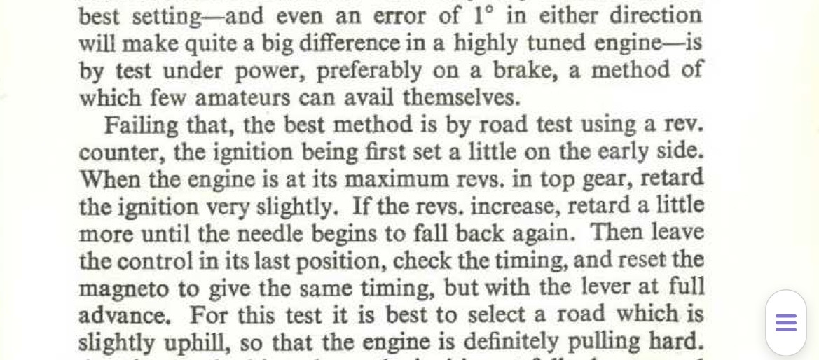

I suppose at this stage you don’t know if the main jet and needle height are right.
Is the ignition timing kind of open to debate? If it’s right, retarding it slightly while the engine is pulling hard won’t have a significant effect.
Retarded inlet valve timing has a bad effect on low-mid rpm pull.
I suppose that silencer is not restrictive.

JackyJoll wrote: Sun Jul 26, 2026 9:51 am Gutless?
Exactly, it's running ok, but in haven't played with anything yet. It tends to tick over very quickly.
JackyJoll wrote: Sun Jul 26, 2026 9:51 am Is the ignition timing kind of open to debate? If it’s right, retarding it slightly while the engine is pulling hard won’t have a significant effect.
I have multiple sources for the ignition setting, most of them disagree... :lol:
But my Mag has automatic advance retard, so messing with the timing is a bit more involved.
