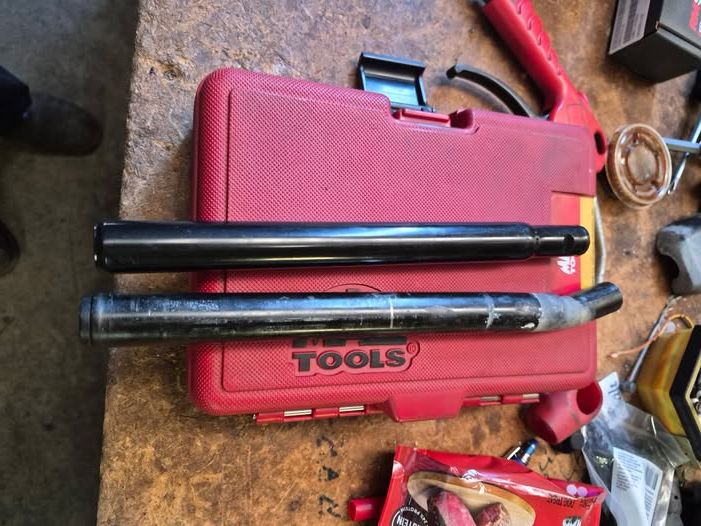

Mech mate texted me saying the handlebar I got is the wrong one... it's the right part #...

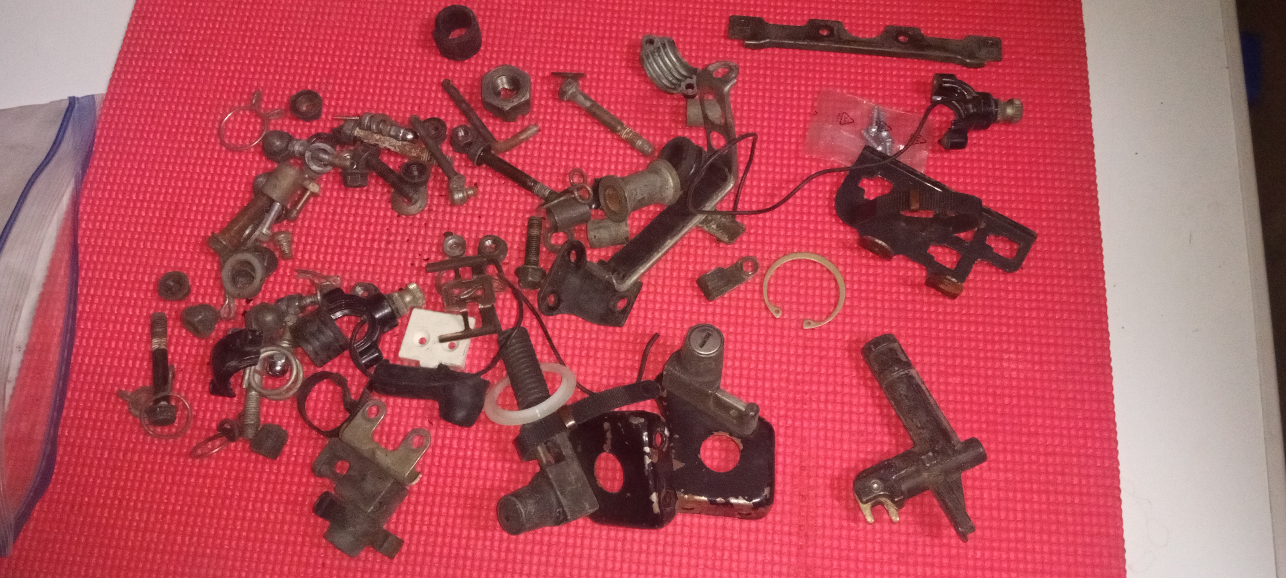

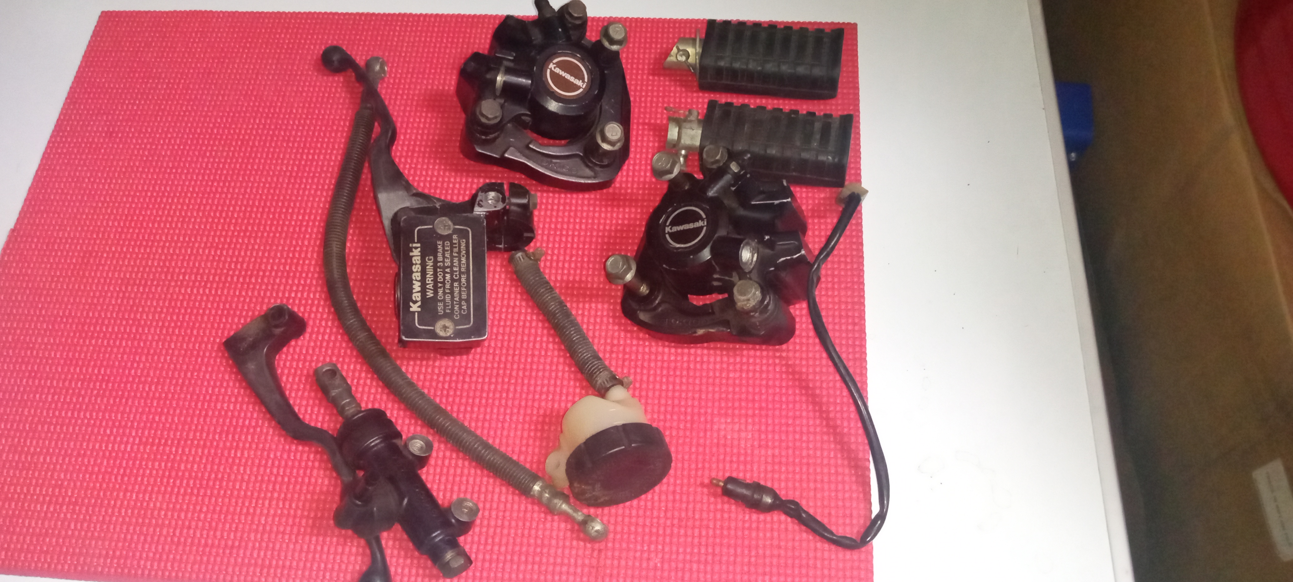

Box of GPz750 gubbins arrived after it was bought two weeks ago, First there were issues paying the seller, then I got ghosted after he got the $$. Thought I'd been scammed out of $65.
Well worth the wait as the parts pile had a front m/c which I really need, plus I spotted a flasher relay in the pile that I need for the GPz11.
Box also contained some foot pegs, a pair of PERFECT front brake calipers, front brake & clutch levers, complete rear m/c (which saves me overhauling the other two I have) & a bunch more really useful stuff including helmet/seat locks, engine mounts etm.
Well chuffed!!!

Just looked through all the stuff, there are even some Z1 parts in there :)
