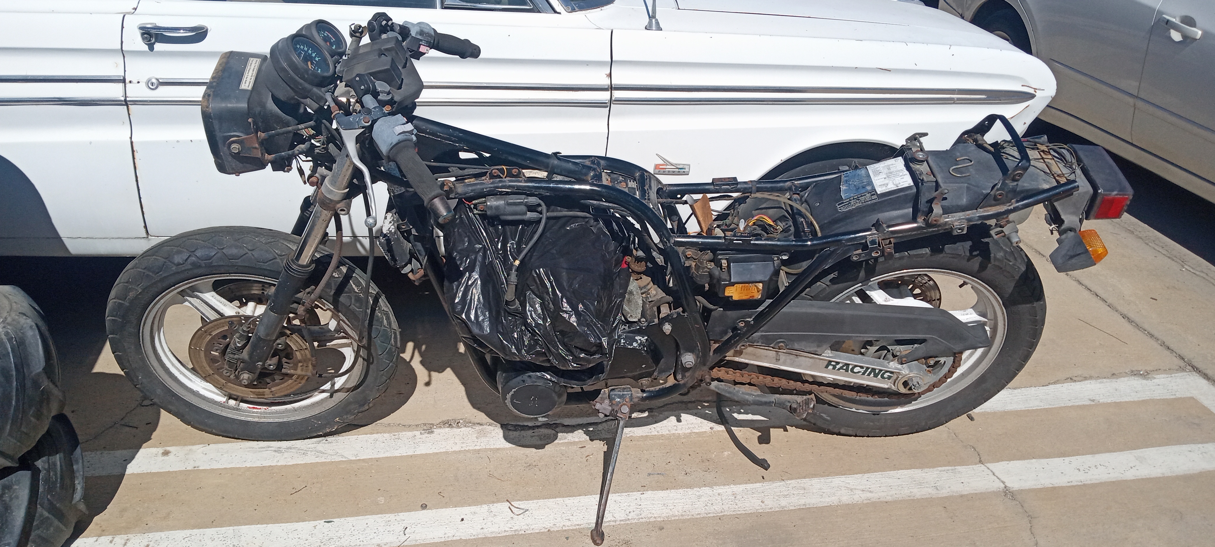

BIG development today!! The bike is on the kickstand!!

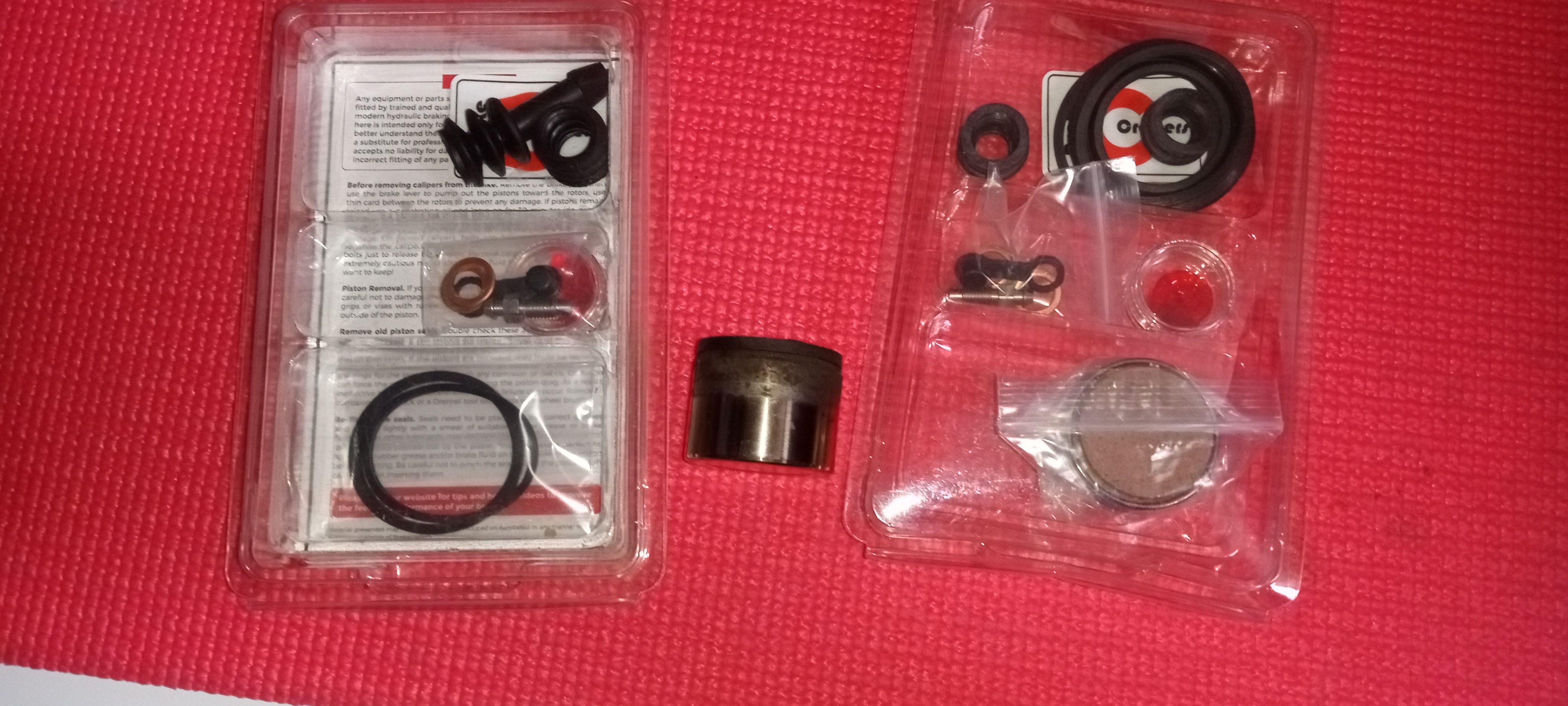

Arsebiscuits & buggery bollocks...

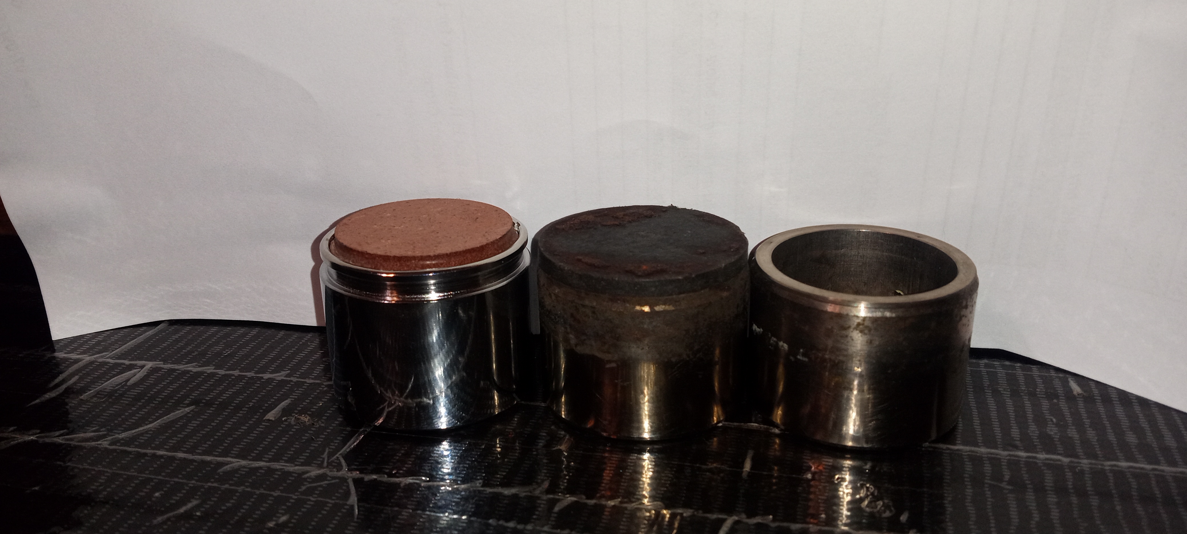

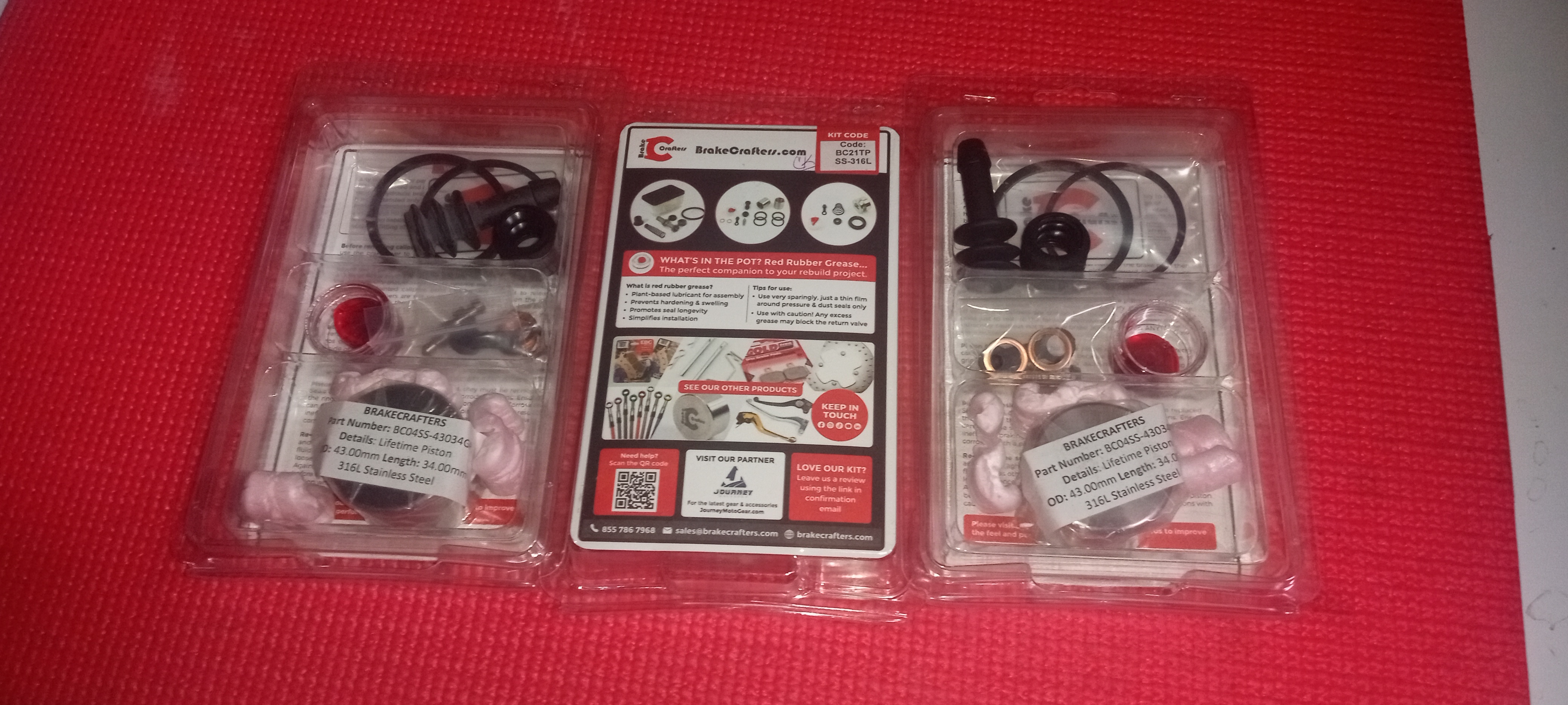

On the left is the caliper kits I ordered without the pistons, then realized I needed the pistons too.. so ordered the kits with the pistons. What showed up today are the kits on the right.
Original pistons don't use that big fat dust seal & have no groove. New pistons have a big groove for that dust seal.
Old pistons WITH the isolators are the same height as the new pistons WITHOUT the isolators, With the isolators they're 3mm taller.
& the other rubber gubbins is obviously different.
New piston on left, old piston with isolator in the middle & without it on the right... Isolators aren't removable on new or old pistons, two of the old pistons had isolators that were buggered & fell out in pieces.

Brakecrafters were great to deal with, They've already sent the correct kits & sent a doodad to print out to ship the wrong kits back. Will be dropping them off at FedEx today.

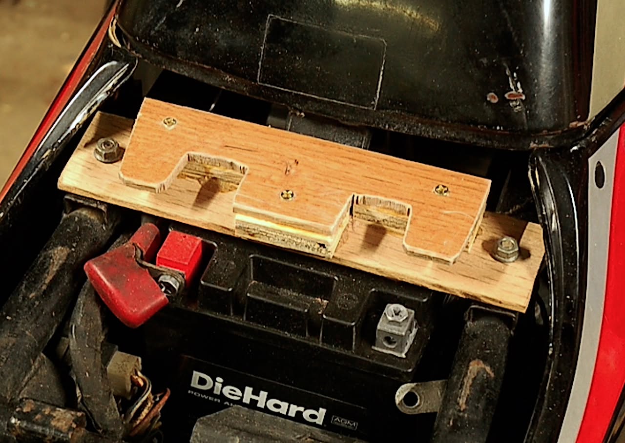

I have abandoned my Luddite ways & signed up with PP. This was to facilitate buying parts without the ballache of not owing a checkbook.
First buy was a box of stuff from a guy here in Ca that had all sorts of gubbins I require for the GPz750 (especially the front master cylinder), but I also spotted some bits I can use for the GPz11 (indicator relays).
Second buy was an exact replica of the bracket that secures the battery, the front of the seat & the back of the gastank. This part:
tank bracket.jpg (104.42 KiB) Viewed 255 times
I decided not to ask the self-professed *carpenter* to make me one like he made for his own bike... Thank fuck we weren't relying on this guy to build the Ark..

Re: '83 GPz750-A1 malarkey.
ZRX61 wrote: Sun Jul 12, 2026 3:39 am I have abandoned my Luddite ways & signed up with PP. This was to facilitate buying parts without the ballache of not owing a checkbook.
That's a scary thing to see.

New brake kits showed up.
Posts: 9033
Has thanked: 2285 times
Been thanked: 2672 times
and they don't have the pucks/isolators...
Original piston without puck: 30.62mm
Original with puck: 34.75mm
New, without puck: 31.67mm

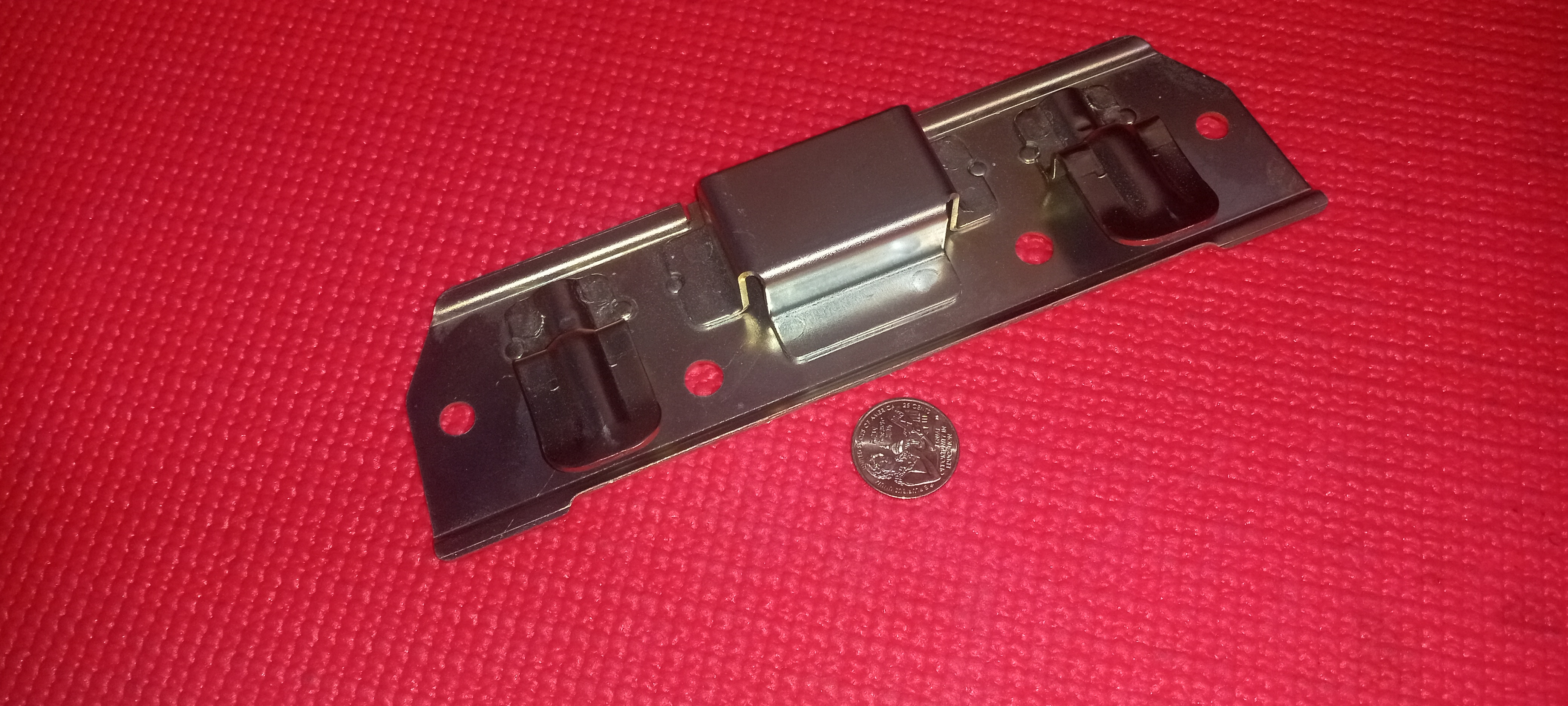

Replica bracket arrived...

ZRX61 wrote: Thu Jul 16, 2026 12:52 am and they don't have the pucks/isolators...
Will that still work, or is there a risk the pistons could pop out when the pads get low?
