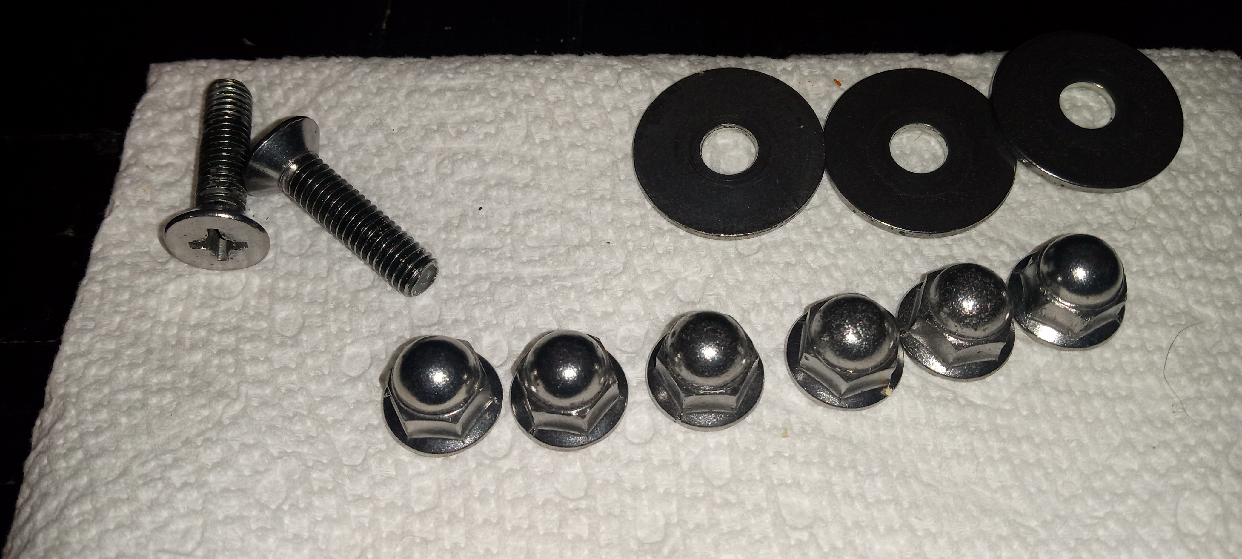

Today's malarky... Rusty fairing hardware spent a night in the Evaporust. I'm missing two of the dome nuts, two of the countersunk screws & one of the washers.
Dome nuts will likely get replaced by 10mm Nylocs anyway (there's a bunch of dome nuts on both GPz's)
The two screws are from the mirror mounts & I may have spares.. I've got a few spare mirrors for parts
& the 4th washer was here.... until I dropped it in the garage last night causing it to teleport to another dimension... bugger.

Fairing gubbins after a session in the tumbler...
