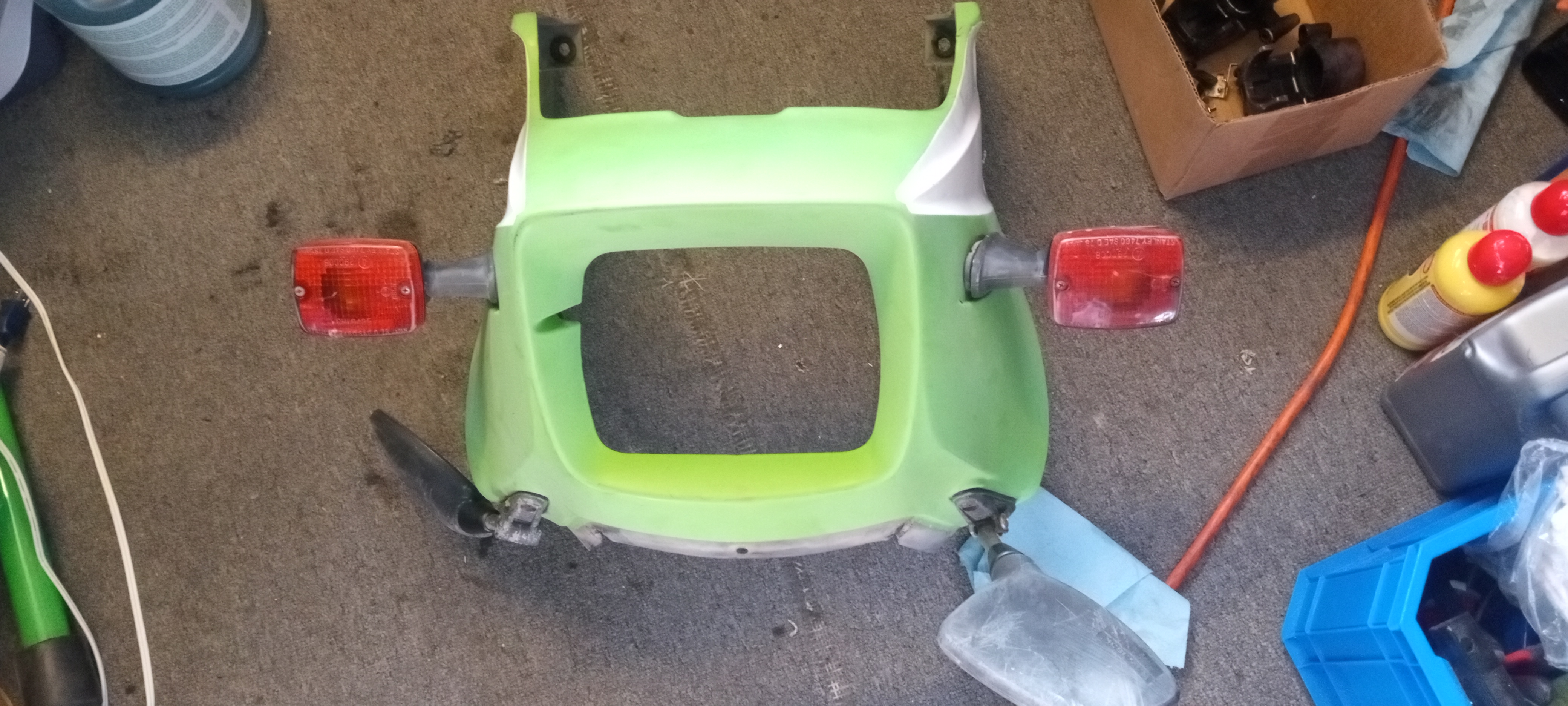

Put the gas tank & front fender in the bed of the truck, removed fairing from bed of truck (lack of work/storage space). Now I can start working on the fairing. First off will be take it all apart & then there will be lots of plastic welding, followed by the same sanding/buffing the tank, tail & fender got.

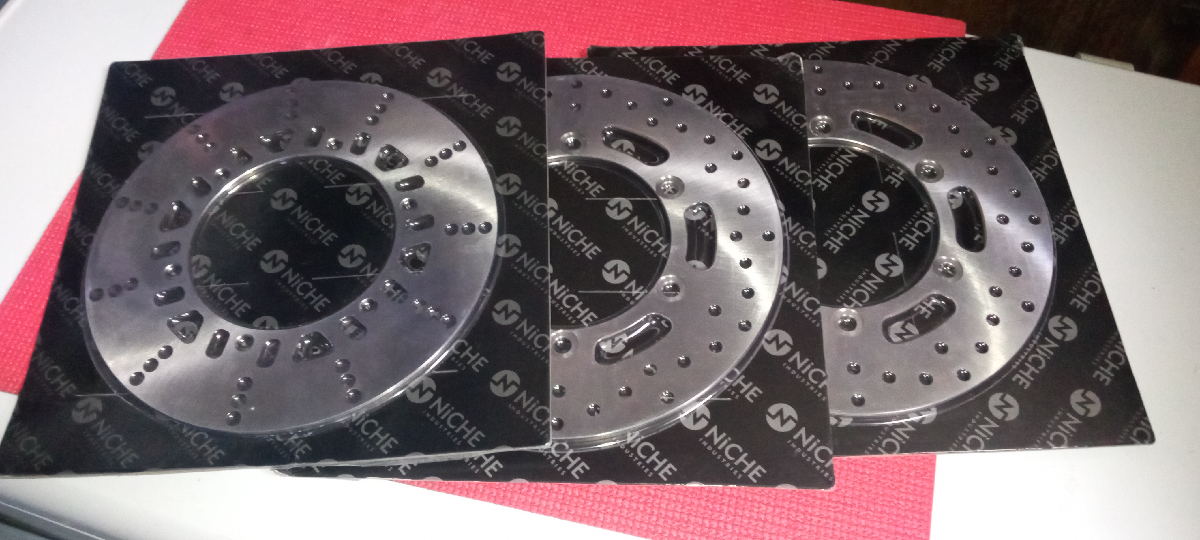

WooT! Other two rotors showed up

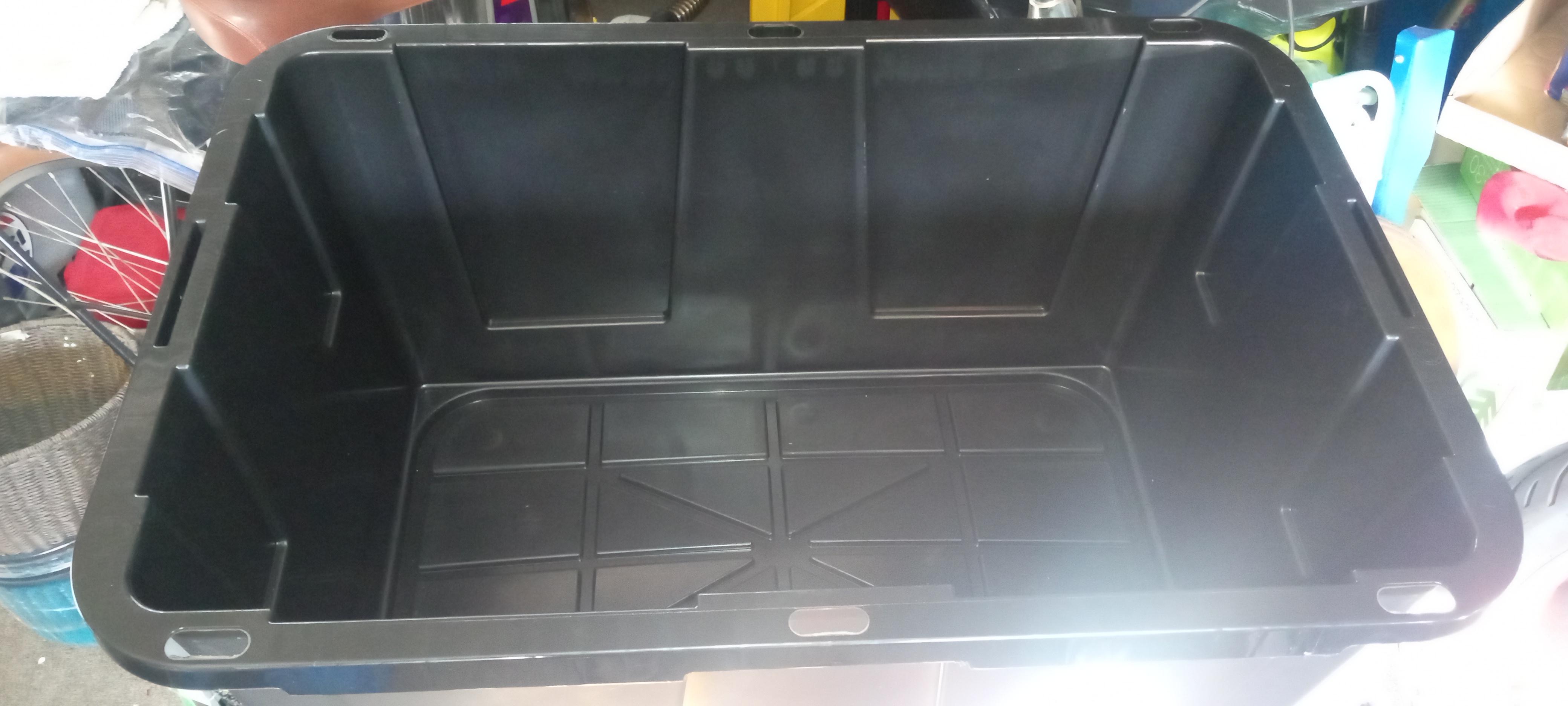

BIG tote for the gas tank. $6.99 at Costco. Not going to fill it with stuff to remove the rust in the tank, this is to salvage whatever I use in case it leaks out.

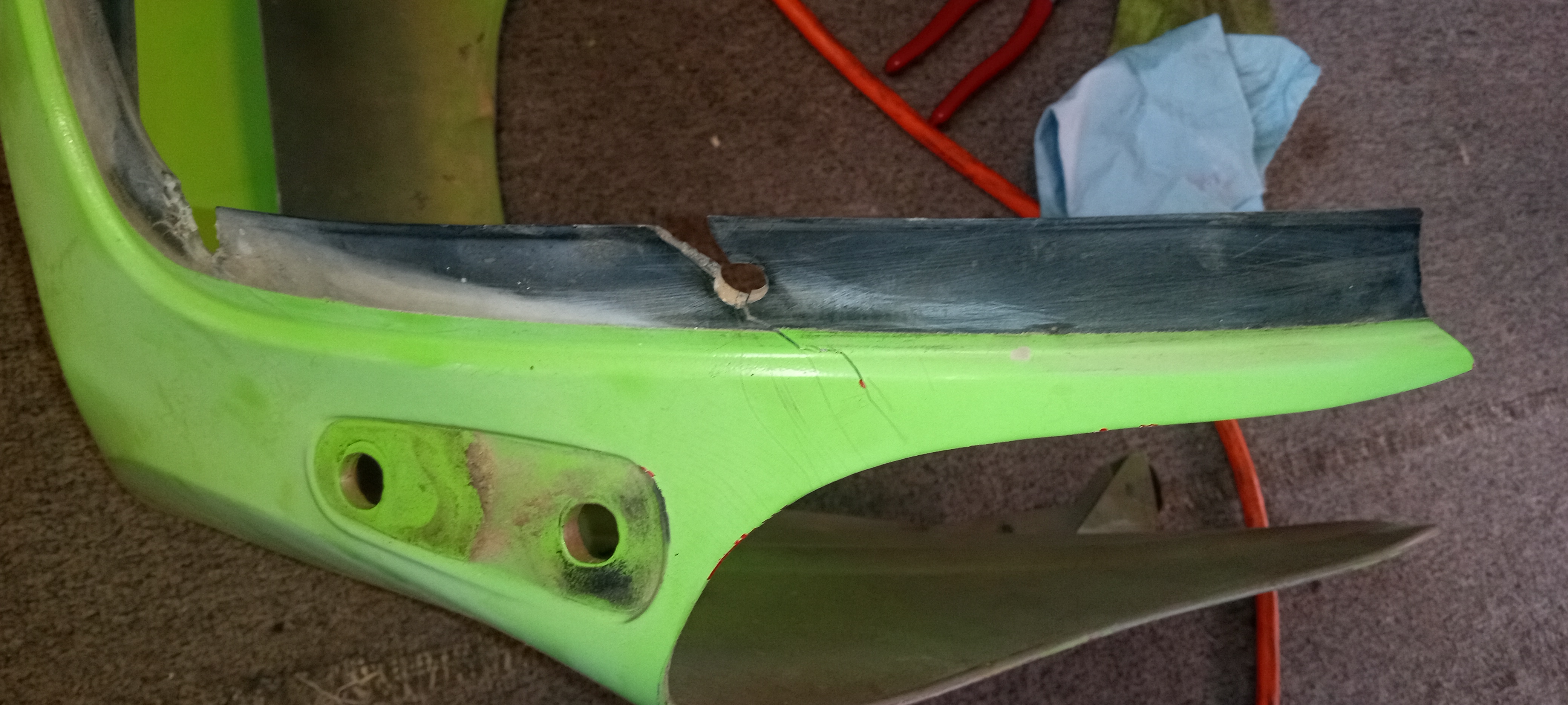

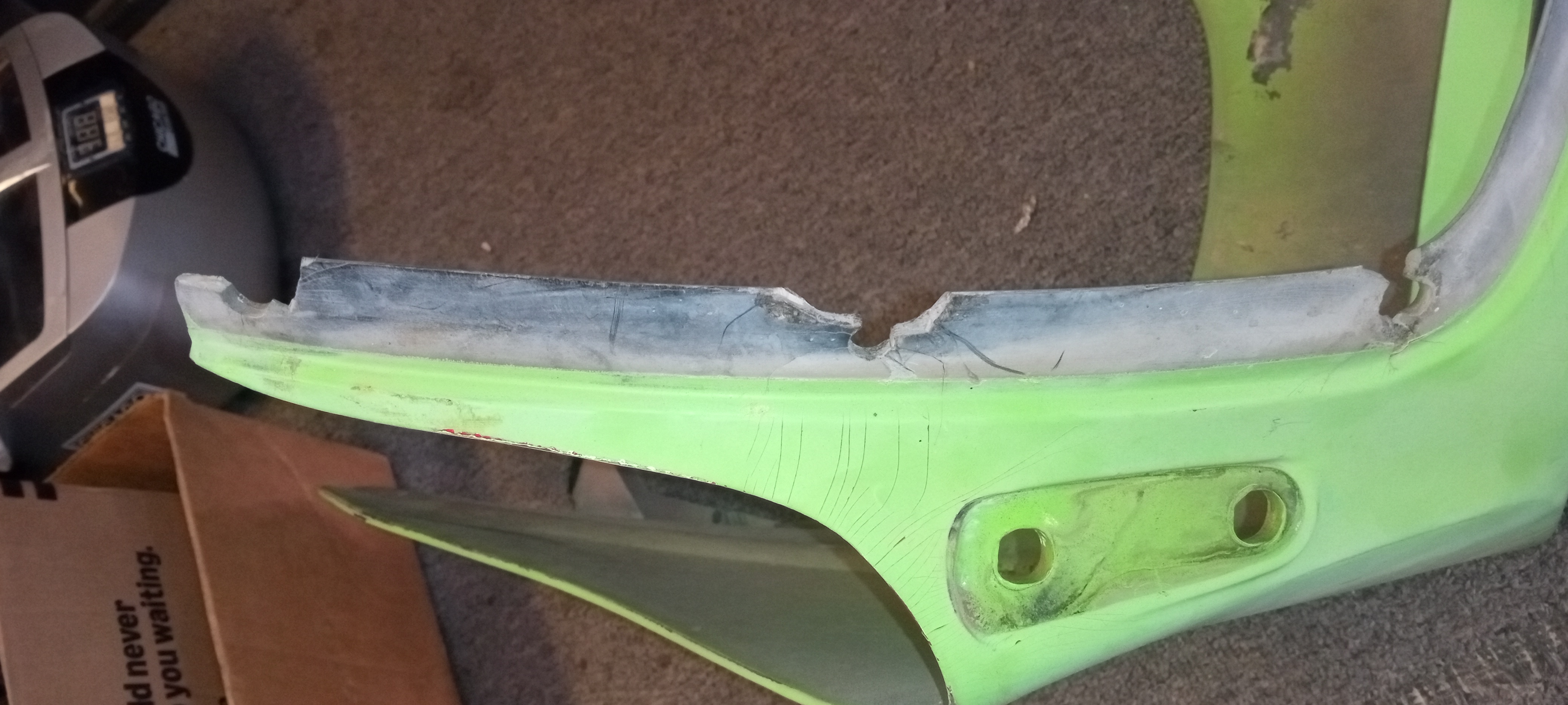

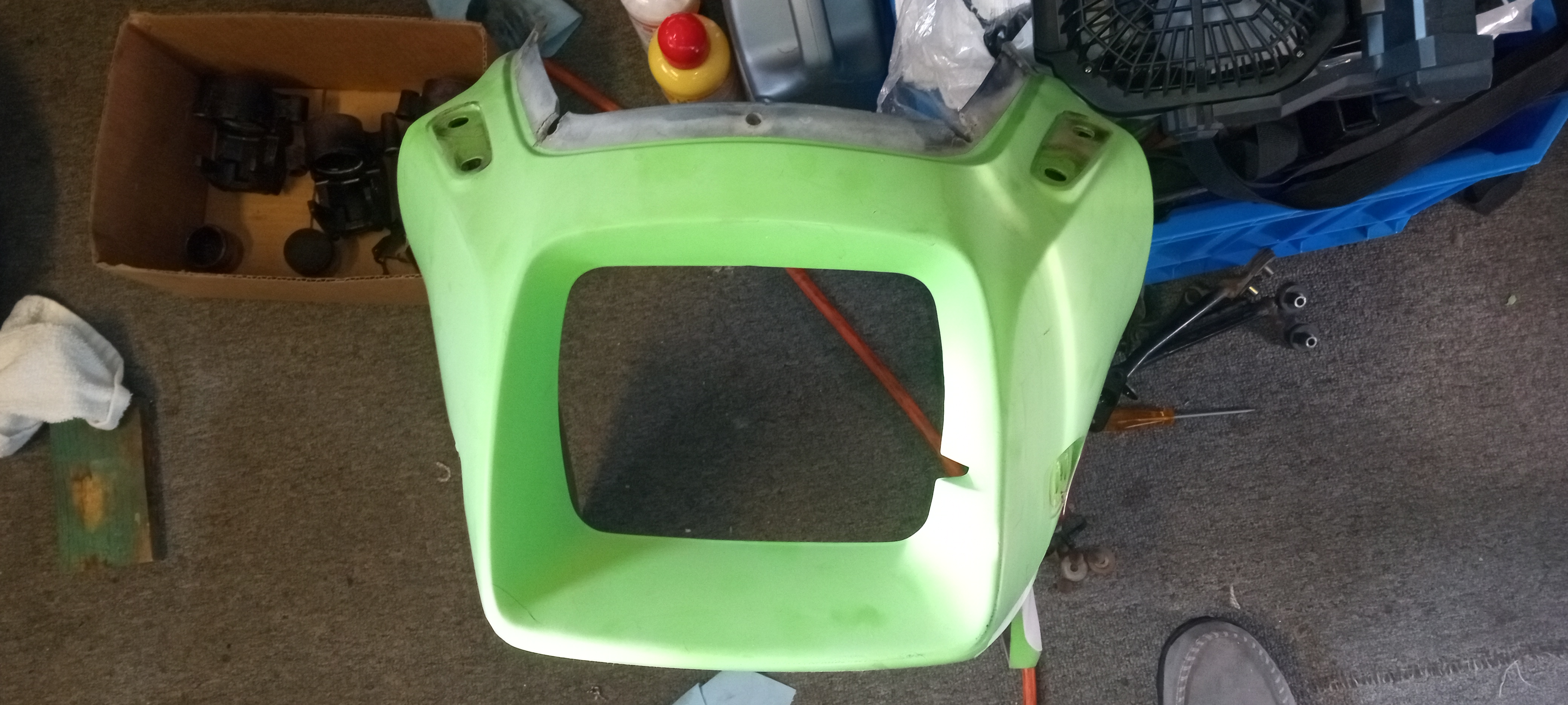

Fairing dismantled, hardware is in the Evaporust until tomorrow. Then after derusting it will go in the tumbler.
This is the damage I'm dealing with where the screen mounts...

Gonna try the baking powder/superglue method to start
