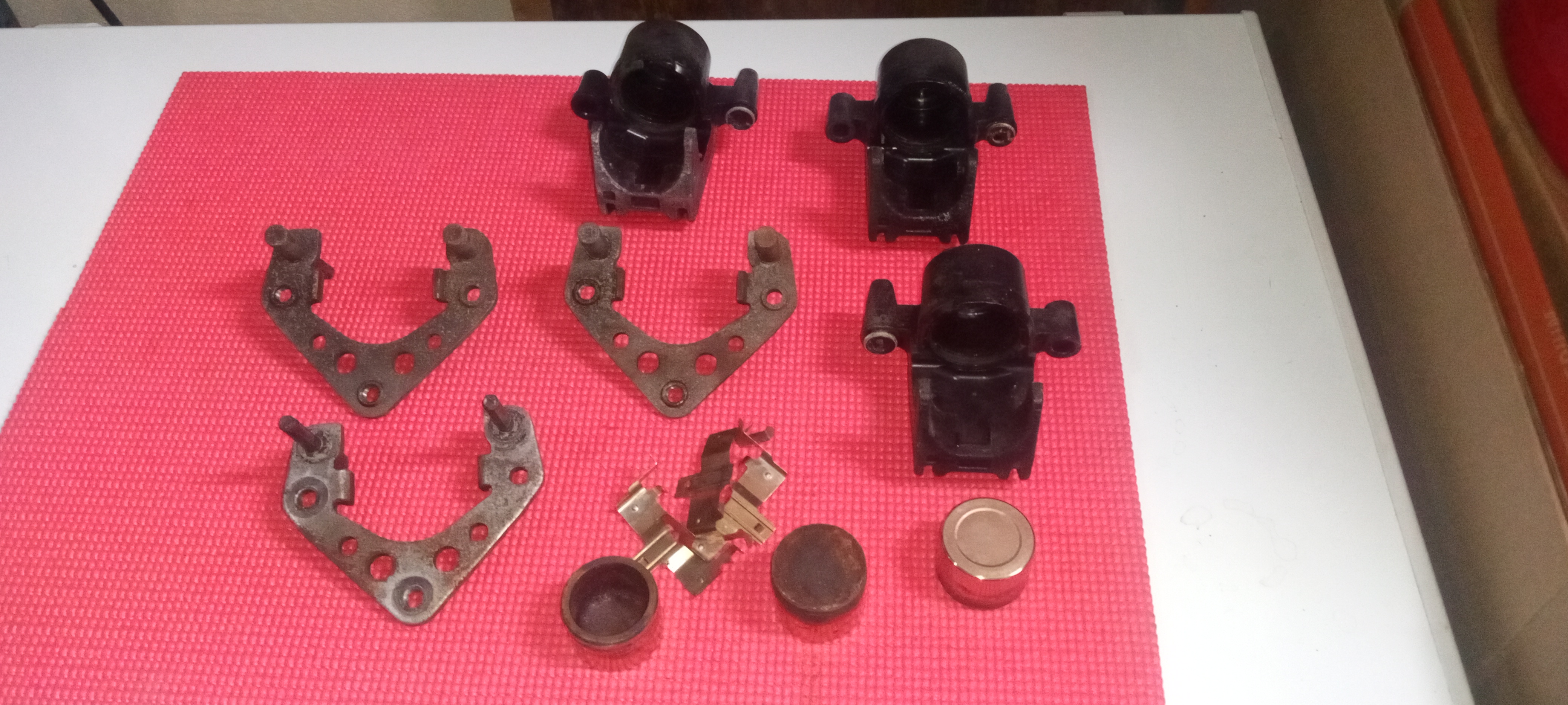

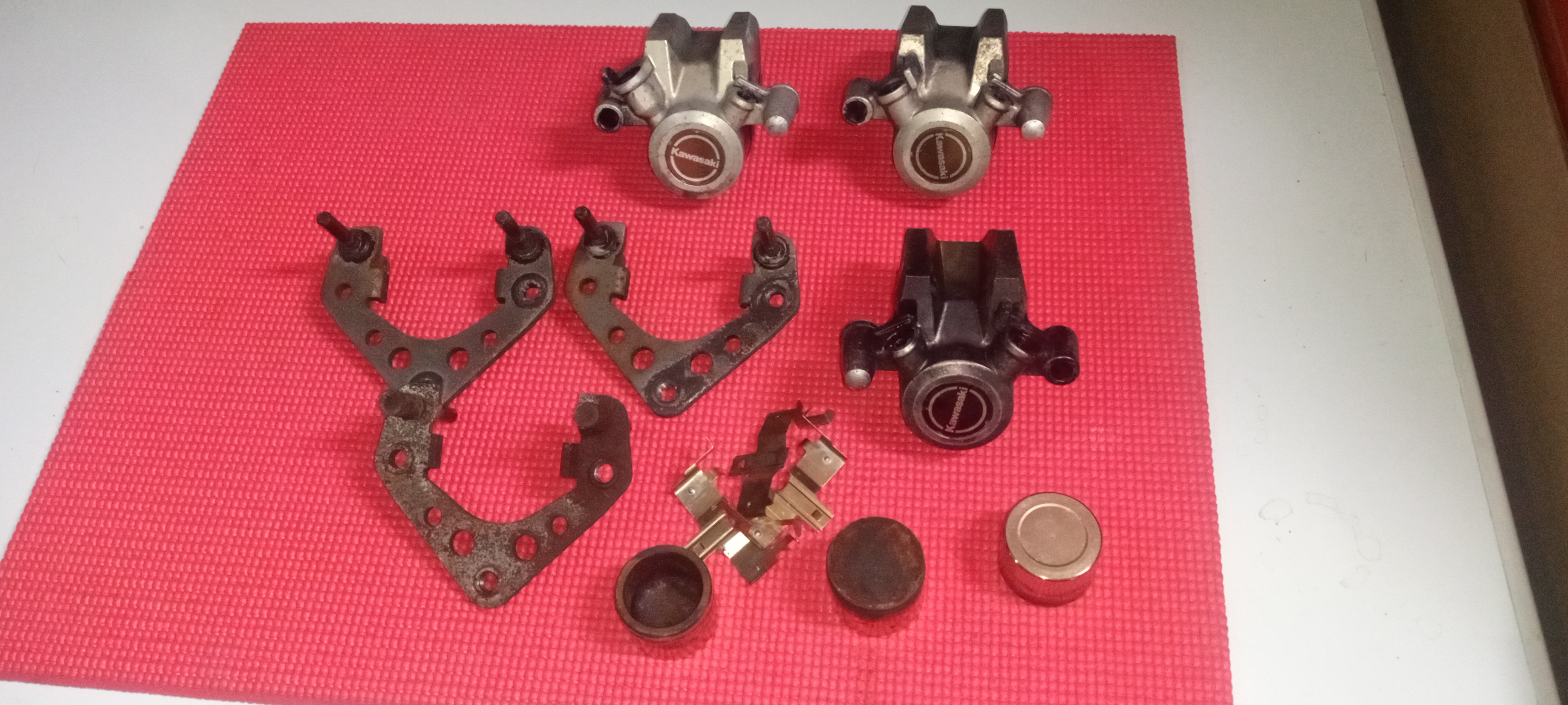

Dismantled three brake calipers (fronts & the rear are the same). Had previously ordered rebuild kits without the pistons.. however, I need the pistons...
Bugger.
Gonna order three new kits WITH the pistons (FFS).. & I guess I now own 3 rebuild kits for the '83 GPz11 which has the same brake calipers etc.

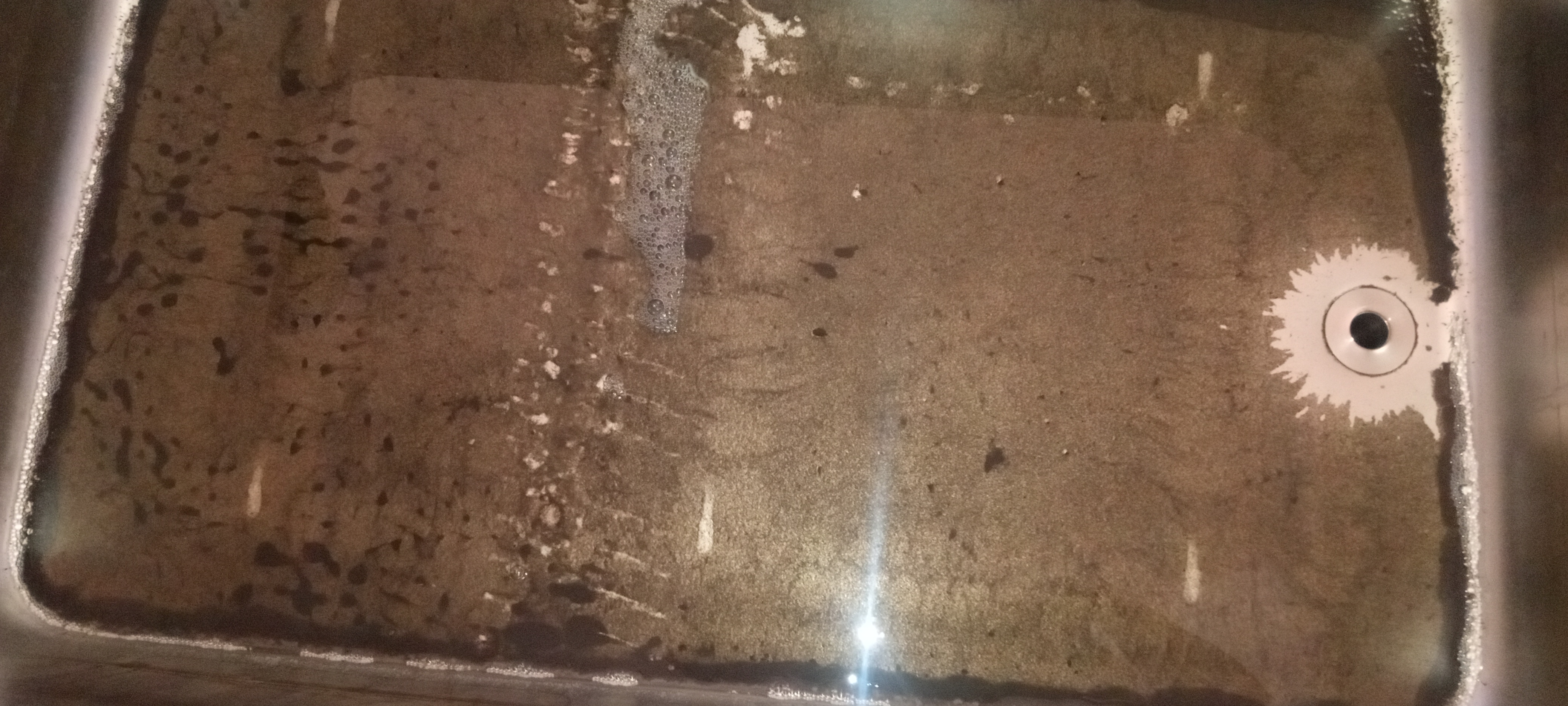

Calipers, mounts & other gubbins had three 30 min sessions in the ultrasonic. Calipers were originally anodized, but that's all faded to shit on the exposed surfaces (which is why the rear caliper is still dark). May paint them, or install as is...undecided.
bluergh... Can't understand why people reuse the same solution in ultrasonics for weeks, all that snarge on the bottom decreases the efficiency of the machine.. but they save maybe 10c on detergent, the cheap fucks.
