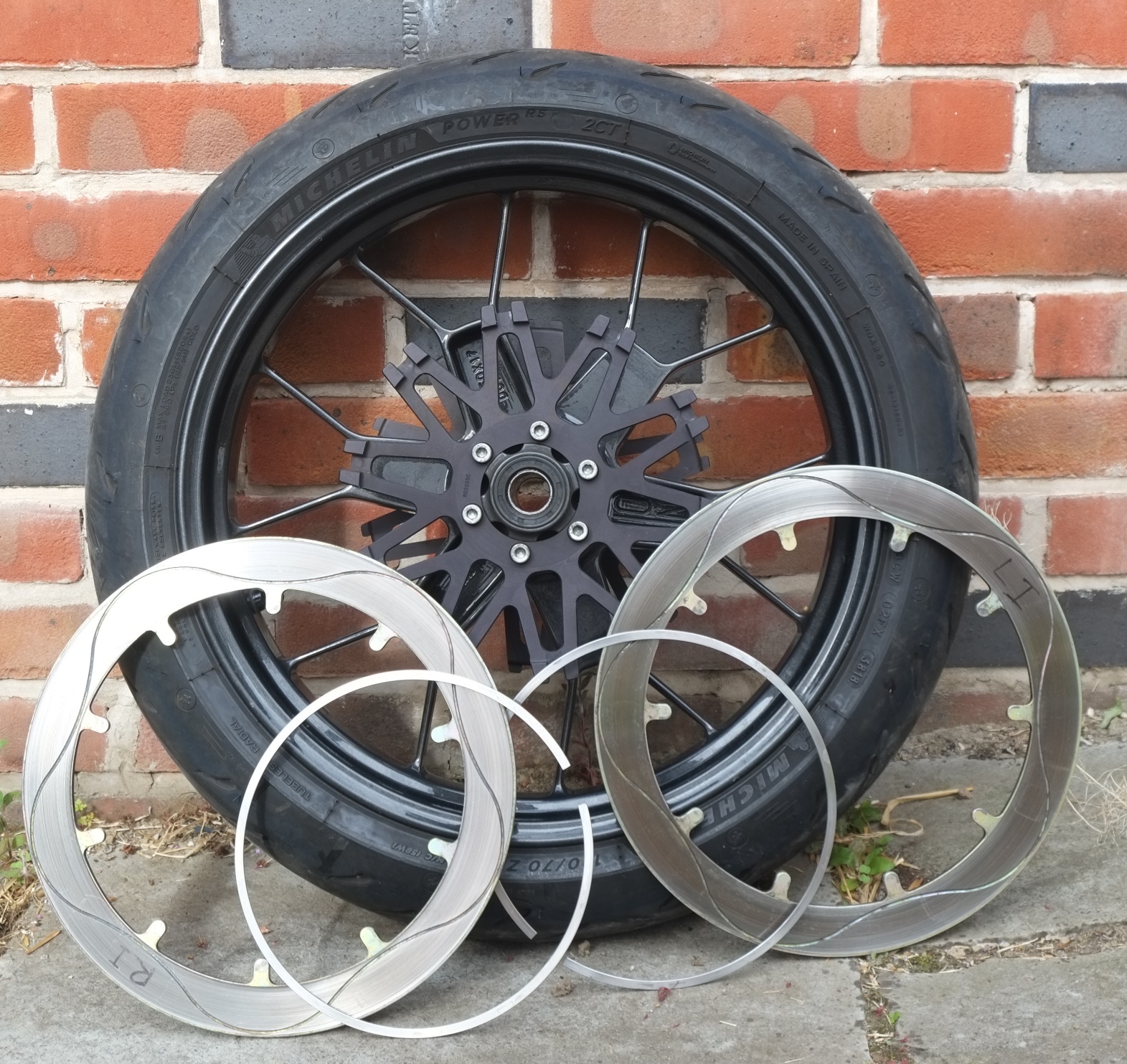

It's been a couple of months and in that time I've been to France, had the van's clutch go pop on me in fairly drastic fashion, had it repaired at painful expense, and drove it back to the UK. And recovered from said journey (it takes longer every year).
Now I'm back in the land of the semi-sentient I thought it would be a good idea to get the Falco MoT'd. The Duke is in France, the LC is in Stafford and with the sale of the VFR I haven't got a bike to ride in Sheffield. First problem was that my MoT station of choice didn't seem to be responding to phone calls, emails or Facebook messages. This is more than a little annoying as they're a scooter emporium and so have no interest in failing an MoT to try and drum up work. They're also very nice guys. So while I investigated that further, I took the bike to the next nearest station, which happens to be an MoT only outfit.
Fairly typically, the trusty old Falco blotted its copybook and failed. Two out of the 3 failure points are easily rectified; no reflector at the back of the bike and the EU headlamp the bike came with needs to be 'corrected' with some black tape to stop it dazzling other road users (not that I ever ride at night).

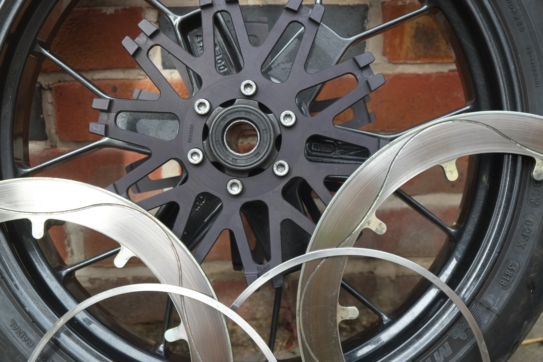

The third fail was a little more serious. Front Brake indicates excessive fluctuation of brake effort; i.e. excessive pulsing at the lever, probably caused by warped disc(s). This bothered me, as I've not noticed this when riding and replacement of front discs would not be cheap. So I decided to remove the discs from their carriers (not a difficult job with PFM ductile iron discs), strip them and give them a clean and a good coat of looking at. And on Monday I'll be taking the discs to a local engineering firm to verify whether or not they are actually warped.
Herewith the obligatory pictures:

They might find it easier if the discs were on the wheels as all they have to do is put the spindle through the bearings and lock it up
in a vice and use a Dial Indicator on the discs.

If you have a dial guage you could do it yourself.
Hell, all you really need is a good vice and a straight edge.

Thanks for the comments. I do have a decent vice and a steel rule should provide a good enough straight edge, so will give that a go. My only concern about getting the discs tested for flatness when mounted in the carrier/wheel is that the whole setup is designed to be 'floating' which might skew the results.

mangocrazy wrote: Sat Jun 20, 2026 11:05 pm Thanks for the comments. I do have a decent vice and a steel rule should provide a good enough straight edge, so will give that a go. My only concern about getting the discs tested for flatness when mounted in the carrier/wheel is that the whole setup is designed to be 'floating' which might skew the results.
The tyres are scheduled for replacement at the end of 2026...
Mount it flat (ie the wheel flat, not vertical like it would be in the bike). That should mean that gravity takes care of the floating skew. :)

I took the discs (unmounted from the carriers) yesterday to my tame local engineering firm and using a flat plate and feeler gauges they thought there might be one thou of run-out at one spot on one of the discs, but couldn't really be sure. In their opinion there would be lots of people running around with a lot more than a thou of run-out. But of course it's the MoT tester who has the final say...
So I busied myself with scotchbrite, scrapers and all manner of other things to remove any possible corrosion or foreign material from all the component parts and carefully reassembled them. When finished, both discs had just the right amount of float and I'm pretty sure they'll pass muster. If not, I've retrieved a spare pair I had in Stafford and can fit them. I'm hoping it doesn't come to that, though...
