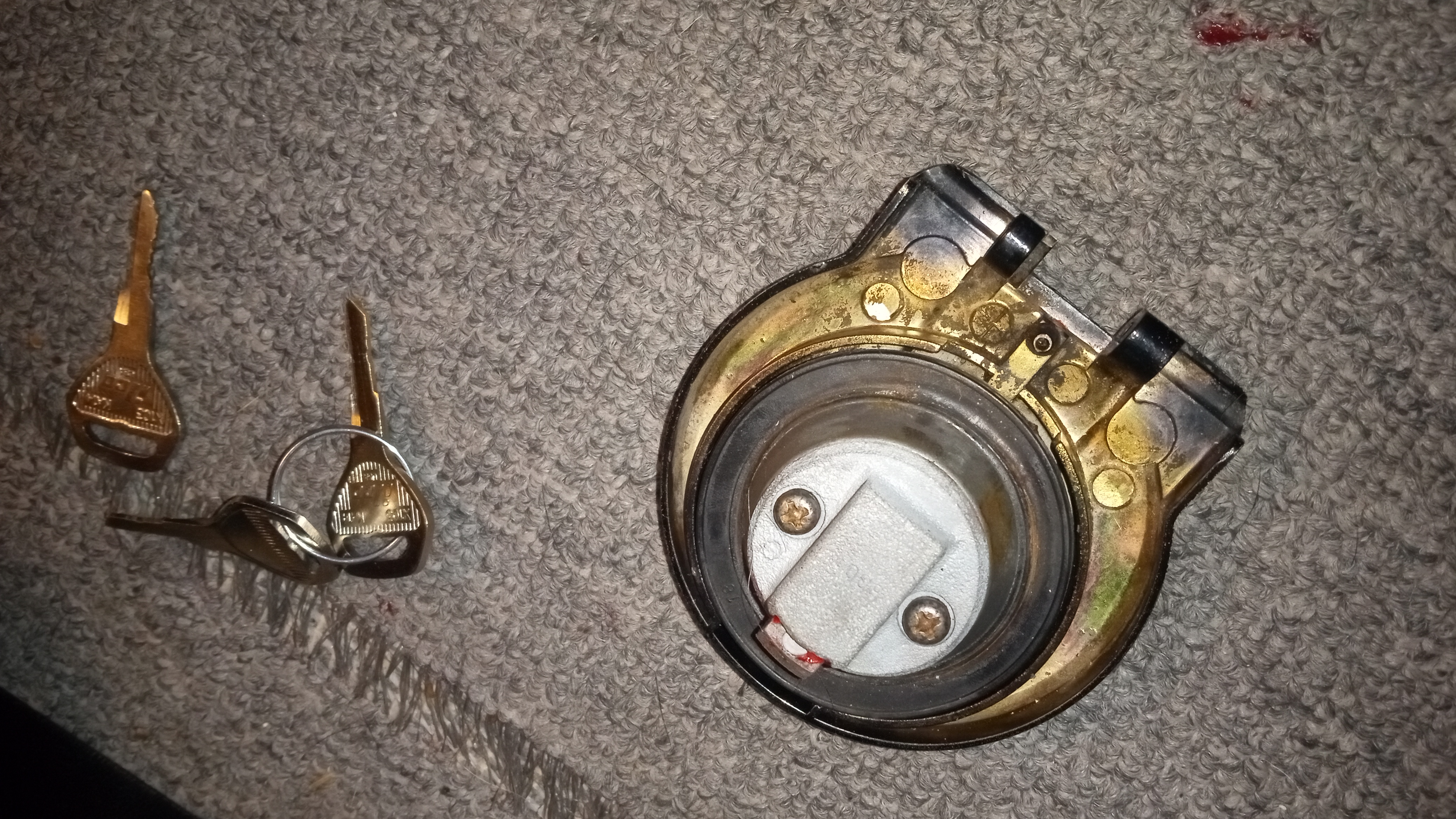

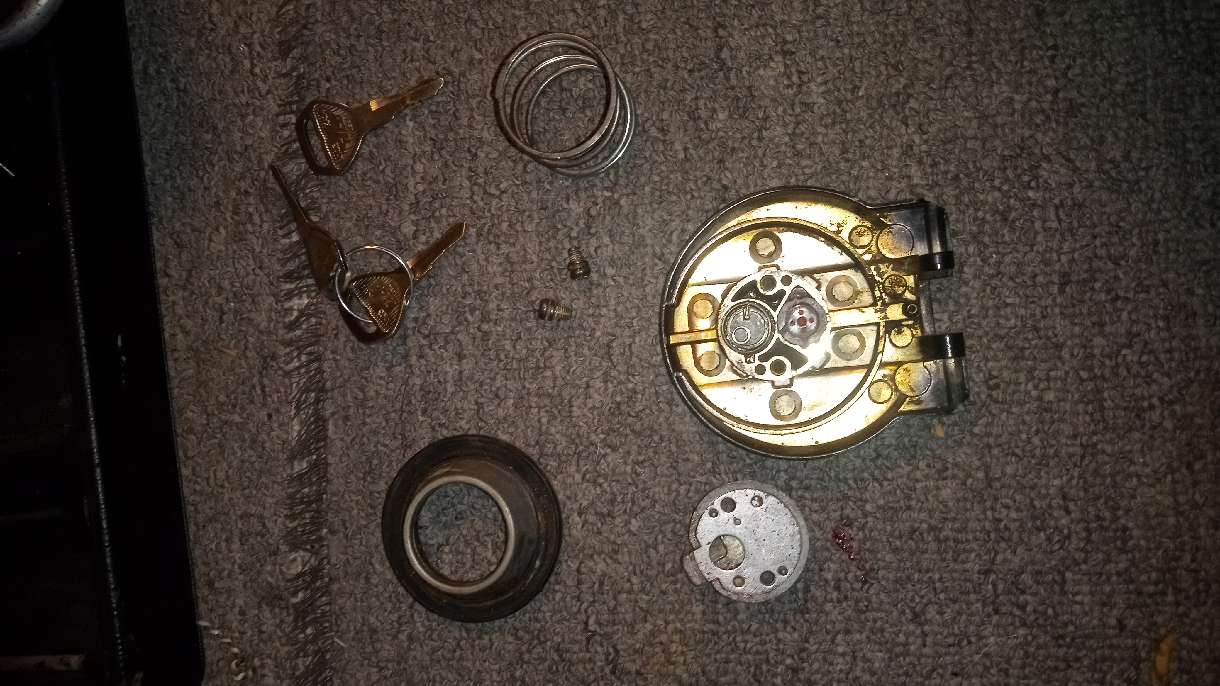

HUUUGE progress today....
Dropped off the seized gas cap at the local locksmith along with two new key blanks & one of the keys from the GPz11 that fits the other three locks on the GPz750...
He calls me a while later & tells me he got the gas cap lock working, but the GPz11 key was different to the 750 gas cap lock & he cut two new keys from blanks he had. WooT!!
So I drive over there & pay him $15, which is basically what he would have charged just for two new keys.
I get home & assemble the gas cap. Then I tried the GPz11 key in the now working 750 gas cap.. & it worked, even though it looks different to the two new keys he cut. Walked over to the GPz11 & the new keys for the 750 don't work in the 1100 ignition or the gas cap.
So now I have two new keys for the 750 gas cap & three keys from the GPz11 that fit all 4 locks on the 1100 & 3 of the 4 on the 750.. & still have two unused blanks.
AND... Between the ultrasonic, a sharp pick thingie & Evaporust I got enough snarge out of the two rear brake mastercylinders that I can now rebuild both... altho I still need to get the remains of the seized bolt out of the original m/c from the 750.
