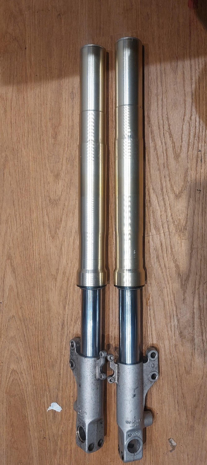

Wow, how time flies, nearly six years ago.
One of the joys of retirement is having the time to do stuff. Done a bit of clearing stuff out the garage and gained enough space to uncover the monster. Hmmm, not good.
Not long after finishing the work the garage roof developed a leak above the bike necessitating a complete new roof, that had to wait until after the winter, then the garage got broken into, my trail bikes and mountain bikes got nicked but the monster got left, however they climbed over it and dropped the mtbs on the monster chipping the tank paint.
The damp/wet months have taken their toll on the frame and engine paint work, not that it was good to start. I can live with/touch up that but the fork legs have developed quite nasty rust pits, oh dear.
Started looking into solutions last night - getting the legs re-plated, alternative forks finding decent replacements. There's a few pairs of forks on ebay but close inspection of the photos showed rust pits like mine, hardly surprising the ones I need will be thirty years old.
There was one set that looked alright and at a decent price, where are they - Reading, I live in Reading
look at the seller - I vaguely know him
Send him a message - is the chrome ok? yes not bad, do you want to come round and check them out? Sure, tomorrow at 12.00? Sure.
So, today off I toddle, yup, same forks as mine, chrome's good - purchased.
Had a good catch up, then home and an hour later they're on. Serendipitous or what!

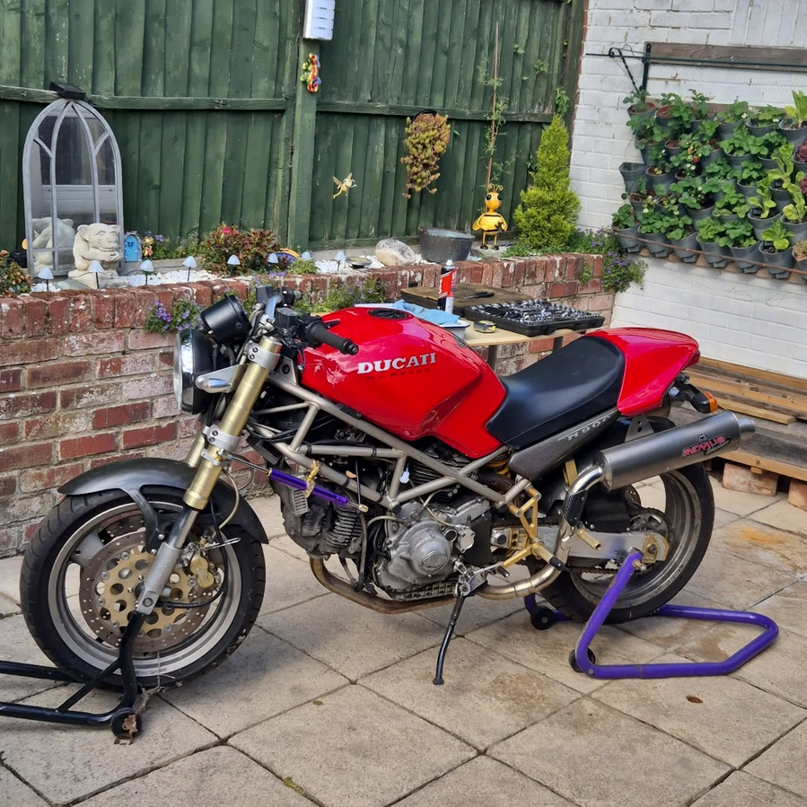

Got a bit ahead of myself there, still stoked at finding forks on my doorstep.
So on sunday I dragged the bike out, literally, the tyres were flat. Stuck it in garden and surveyed the situation. First belts, needed it on stands, the everso kind Mr Weeks had sorted me with a bundle of stands when he gave up motorbikes. Only problem the rear wouldn't fit my swinging arm, needed wider bobbins so back to the wobbly oxford one.
Fitted new belts and checked the bike over. Made a mental list of jobs to be tackled - forks (see above), grips, swinging arm bobbins. Charge battery.
To be continued....
To be continued....

You did, it's a bit of a pain on the monster because of the rear sets.
I went round to the motorcycle parts centre and bought some Kawasaki steel bobbins, only issue was they have an M10 x 1.25 thread and I only had 10 x 1.5 taps. Amazon delivered the 10 x 1.25 tap and 8.75 drill bit < correct drill bit for tap. I've drilled out the standard welded in ally bobbins, tapped the holes so the kawasaki ones fit nicely.
Now the beefy black stand fits
I bought some new grips when I was in the parts centre, forgot to buy glue so went back next day for some, doh!
Battery is on charge, will book an MOT, then test ride
After that, ride it around for a while with a view to doing some more resto stuff over the winter, maybe.

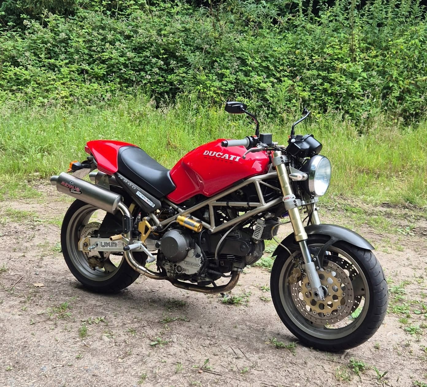

Passed MOT this morning, no advisories
Went for ride, hmmm, not good, feels like tyre is flat except I know it's not as I pumped it up yesterday. Once up to speed it's ok but at low speeds not good.
Pop in to see Mr Weeks for coffee and catch up. While I'm there tighten up a couple of screws and remove steering damper, yup it's not just damping it's stiff as hell. Resume ride and it's back to how I remember it, light steering and flickable.
Really nice ride home the long way and it's great, revisiting an old friend, gradually getting back into the groove.
What's next? Take it places, visit sister in Dorset. Ponder improvements, more to come.
