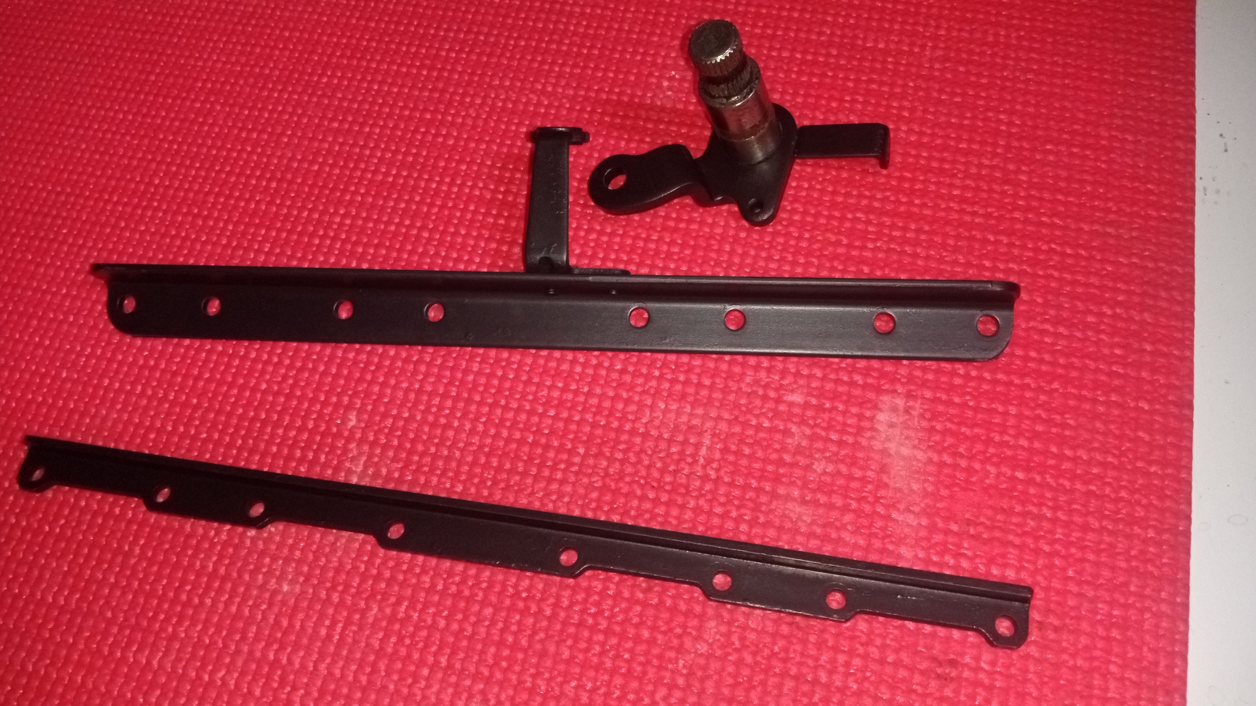

Re: '83 GPz750-A1 malarkey.
Carb rails & brake lever got the Steel-It treatment this morning. Lever looking spiffy... other bits just got turned over & painted on the other side, so they still sitting in the Sun :)
Have to be a bit quick with this paint as it comes out of the rattle can like a frigging fire hose. :crazy:
Rear brake pivot doodad also just got the Steel-It treatment, currently hanging on a piece of welding wire outside in the sun.
Finished the tumbling...well, for now. They'll be more hardware from the fairing, front fender, footpeg mounts etc when those parts get pulled off the bike.
There's duplicates in this pile as some parts are from the spare set of carbs. Ferinstance, the thicker idle screw is from the original carbs & the thinner one is from the spare set, as are a lot of the screws.
KungFooBob wrote: Tue Jun 16, 2026 8:46 pm Never heard of Steel-It, but that looks like a nice finish.
https://steel-it.com/
It comes out the rattlecan so frigging fast you'd think there's going to be runs, ripples & orange peel etc, but it smooths out perfectly. It's not exactly cheap, a rattle can of this stuff was $41. But that one can has done a some GPz750 parts, the brake plates, rear axle & pumpkin on the F350 & there's still plenty left in the can.
Carb rails & rear brake lever doohickey.
