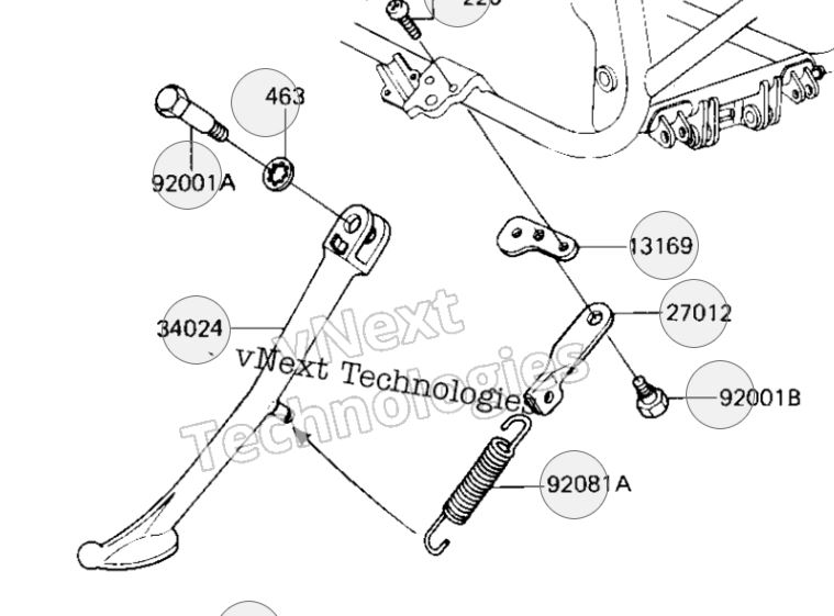

* actually found all the parts, but I'm not paying damn near $80 for #27012
'83 GPz750-A1 malarkey.
- Posts: 8826
- Has thanked: 2222 times
- Been thanked: 2593 times
Re: '83 GPz750-A1 malarkey.
Found most of the parts* for the weird kickstand. Ignition system gubbins will be on it's way here tomorrow.

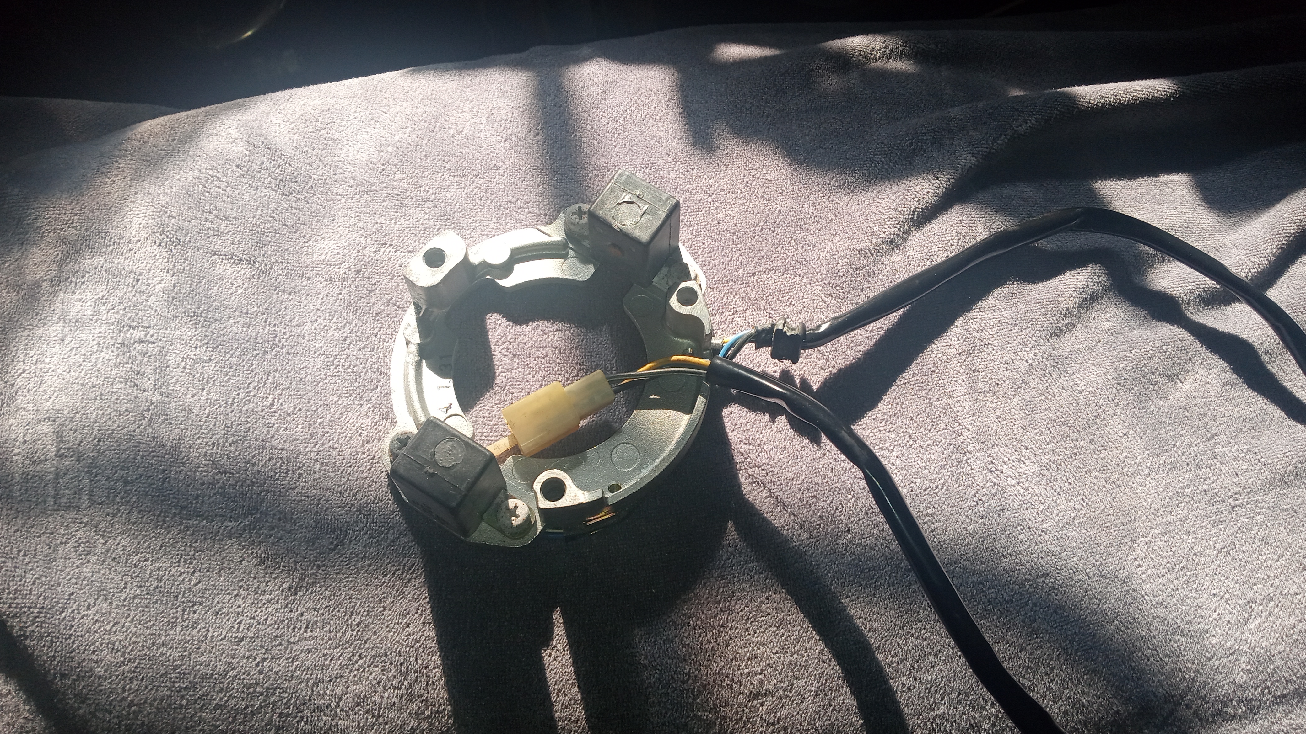

This just showed up, which will be a major contribution to getting it to run... or at least spark... hopefully

oh, & I installed the new ignition gubbins & got the fucker to fire up!! albeit with a squirt of ether down the carbs... which I then removed & bought home for o/h. Two slides are stuck open & two are stuck closed.. but at least now the butterflies move, everything was locked up this morning before it all got a spray with Tiger Piss.

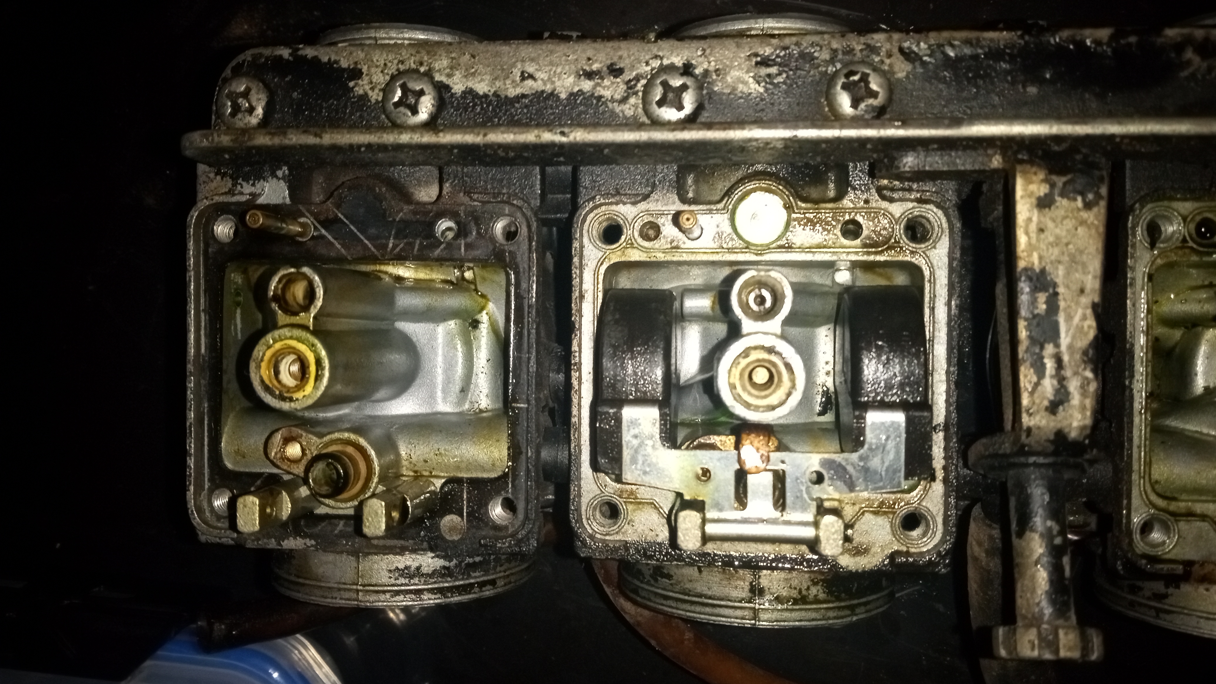

Delved into the carbs... dear god what a mess.
This morning NOTHING moved. Gave it all a spray with Free All which is a lube/penetrant/rust buggerer.
Managed to get the butterflies moving first & then worked them a bit so they're moving freely now.
Removed float bowls, cleaned them of the varnish.
Removed 3 of the 4 floats, can't get the pin out of the #2 carb. It got sprayed with lacquer thinner, brake cleaner & then Free All, will try again tomorrow.
Removed three float valves.
Removed the main jets & poked them to remove the solid varnish that was completely blocking them. #1 main is probably buggered, will assess when they're clean.
Flipped carbs over & started on that side of the clusterfuckery.
Diaphragms are all OK, Needles were all munged up, but they cleaned up just fine with lacquer thinner & a paper towel
Reassembled top side of carbs for now.
Got the choke shaft freed up & now all that gubbins is moving easily.
Need to get some carb cleaner to spray through various orfices (orifii?) etc.
Given how bad the carbs were with regards to butterflies & slides not moving I'm surprised it fired at all

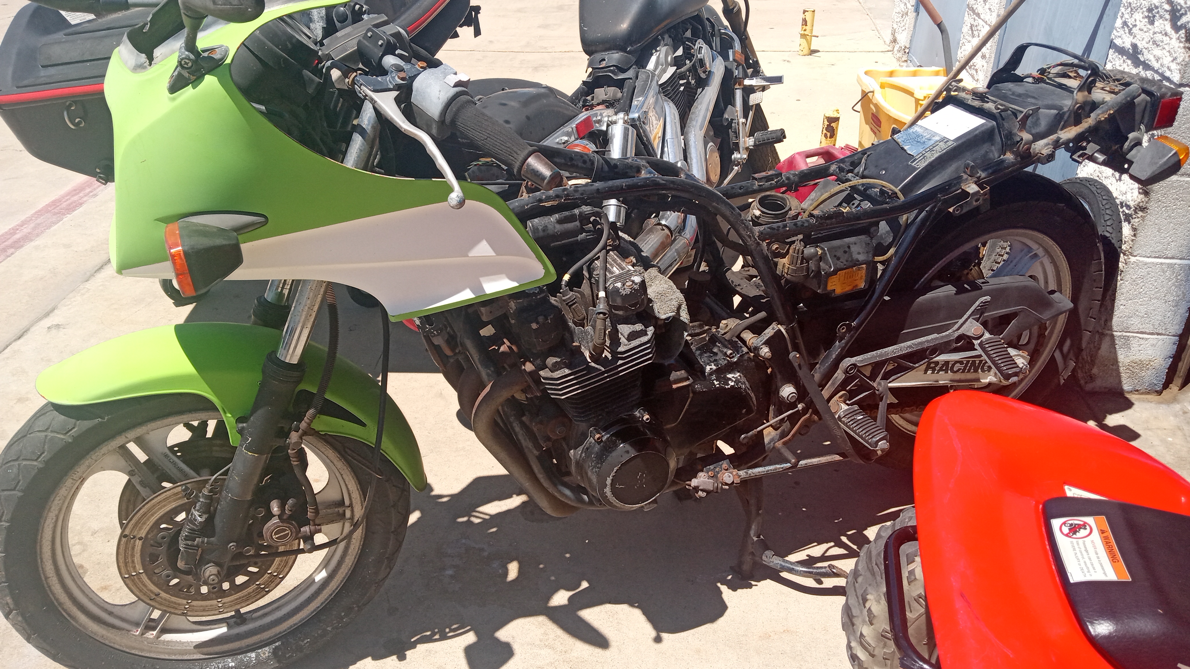

It's living at a mates shop so I only work on what parts I bring home. I won't be back over there before May 29th at the earliest. I guess I should have taken more pics of the carb work yesterday, will take some today.

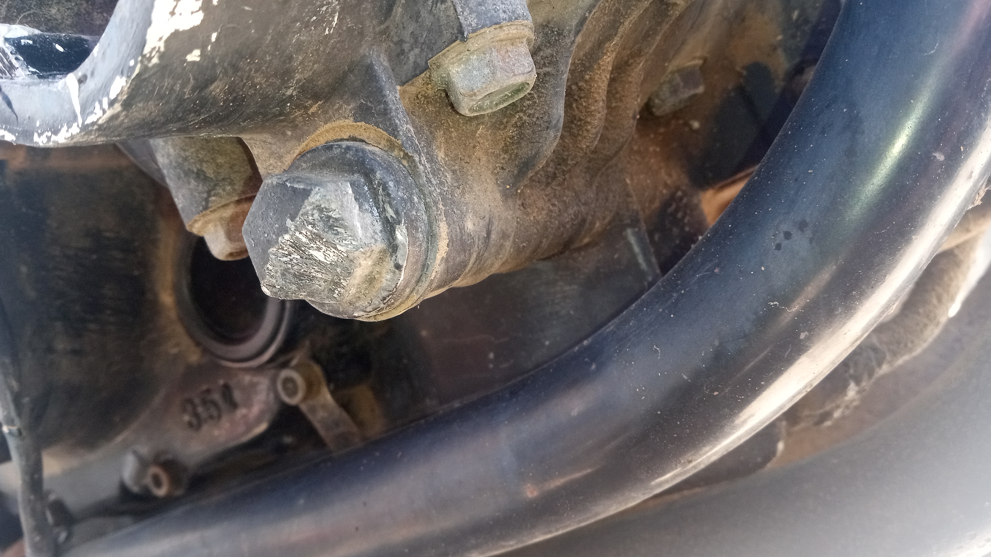

Rear master cylinder is mullared, found one on Ebay for $30 as it was listed for a KZ750, same as the GPz version... which was listed for $100.
Got the rear brake lever off the spline thingie easily enough, but that spline part is damn near welded into footpeg bracket wotsit.

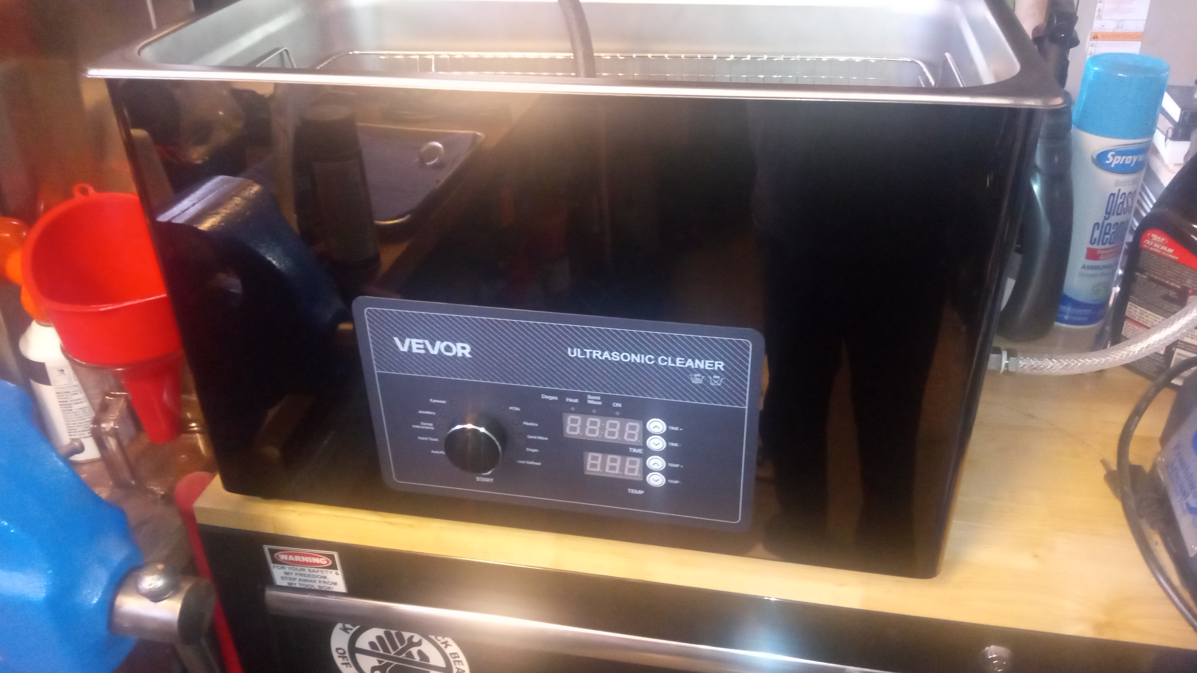

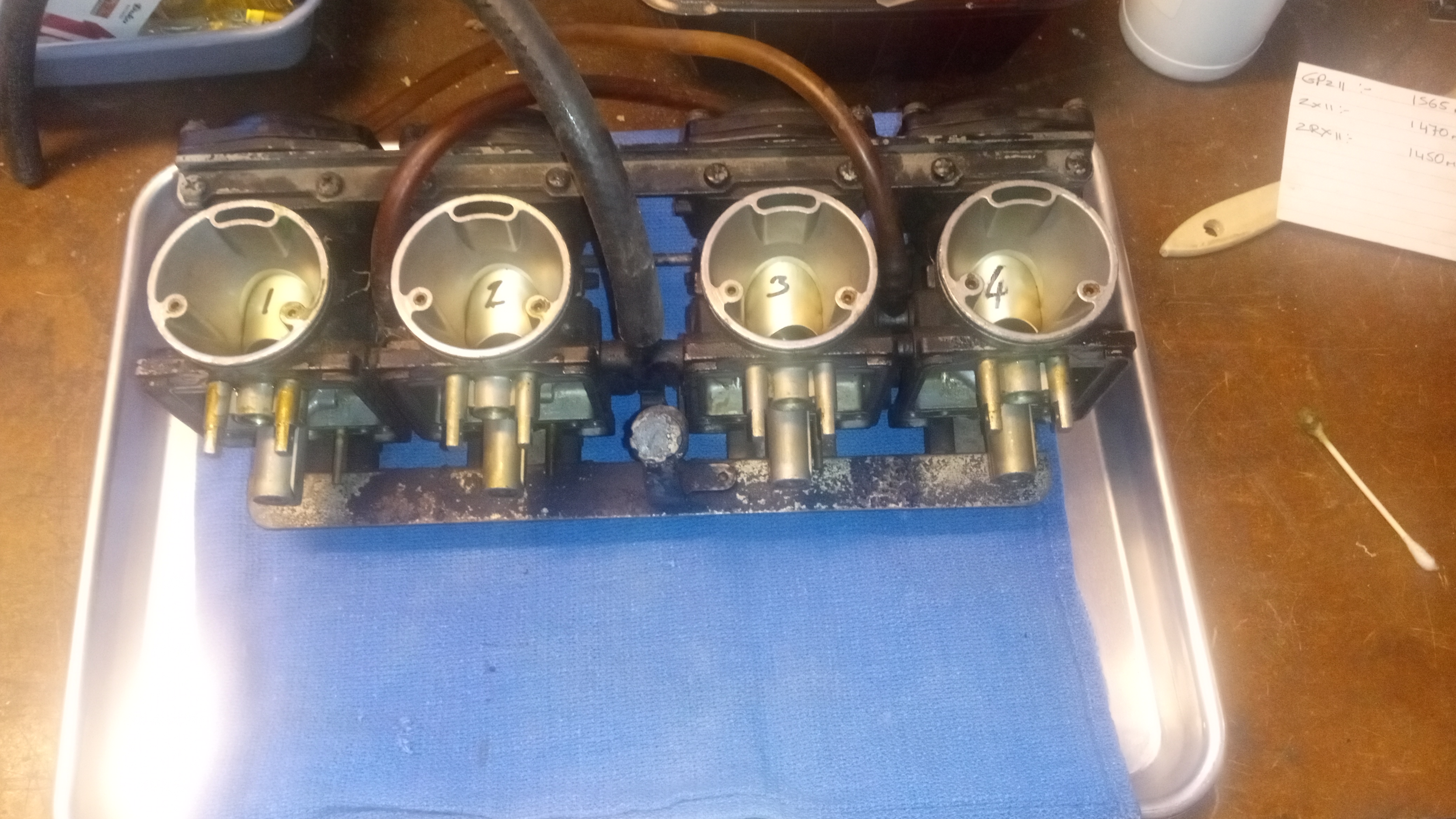

New toy, er, tool showed up. Carbs easily fit, guess I know what I'll be doing tomorrow... It's a tad bigger than I expected (that's what she said....)
Cage for small doodads is REALLY tiny. Usual method is to use those metal mesh pen holder/desk organizer thinigies though.
