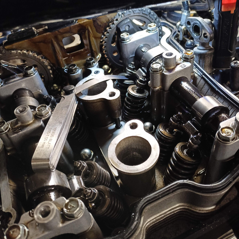

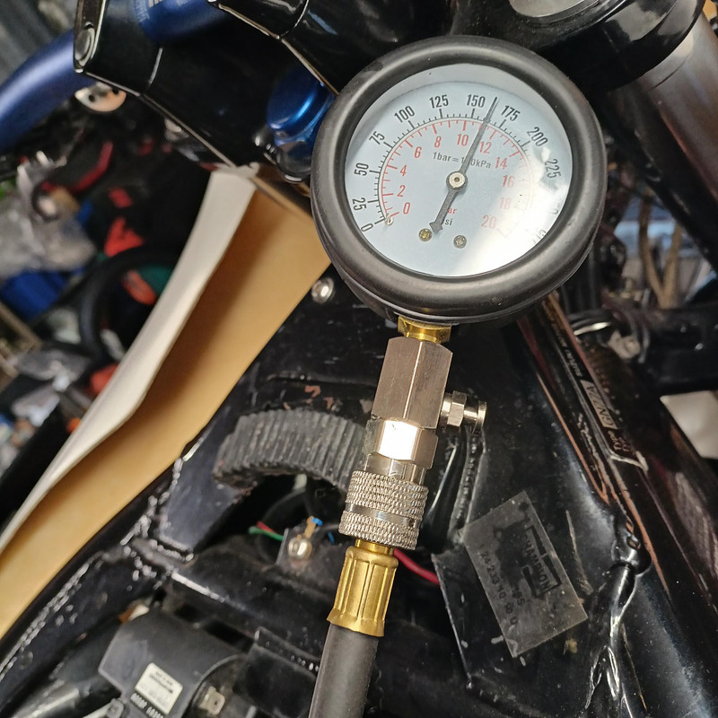

As for the bikes, TB has had a full engine service with the first thing being a compression check which showed all was well, so new plugs, oil, filters etc and valve clearances. The inlets had closed up enough to need adjusting on two cylinders, but all exhausts hadn't moved all season.

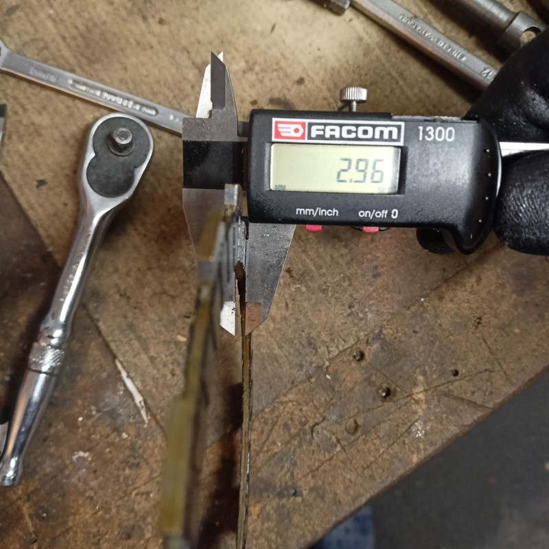

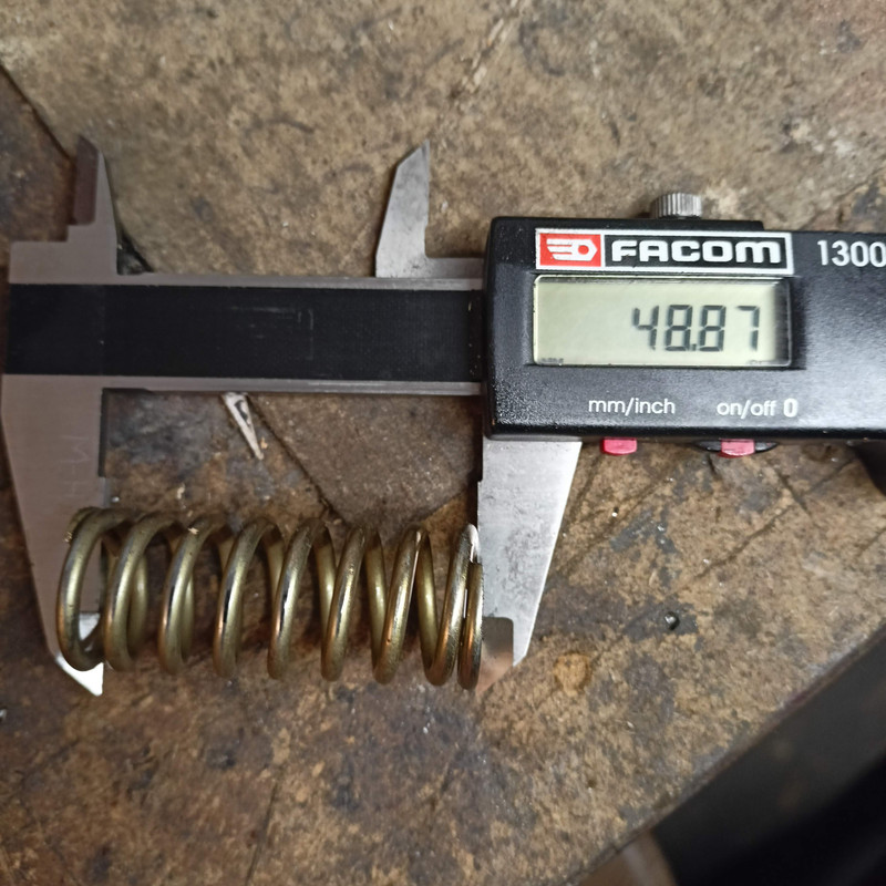

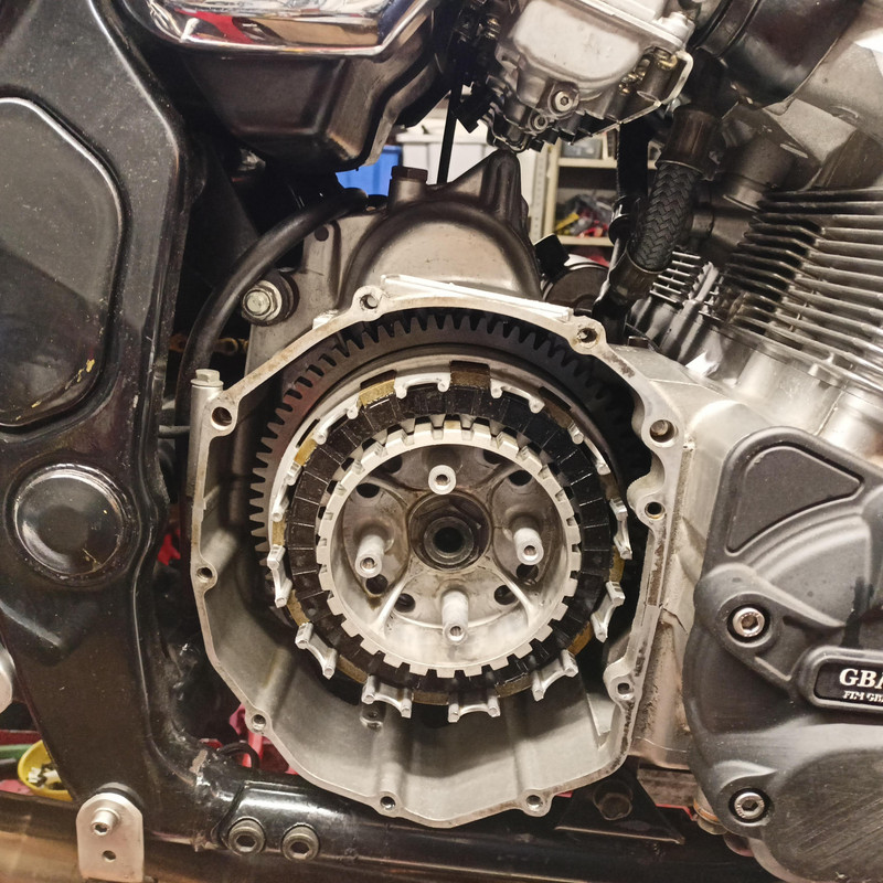

I was also getting a bit of clutch slip at the last round, so out it came for inspection.
All the plates looked good an well within tolerance with no visible signs of wear,

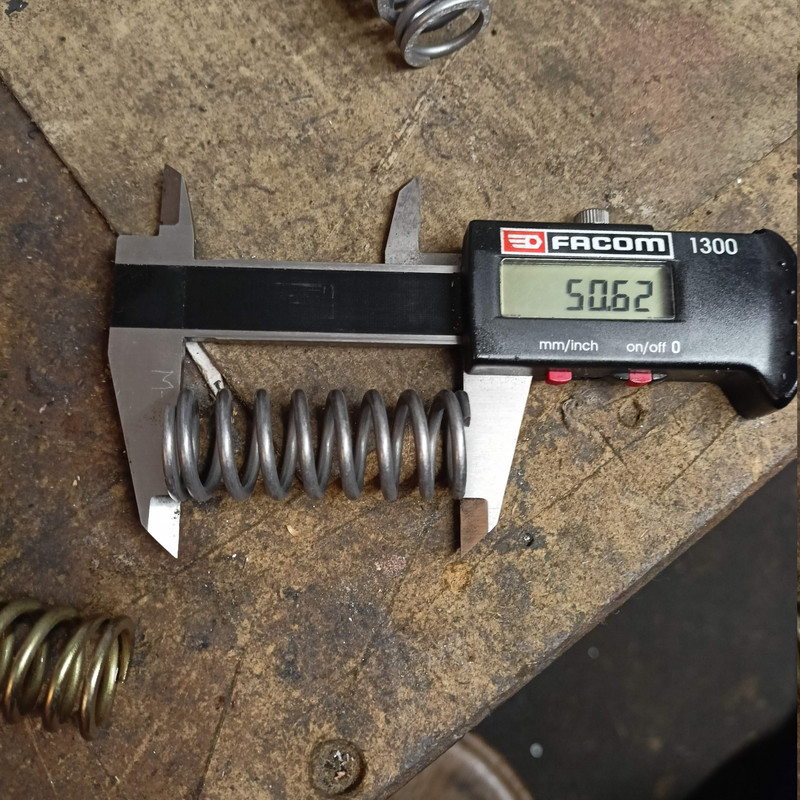

So the plates went back in, with some new (slightly longer and stronger) HD springs
Old springs
New ones

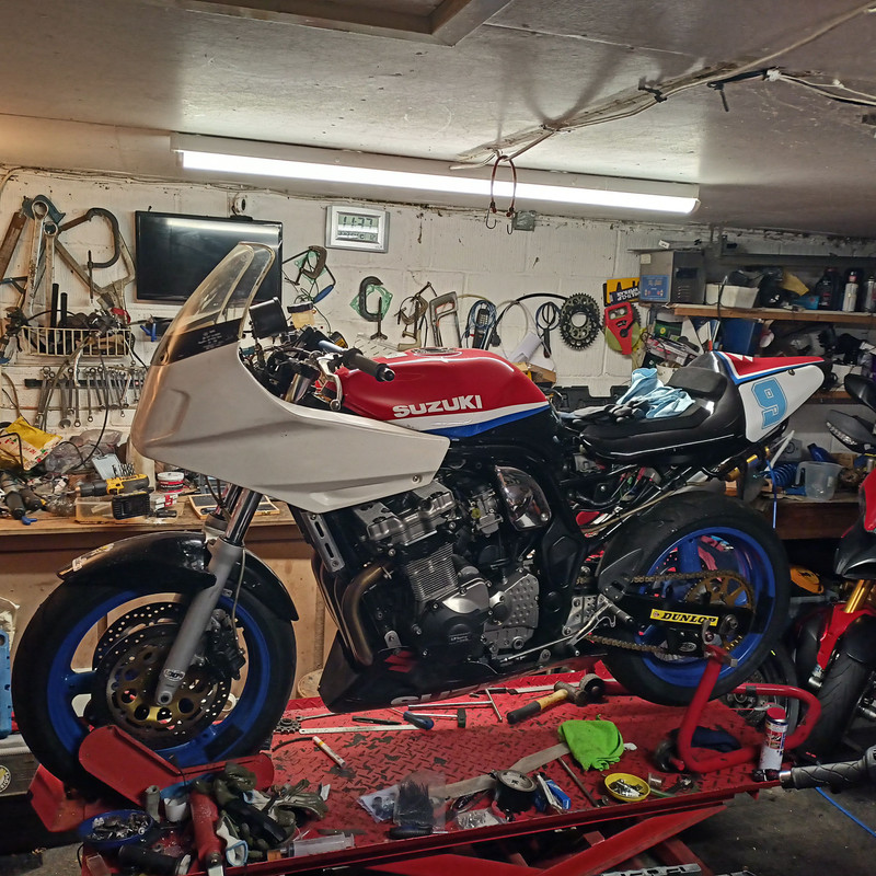

And that’s where we currently are- the original old girl is now on the bench and having the same engine service treatment and check-over, and I still need to properly sort the rear ride height with some different dogbones to try and settle the handling on wets, and we should then be hopefully all set to go get em!

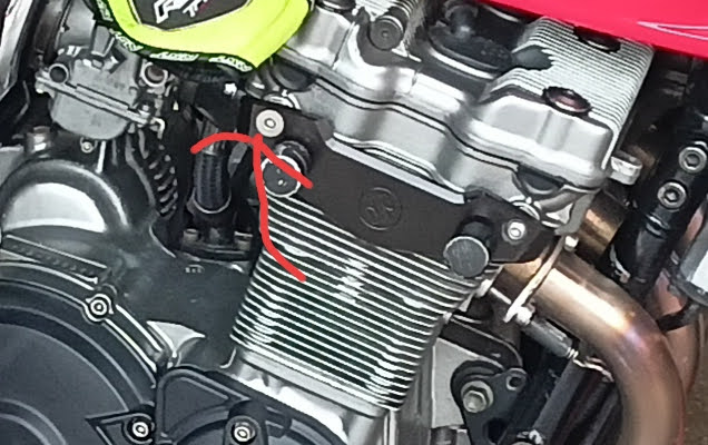

And it was good that I did, as I spent most of the day chasing down a couple of oil leaks- one from a sealing washer on one of the rocker spindles behind the cylinder head protectors – these things
And the other, which took a bit more sorting out, was from the ignition pick-up cover- it took a bit of a whack at my little off at the Anglesey TD with @dodgy last year meaning that one of the bolts into the crankcase is now an M8 rather than the standard M6, and the spacers on the (compulsory) GB racing cover seemed to be causing an issue now.
I replaced the gasket, and went out again, that didn’t fix it , and after that replaced the GB Racing cover with a new one and all new bolts, and that did, so the next few sessions were uneventful.

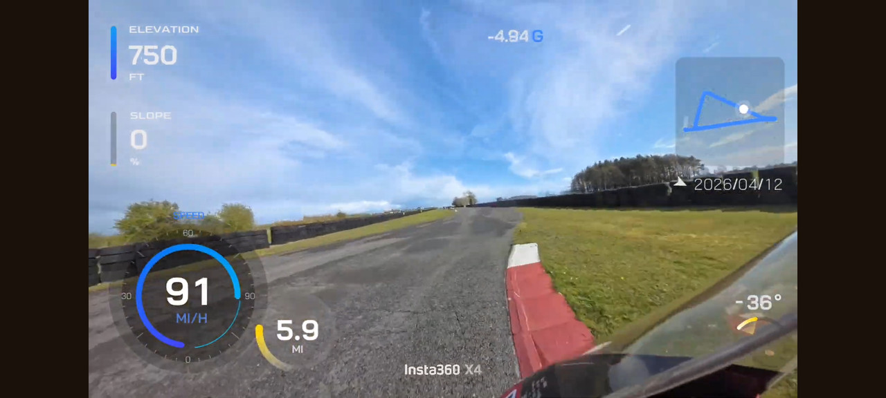

And although I lost my way a bit for a lap or two half way through after a lost the front at Mclarens, it was a decent race for me- slightly frustrating in my lap-times in that I still hadn’t broken into the 54s, but I crossed the line 8th on the road, 1st Vet and 3rd Bandit with the next Bandit some 6 seconds behind me, so a decent result.
Vid of the race here- I also have an edit including the GPS stats which is quite cool to see top speeds, G force etc, I couldn’t do the 360 degree views with them enabled so you don’t get to see some of the stuff behind me, so I think this is the better vid- on this circuit, for this race, anyway. Actual race starts at 3min20sec.
