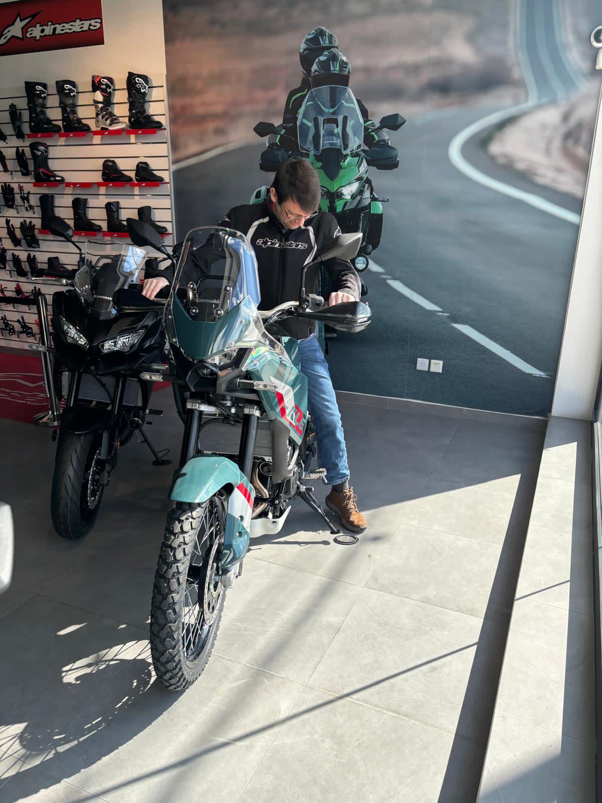

I've gone ahead and ordered a bike I hadn't even heard was coming before that thread.
I'll be adding the OEM optional rack but a different top box, so imagine this with a Givi box.
It's due in at the dealership 08/04/2026.
Many thanks to @matt for the tip - I really wasn't aware of the bike til that comment :obscene-drinkingcheers:
One slight problem is that I can nearly flat foot it.
At 5'9" I've never had this problem before, so I'm open to any tips. I'm not really looking to just brave it though, because of how rough the roads are in Malta and how likely I am to be riding in solid traffic and put my foot down into a pothole. I'd also prefer not to do lowering links since it's well documented that this model scrapes its belly like a pregnant dachshund.
A local lady has already had her seat lowered by approx. 40mm and a gel pad added. She's paid €220 to a local upholsterer for that.
Has anyone here had a gel seat before? Considering I live in Malta, is heat retention a real problem? I don't often park outside but it's not a "never".
The -30mm optional seat from Kawasaki costs about €420 with tax, but then you do keep both.

Having put my foot down in a pothole.... (well actually a puddle that was a lot deeper than I expected it to be)... I now just make sure that I don't do it again.
Which I know is an annoying thing to say.. ;) :D
I would imagine that the main options are (depending on the set, I'm not familiar): dfferent dog-bones for the suspension linkage (if it has one), a shorter shock, lowered seat, or potentially: pushing the forks up through the yokes. Or very thick boot soles. :D

Dog bones reduce the ground clearance and as mentioned, the bike sits low enough already.
https://www.facebook.com/share/r/1G1pmzpdVC/
Thick boots is a good idea, but she's for commuting, so I'll be wearing whatever shoes I'm wearing. In Malta where it might be 40° or more in summer, I'm definitely not trying to wear big thick bike boots every day!
Forks are already flush to the top yoke, there's nothing to gain there.
I guess that just leaves the seat.
Question then is whether to get the Kawasaki -30mm seat for €420 (it might prove to be a stepping stone and then I put the original seat on again after a few weeks or months), or have the original seat shaved down and a gel pad added for €220 (but then there's no quickly swapping it back and I have possible concerns about roasting nuts)

I've just been though this with my 500 KTM, had it professionally lowered both ends, not cheap but very successful. I already had the KTM lower seat, if you're getting yours cut and recovered make sure the foam is removed in the correct area and doesn't force you to sit too far forward or back, will it allow you to move, I think you carry a passenger - will it cause them to slide into you.
Firstly I'd check the suspension set up - is it set up for someone your weight? it may be that by adjusting the correct sag or a bit more the bike sits lower.
Rock's suggestion about adjusting the forks is worth looking at, though it will affect the handling - if the legs are flush then pulling them up through the yokes will drop the front.
How much ground clearance do you need, are you taking it off road? Blokey in the facebook link is jumping it, will you be doing that? Was his suspension set for his weight.

I’m 5’9” and ride a Yam Tenere which has pretty much the same seat height, I reckon you’ll soon adapt to the extra height after a few miles.
A slight twist of the hips and I can flat foot on one side with the other foot still on the peg.

Of course, I'm thinking backwards about the fork height. That would give you potentially a little bit or lowering, but Idk if the wheel hits the radiator then.
Matey is heavier than me and I've no intention of riding off-road like that, but there's a fair chance I'll bump down off a kerb now and then. The point is there's really zero ride height available to give up, since it can already ground out stock.
I'll start with a thinner seat. Just not sure whether to modify the stock one or buy a lower one.

The local lady who had her seat cut down says it wasn't the greatest job, and the seat now rubs her thighs at the contact point. So we won't do that.
A_morti wrote: Thu Apr 02, 2026 2:59 pm I'm not really looking to just brave it
So I'm going to just brave it :obscene-drinkingcheers:
Worst case I have to ask them to order the low seat for €420 and use the CBR (which is staying on) while I wait.

I can reach the ground just fine. On one side :banana-dance:
