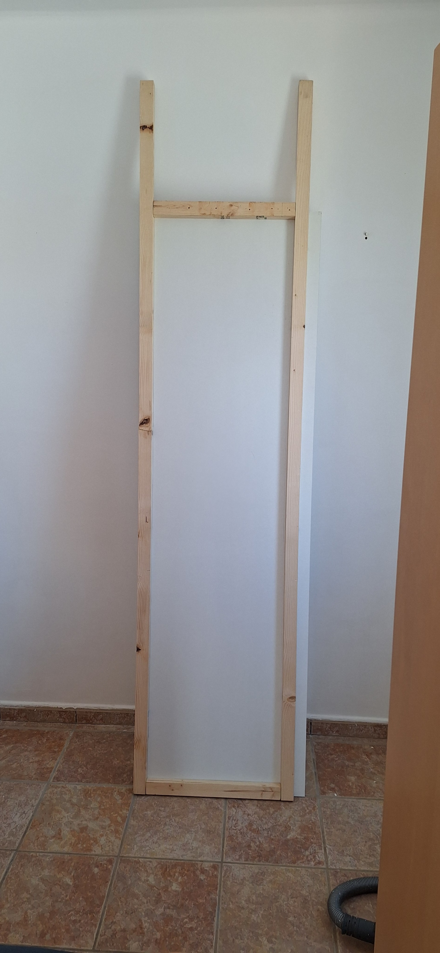

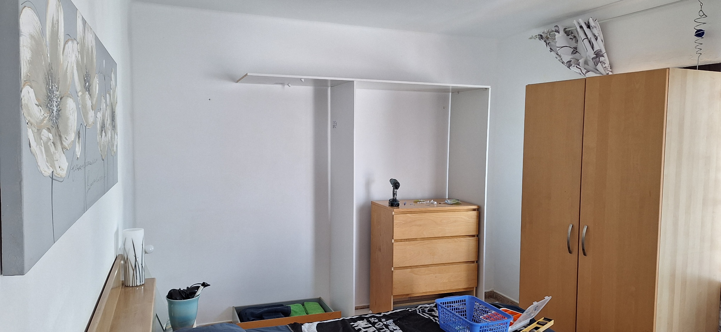

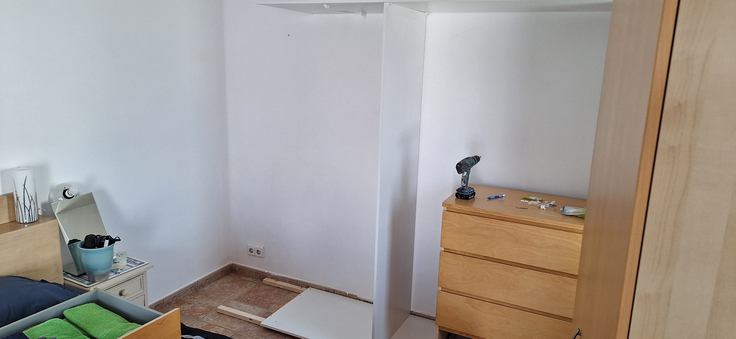

There's very little choice of wardrobe over here and a bespoke one was touching 3,000€.
So decided to build a carcass myself. My carpenter pal Hippy will fit the doors.
The wall is 3.27m so decided on a 1.2m wardrobe each side and a shoerack or makeup mirror in the middle.
I've never done anything like this before so complete trial and error.
I built a frame onto the first bottom board so can join the 2nd board later. And keeps it off the ground.
We both wanted a hanging rail and set of drawers and long hanging space.
We already had sets of drawers so used them.
And to keep the whole thing upright, I screwed the outside upright board to the drawers. Instant stability ;)
Just built one half to see how it goes. Then will slide this one into place and build another and do the middle bit last.
I made loads of beginners mistakes, but persevered and it stands unaided ;)
Tmrw hanging rail and shoe racks.

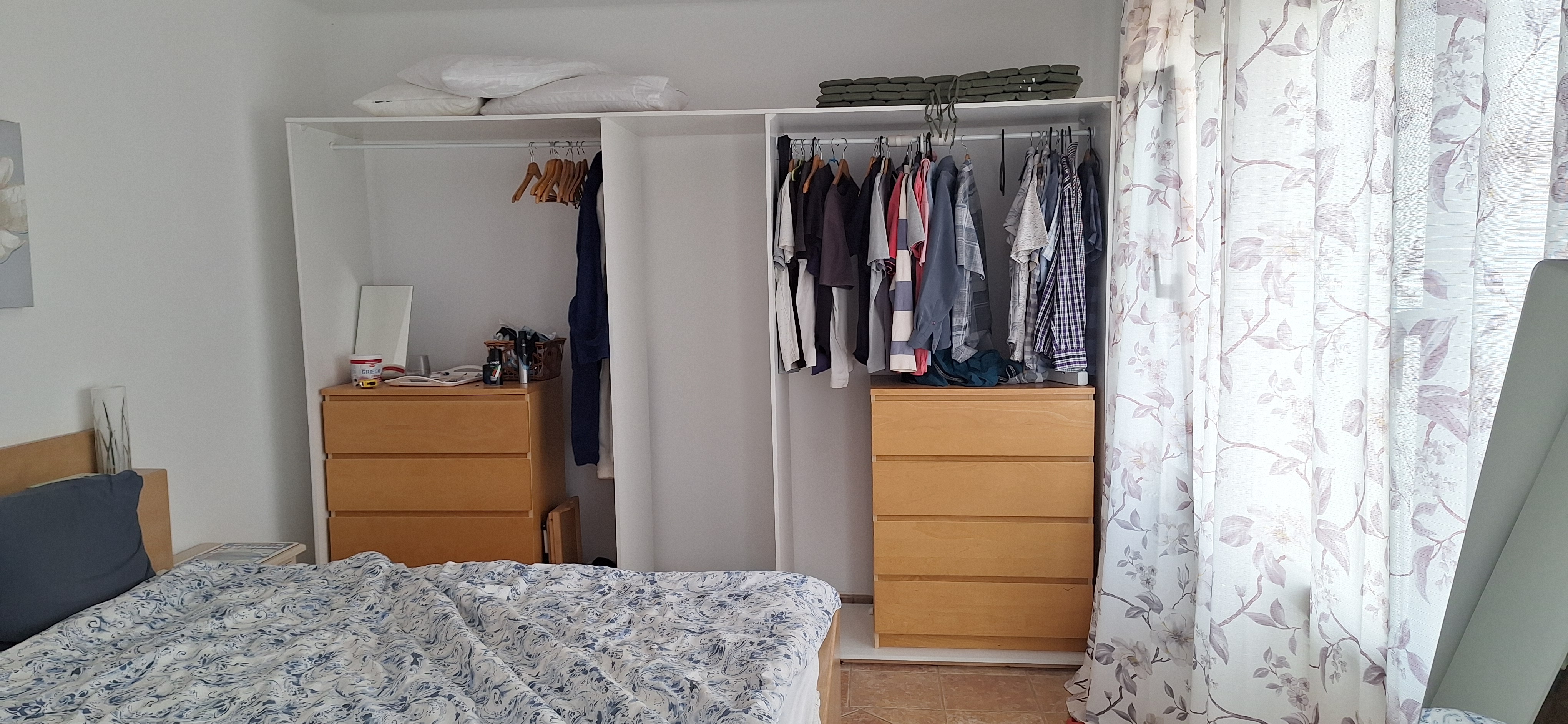

Carcass finished. Just waiting for Mrs T to decide on doors. Waiting for quote for ceiling mounted sliding doors
