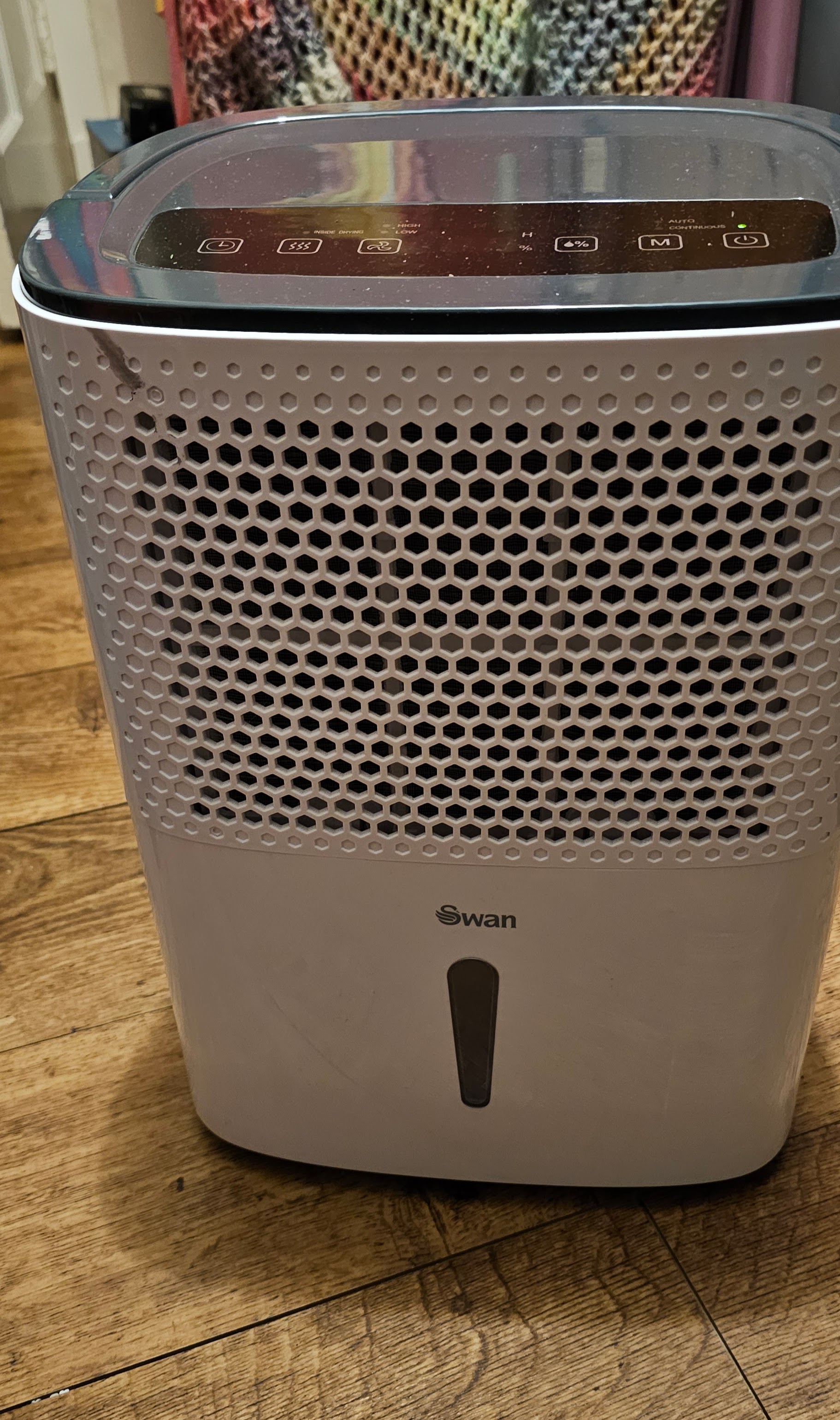

Count Steer wrote: Sat Dec 13, 2025 8:40 pm I've got 3 Pro-Breeze dehumidifiers and v pleased with them.
I’ve got one of them as well, dries my laundry out nice and quickly, I’ve no tried it in the pantry, only room which appears to suffer from damp, what with being subterranean, but very pleased and the resulting water keeps the iron topped up :thumbup:
