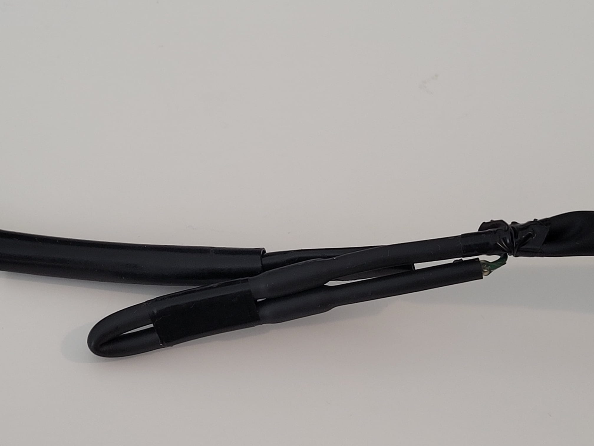

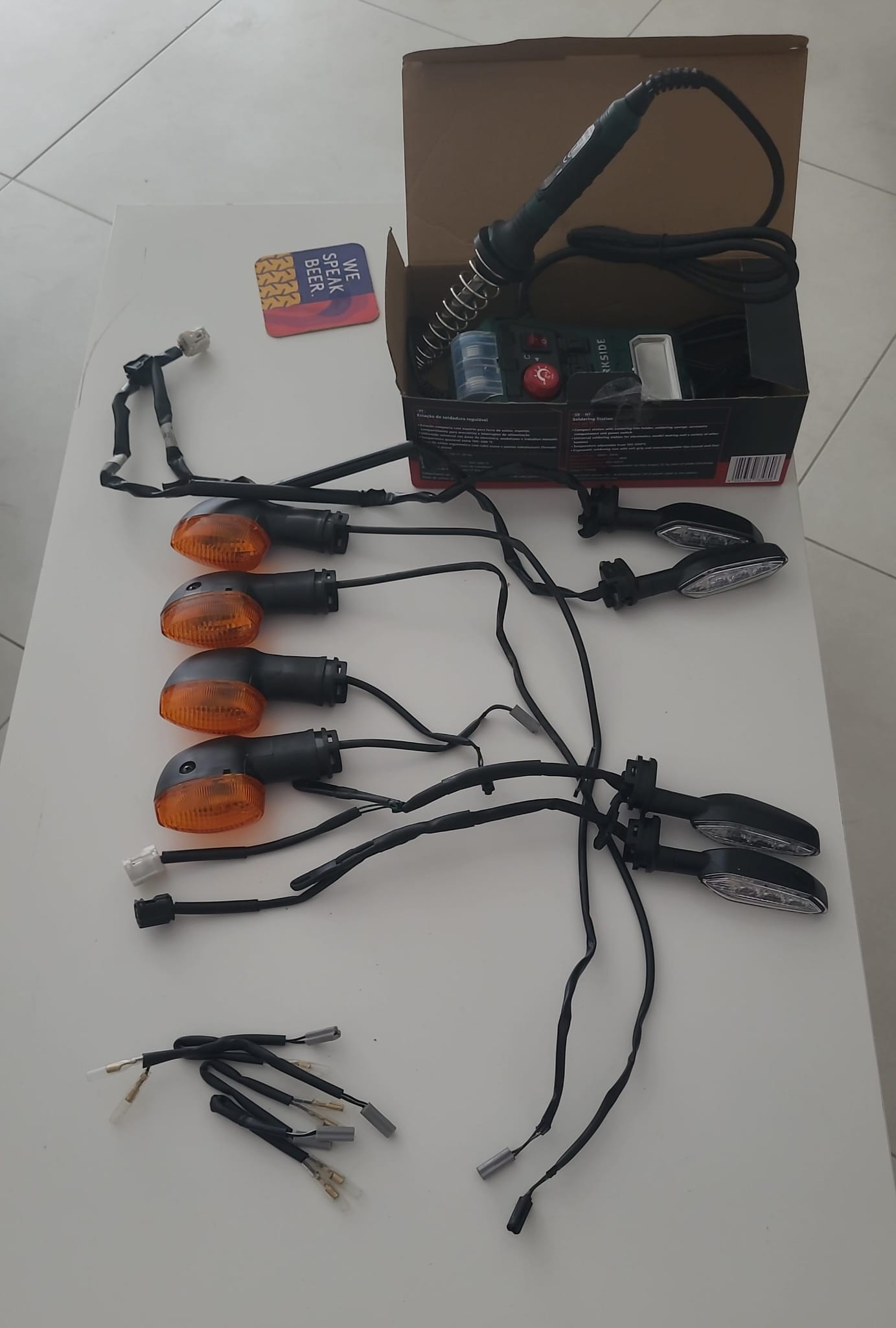

In a reenactment of polishing the brass on the Titanic, I decided to finally fit the LED indicators I've had since Christmas. They came OEM with a later Yamaha. They fit the fairing holes perfectly, albeit the rubber is harder and they put up more of a fight than the originals.
I didn't want to modify the original loom nor cut the original indicators, so I got some adapter cables and cut the special connector off them to solder in. Brilliant

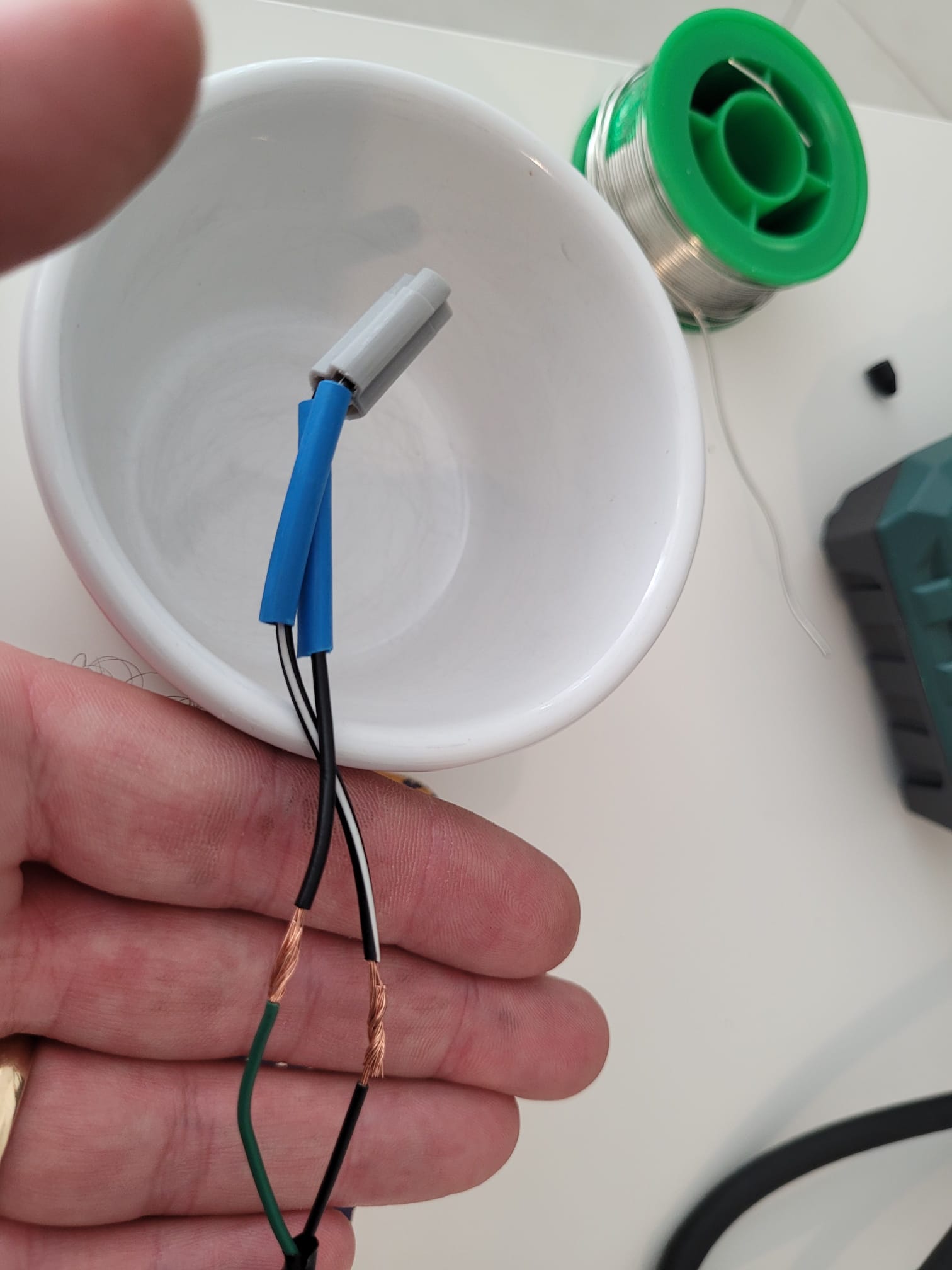

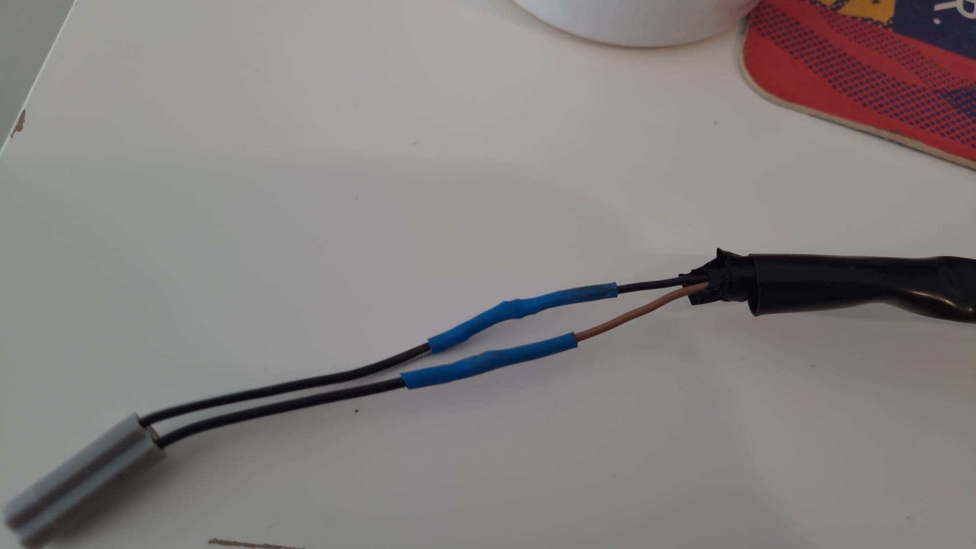

Bit of light soldering action (boom tish).
There are resistors in the wiring which apparently must be kept even if you use an LED relay. They reduce the voltage from up-to 14.5v down to whatever the indicators can handle.

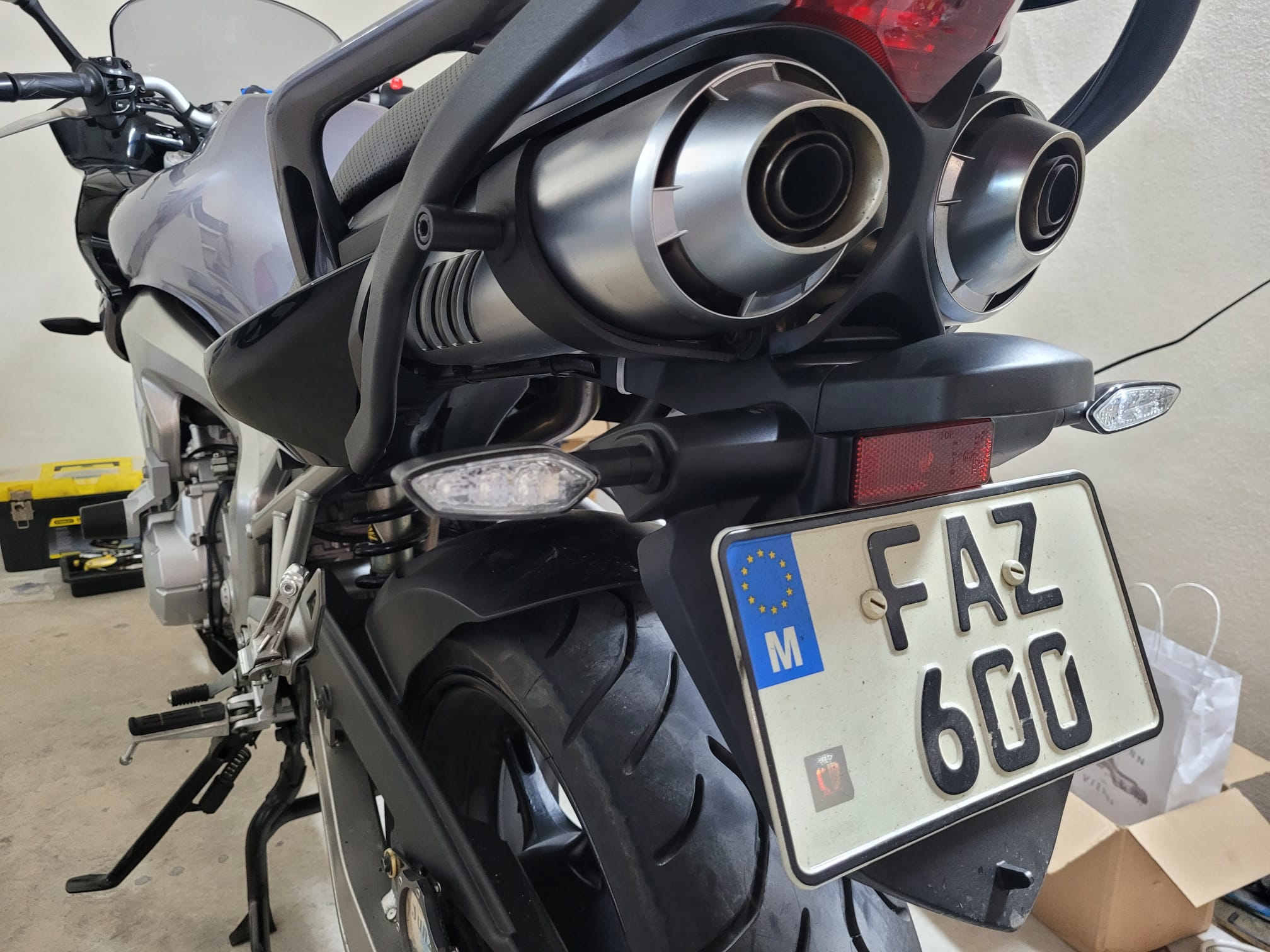

New indicators work fine at idle and low revs <3k, but hyperflash at higher revs. Will try a different relay.

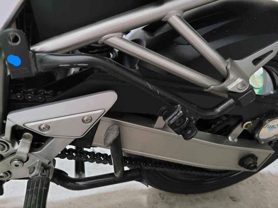

Mini_Morti has been complaining about the rear seat on FAZ.
The seat is fine, the backbox is fine, the hand grip is fine... but that rear cowl is bulbous to get around the relays at exactly the point where a passenger (small or full sized) wants to put their ankles.
Apparently putting the exhaust under the seat resulted in compromises. Who knew, eh?
So I found some of these things secondhand in Slovakia of all places: They're 200€ new, and looked perfect for what I needed.
https://www.hepco-becker.de/en/lowering ... fazer.html
I paid 50€ shipped. They arrived in fair condition with scratches and without any bolts (those are Triumph front caliper bolts) ... but at the price, I was quite willing to dig in the spares box and paint them silver to match the frame myself. Except... Turns out they are for the fz6 S2, and will not fit my S1. Even though the seller's image showed the parts fitted to an S2, I hadn't seen that coming because Hepco & Becker don't list a part for the S2 model, so I assumed it would be the same. I now reckon they've just sold all their S2 stock and aren't interested in making more for a 15-year old bike.
I was looking at drilling a hole where the blue dot is and adding a spacer to clear the subframe, trimming down the tab and painting it all up nice... but when I went to get the drill out, that dot is a lie and in reality the hole needs to be right on the very edge of the tab. Those bolts not only hold my kid up but also attach the rear subframe, to which the rear shock is mounted. So redrilling is a bust, I don't have an acetylene torch to heat them enough to bend (they 100% will not bend cold, I've already tried jumping up and down on them) and anyway I'm not certain it would reach, so they will get punted on.
I'm unwilling to spend 200€ on getting the right ones from H&B, so I've ordered these guys instead:
https://www.bruudtcnc.de/shop/product_i ... fazer.html
They move the peg in one of 10 adjustable angles at a radius of 65mm, and give 58mm more width. Normally I'd consider that "58mm" the result of clumsy workmanship, but in this case the "out" might help solve the problem just as much as the "fore".
At a bargain 140€ it's too much money for what it is, but I couldn't find a Chinese copy like I could for the mule, and at least it'll fit any future Yamaha I might own. I've been really impressed by the build quality of the FZ and rather like the Tracer 700, so maybe one day they'll go on one of those.
