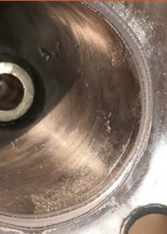

Firstly - the 2nd head I bought is badly pocketed: the valves have been sunk into the head so far (by use and grinding in) that they're actually now "outside" the original hemisphere shape of the combustion chamber. I also found out the other day that the original head has had the valve-seats replaced (I think I knew this), so it's actually in better condition than Head 2 (despite Head 2 being cleaner... ).
In addition we dicovered that the exhaust valve for Head 1 is bent. That was a puzzler - because there's no evidence of it having hit anything within the chamber (the other valve, or the piston). It's why it wasn't sealing. Luckily he had a 2nd valve that slotted right in.
We also looked at the loose inlet guide, and he replaced it from his stock. I didn't know this... but the valve guides can just be hammered in and out! :wtf: The original valve fits in the new guide perfectly, so Head 1 will be back in action once it's fully cleaned up and re-lapped in. :D I'll probably by some flap wheels for my Dremel and have a go at the carbon build ups in the exhaust manifold myself, and then as a final resort take it to a media blaster of some sort. (walnut or vapour probably).

Cleaned up the carbon in the barrel and gave it a hone. (Hoping I haven't over-done it tbh...)
I used a honing tool I bought at Beaulieu, and 3-in-1 oil (after doing a bit of research on cutting fluid/honing oil - from what I found it's basically just light oil).
I also had a god at the piston crown and it's now nice and shiney. (pics to follow)

Then cleaned off the coarse paste, and prepped the valves..
After a fine grinding.
Next job ideally would be to lap in the head to the barrel, to ensure the mating surfaces where the copper head gasket sits mate really well, but there's a complication I need to discuss with my guy.
Where the head gasket sits is in a depression in the barrel, and the head has a matching "protrusion", and where the studs run is in the"outer ring". I'm not sure if the faces on the "outer rings" are supposed to meet or not.
Problem is that if the gasket is not in place, the "inner ring" faces don't meet when you sit the head on the barrel.
I'm not sure if I need to get some material machined off the top surface of the barrel or not.

I wouldn’t be satisfied with that bit around four o’clock.

JackyJoll wrote: Fri Jul 11, 2025 8:52 pm Image
Thanks!
That's what i needed, another set of eyes on it.

P E Irving recommended a minimum 1/32” inlet valve seat width, although that’s for competition.
Are you familiar with three-angle valve seat cutting, to avoid making the radial flow change direction more than 15 degrees at a time, when the valve is open by a small amount?
