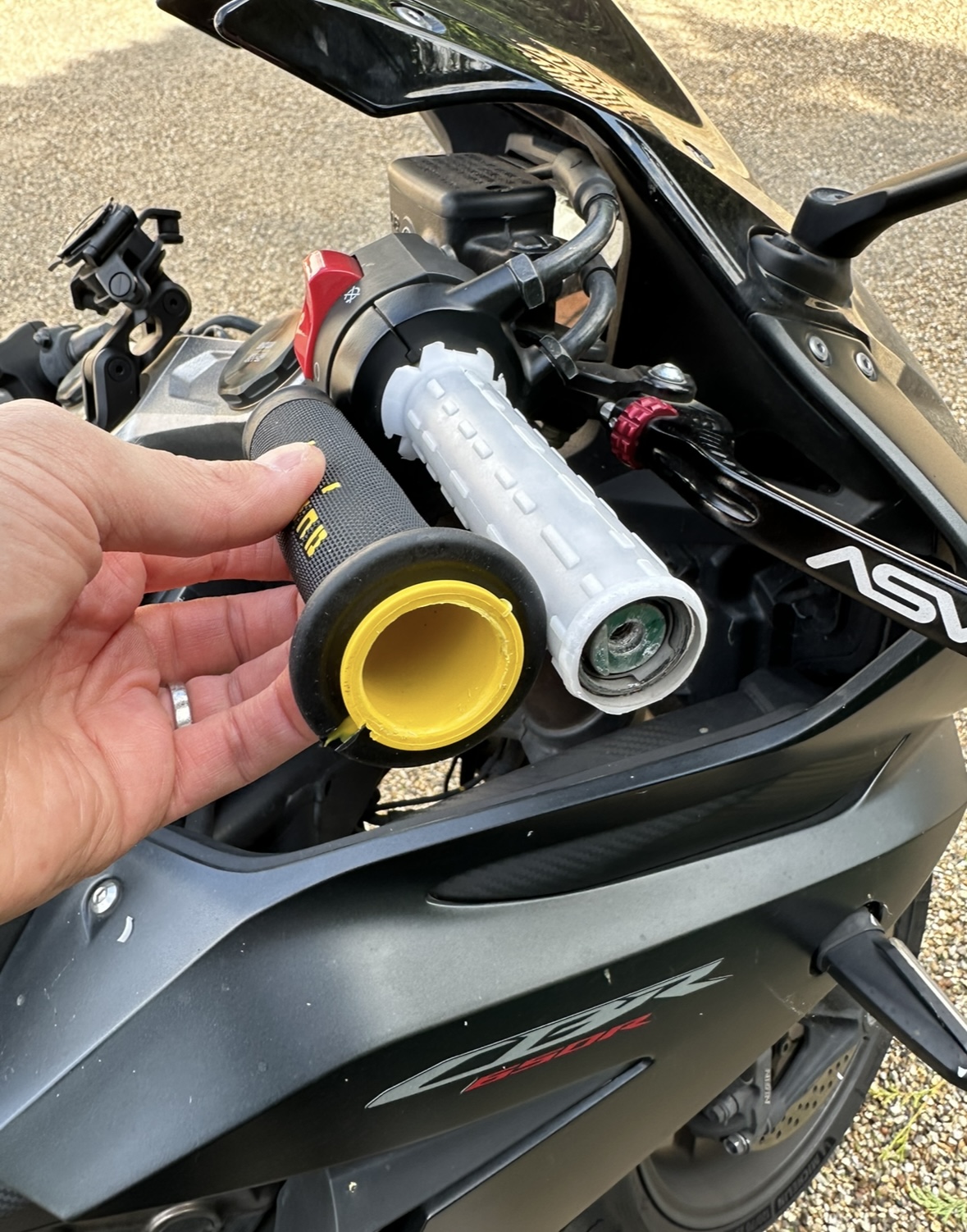

Right, currently putting on new grips
How on gods green earth do I get the throttle grip on
- IMG_8791.jpeg (557.1 KiB) Viewed 1357 times
CBR650r

Re: Putting on new grips Honda CBR650r
Squirt loads of WD40 on the inside, slide it on, let it dry, the grip will stay on, but grip glue works better.
Same, but washing up liquid works for me.
If it really doesn't want to go on you might have to rub some of those knobbly bits off.
I used the WD40 method for years but the hairspray method is less messy, works better and goes tacky once dried.
You don’t want to really have to fart about with the raised bits as they are there to help keep the grip in place. Ideally you’d want to use some Lockwire but not essential.
Another method I’ve used in the past is by using an airline, that works well. Great for removing grips that you might want to reuse.
Hairspray is my fav method.
In VERY VERY VERY small amounts!!KungFooBob wrote: Sat Sep 14, 2024 4:29 pm Same, but washing up liquid works for me.
Do NOT slather the bar in washing up liquid, it will NEVER dry.
I caught my father doing the above on the JAPton 30 years ago and gave him a bollocking for it... The grip is STILL slipping on the bar now!
Sorry didn’t mean to report your post.
Thanks for the help
Update
Grips went on, my helper gave the bikes some go faster stripes
