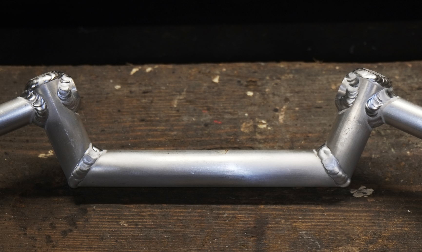

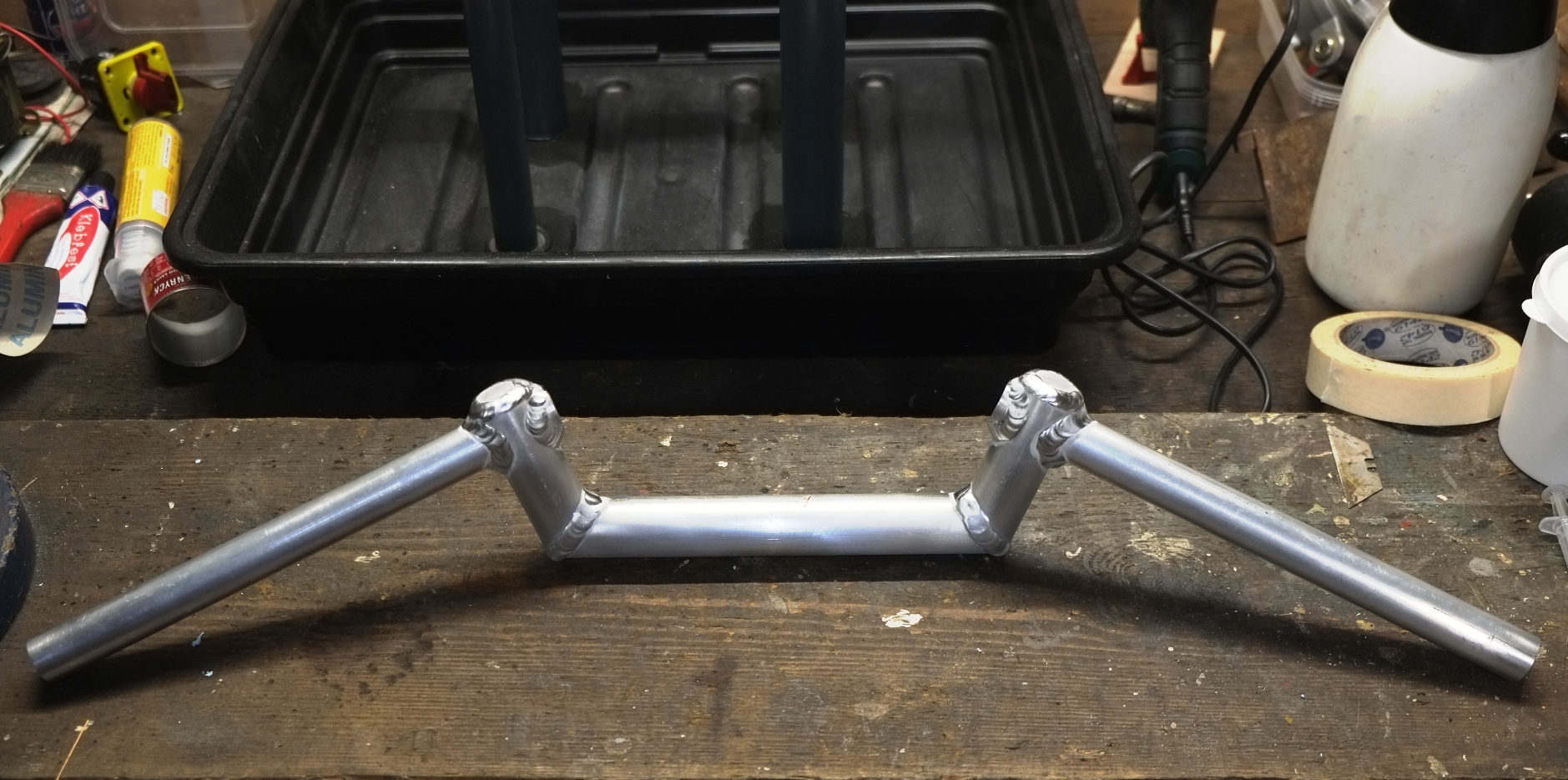

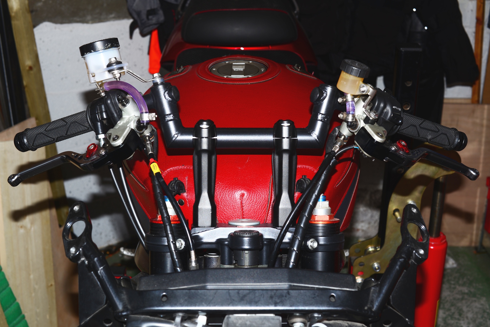

Finally got round to making the trip to the welders with assorted pieces of aluminium tube and this was the result once Chris had done his thing:
And here's a closer view of the welded bits:
Next step is to head off to the platers/coaters and get them Xylan coated in satin black.

Hah! These ali bars are basically a clone of the steel ones I'm currently using, so I can test which material offers the best vibration resistance. Here's the current (steel) bars and the much-maligned MT-09 risers:
I strongly suspect any difference will be in your head.
Which, TBF, isn't a bad place for it to be, 'cause that's the bit where you feel annoyed about vibrations too.

Skub wrote: Tue Jan 23, 2024 3:25 pm Shirley the heavier bars will dampen the vibez best? Or is it more complex than that?
That would be my guess, as well. But the ali bars are made from heavier gauge tube (i.e. more material) so that may have an impact. Or not.
Skub wrote: Tue Jan 23, 2024 3:25 pm Or maybe it matters little which material the bars are made of,because bar end weights will do the dirty work.
Nail head, meet hammer. I've had to modify both bars so they will accept the OE Aprilia bar-end weight system (discussed at length somewhere on here, not in this thread) so that will probably make the major difference.

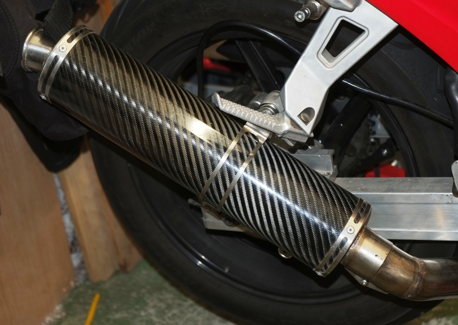

After my customary January/early February hibernation I've (sort of) woken up and started doing stuff. In a lazy, rather disconnected way of course. The object of my attentions has been the VFR. It was ferried back from France last October for a good dose of looking at the front end and clonking issues. I'm hopeful these have been resolved (time will tell) so now I need to do something about the exhaust collector box being approximately 50mm rearwards than it should be. I've resolved this problem by the simple expedient of taking the fucking thing off, pending surgery (of it, not me).
One of the benefits of being a hoarder is that stuff that I stopped using 30 years ago is still lying around somewhere. This is/was the case with an aftermarket exhaust system I had fabricated to fit the VFR (same model, different model year) that I had in the mid-90s. It was somewhere in the loft of spiders but was still in remarkably good nick and (better yet) still fitted pretty well. It completely dispenses with the collector box (yay!) and just has one pipe and one (carbon) can per side. It also sounded pretty good, if memory serves. Here's the RH side of the bike with the old/new zorst fitted and the bike on the Skylift:
And a closer look at the carbon can. It's survived remarkably well and still looks pretty good to my eyes. I'm pretty sure I got the system made up in 1995 so for a 29 y.o. can it's not too shabby. But it was made at a place that also fabbed F1 exhaust systems (Parallel Motion, unfortunately no longer in business) so that would possibly account for its longevity. I have had to get db killers made for them though - the V4 open pipe wonderfulness isn't appreciated by everyone, especially MoT testers...

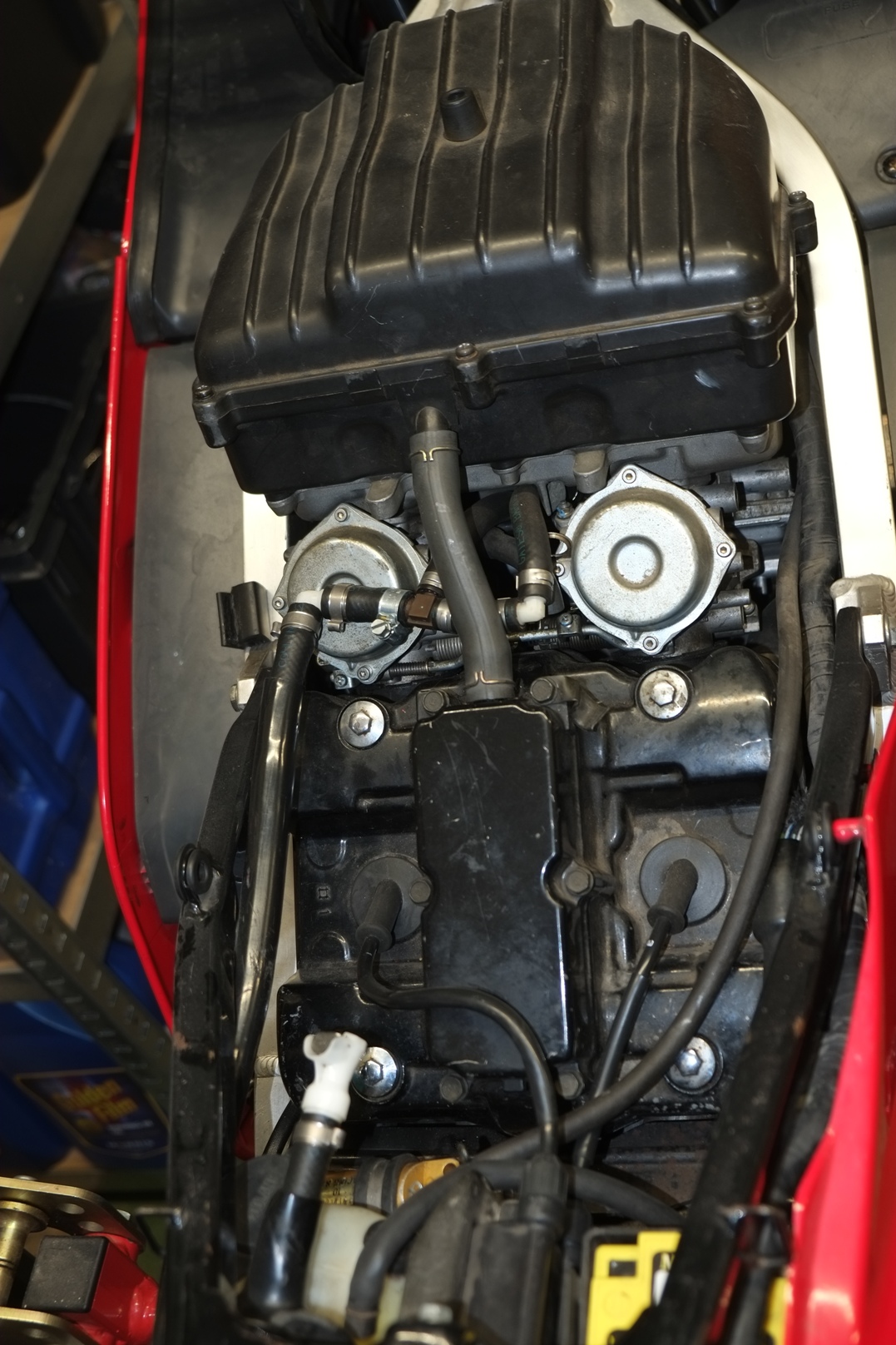

But removing all that silencing restriction and back pressure does bring its own set of complications. Hondas of that era (in fact most Hondas) are famous for running as lean as possible and today's petrol is vastly different to that of 30-odd years ago, so I think I will need to richen up the mixture somewhat. I'm debating whether to take a stab at it myself and bung some bigger jets in, or take it to a dyno and get it done properly. Are there any 'old skool' dyno operators that know how to fanny about with jets rather than just do it all on a laptop? All recommendations welcome.

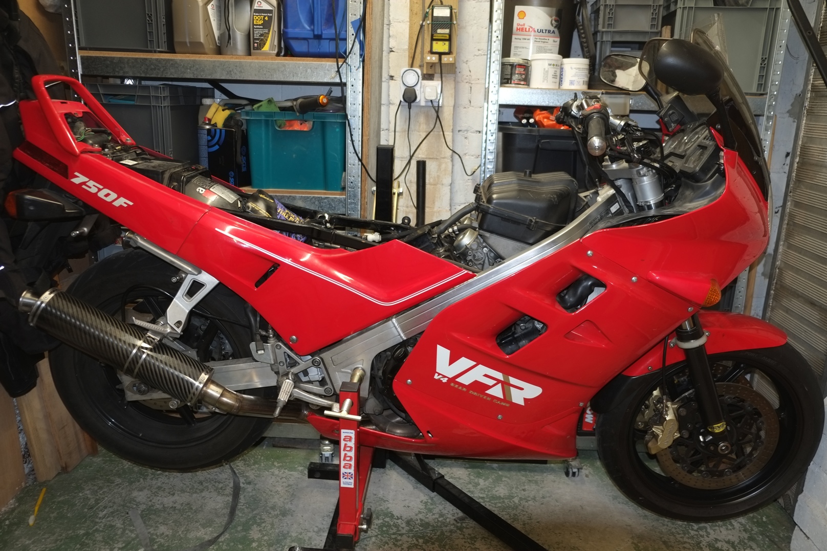

Here's what faces you when you take off the seat and tank on a 1988 VFR750...

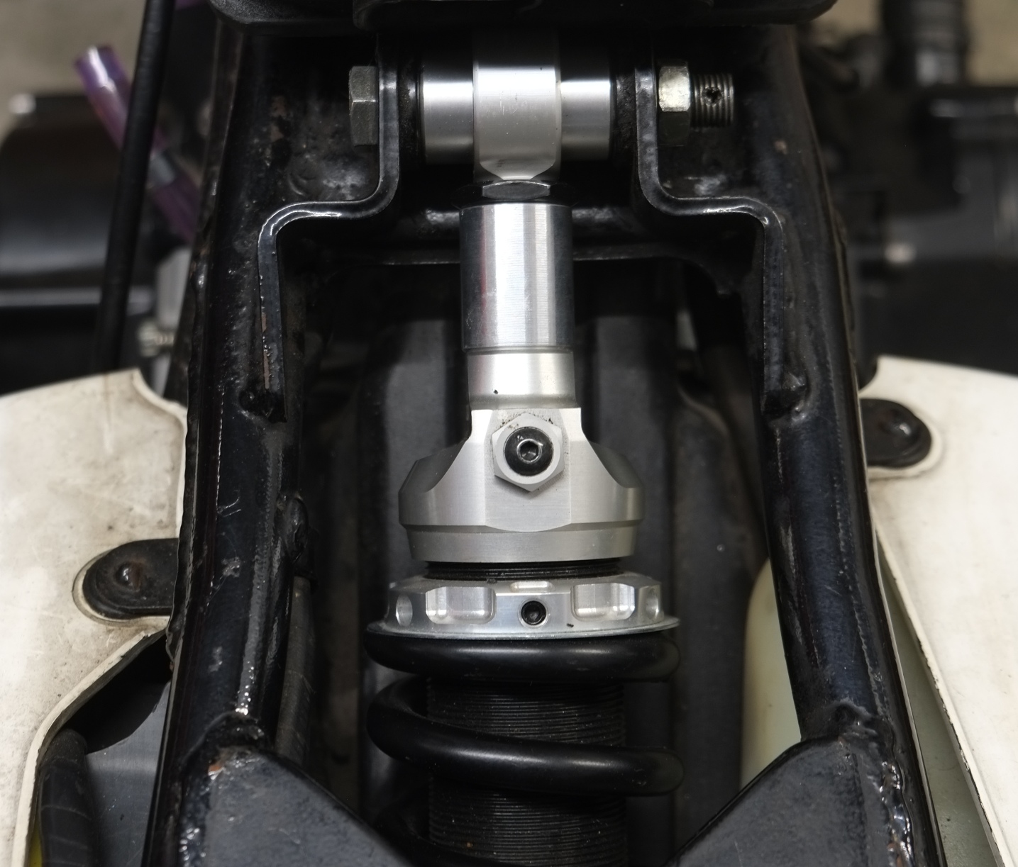

The LC has a YSS shock on it, which is a massive improvement on the 40 year old thing that supported the rear of the bike before. But after a fair amount of running, I've realised that a) the spring is a bit on the harsh side for my tender little botty and b) I'd like some more weight on the front to make it feel a little less vague.
As regards the spring, YSS ship the shock with an 80 Nm (or is that N/mm?) item. They also offer a 70 and a 90 spring in the same sizes for lighter and heavier riders respectively. So I've placed an order for a 75 Nm with a local spring supplier, just to be a fussy bastard. Delivery should be mid-March.

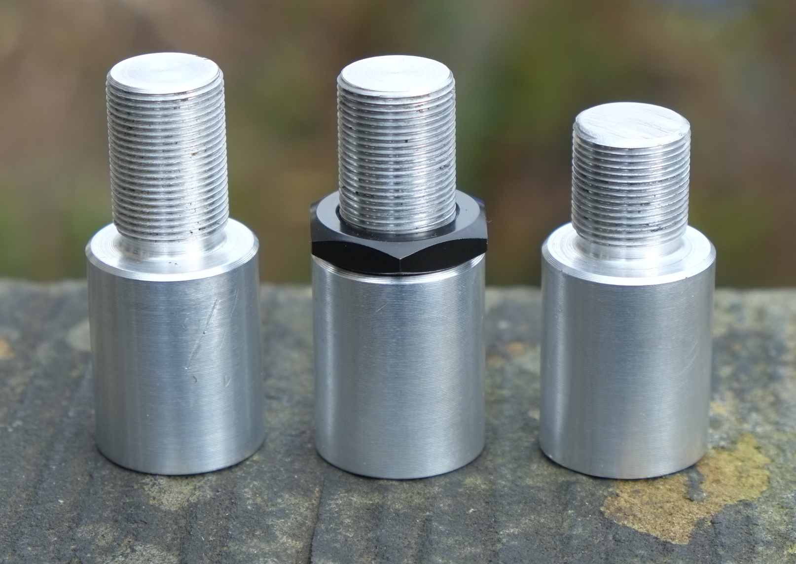

To try and fix the perceived 'weight on front' problem, I've acquired some 25mm alloy round bar and handed it to my local engineering place, along with a CAD drawing and asked them to make it happen. This is what I got back:
These fit in between the top shock eye and the shock body and increase the overall length of the shock by anything between 25 and 40mm, thereby jacking the back end of the bike up by a similar amount. The piece with the shorter nose gives a minimum increase of 25mm in shock length, the one with the longer nose and thin nut gives a minimum increase of 30mm in shock length. If you really wanted to you could increase the shock length by at least another 15mm, but frankly it's all getting a bit silly at those settings. This is a pic of the shock with short extension mounted on the bike:
To be honest, the extension piece with the short nose is probably at the outer limits of sensible modification. With that fitted, the centre stand is largely redundant as it needs to be stood on a piece of 18mm ply to actually get the rear wheel off the ground. I'm also planning to drop the forks through the yokes by 10mm to lower the front and hopefully bring the centre stand back into use. Thankfully the LC also has a side stand, but the bike now sits at quite a jaunty angle when using that (see below). At least it won't blow over in the wind...
And after all this I still don't know what effect these mods will have on the handling. I'll learn that in due course... But all the mods are completely reversible, so not all is lost if it fails horribly...

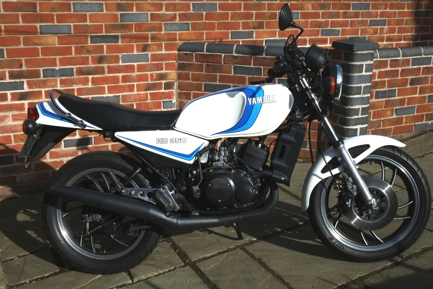

As an illustration of how the spacer has lifted the back end, here's a photo of the bike on an 18mm deep ply board, and the rear tyre is just clear of the ground (by about 5mm). There's also a lot more air between the rear tyre and the mudguard than previously...
Posts: 8855
Has thanked: 2556 times
Been thanked: 4167 times

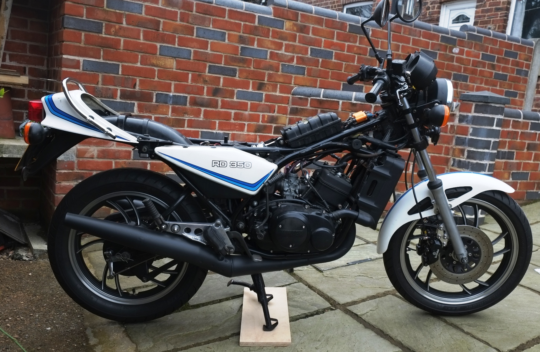

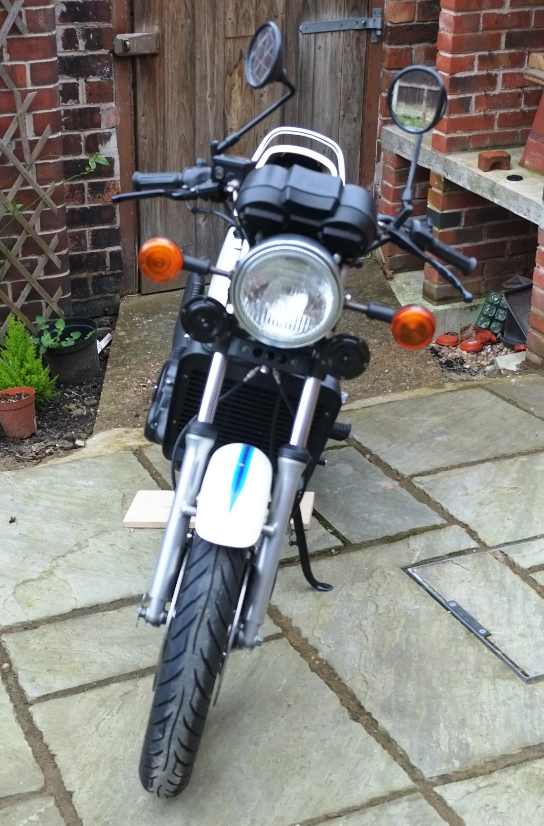

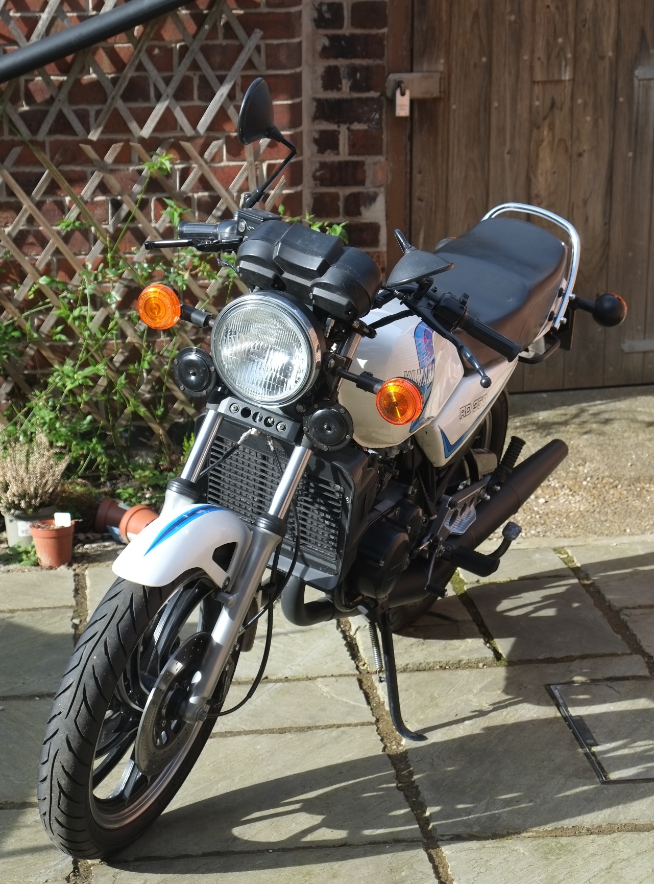

Today dawned bright and sunny (as forecast) and so the LC was wheeled out blinking into the sunlight, had its tyres pumped up and we then went for an enjoyable little jaunt around some south Yorkshire/north Derbyshire scenery. None of which I can show you, as I didn't take a camera and my dumb phone doesn't have any photographic capabilities (or any other capabilities, if I'm honest).
This was the bike's (and my) first outing this year and it was the first time I'd ridden it with the lengthened shock and slightly softer shock spring. I was also wearing new boots and helmet so was taking it steady until I had a few miles under the wheels. But within a hundred yards or so it was obvious that the shock felt much better - more compliant and no sharp kicks up the spine over harsh bumps. To be honest the handling and steering wasn't that much different with the longer shock, just a more composed and balanced feeling. There were certainly no vicious tank-slappers or terminal instability, in fact the whole plot (if anything) felt more stable than previously.
Anyway, here are some photos of the old girl in the back garden, but fully clothed this time.
and side view:
