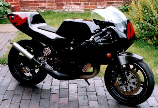

I really don't see the point of going for a great deal of extra power on a 4L0 350LC; the frame, forks, brakes and swingarm can tie themselves in knots even with standard power so more power in a standard setup is not a wise use of funds. In my (lottery-funded) dreams I'd like a tricked out 421cc YPVS motor in the Hejira chassis I sold on over 20 years ago, but it ain't gonna happen.

mangocrazy wrote: Fri Feb 24, 2023 1:19 pm I really don't see the point of going for a great deal of extra power on a 4L0 350LC; the frame, forks, brakes and swingarm can tie themselves in knots even with standard power so more power in a standard setup is not a wise use of funds. In my (lottery-funded) dreams I'd like a tricked out 421cc YPVS motor in the Hejira chassis I sold on over 20 years ago, but it ain't gonna happen.
This, look at the frame at the swingarm pivot, you've got a hugely stiff swing arm and front end and the middle is still pure 1970s* design small diameter tubing. You're just transferring the stress elsewhere.
*I know the LC came out in 1980, but it has more than a touch of 70's TZ in the design.
