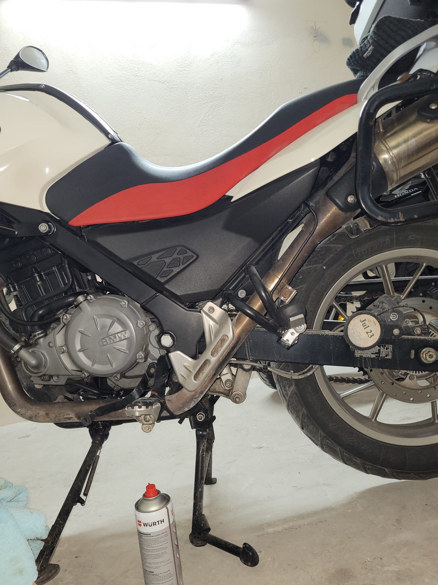

Also popped the centre stand off after noticing it doesn't always return easy. Seems to have just been dried out grease.

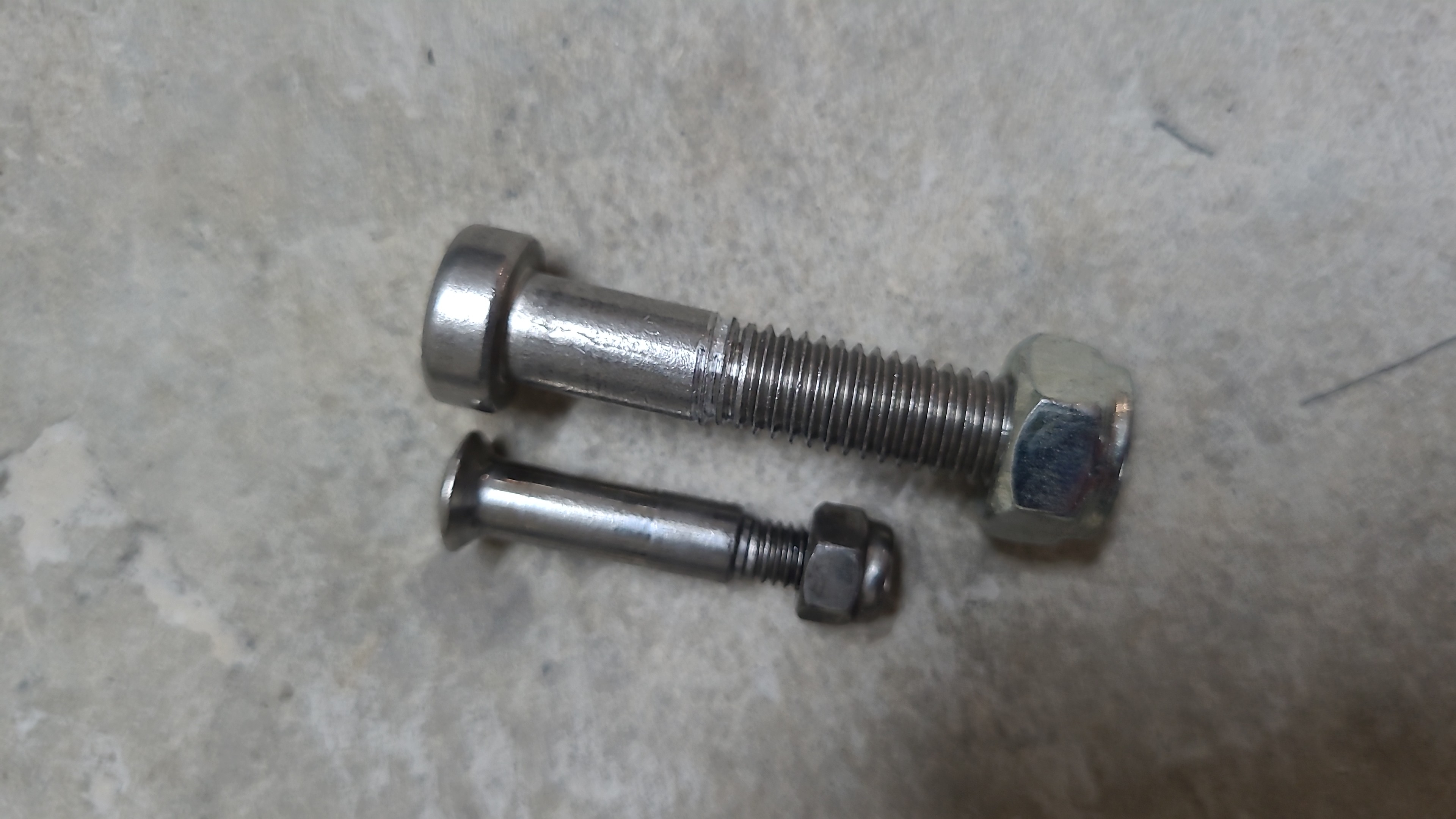

You... The clutch lever pivot bolt she told you not to worry about 🤣
BMW uses a 6mm pivot bolt with M5 threads on the bottom. The idea is that when you tighten the bolt, the nut stops at exactly the right height for your lever to move freely. It should also pinch the perch exactly tight enough so the lever moves on the pivot, instead of the pivot moving in the perch and wearing the hole bigger. The nyloc nut has sole responsibility for the lever not leaving the chat. This all is a bad idea from the get go.
On my bike the pattern (copy) lever must be very slightly thicker than OEM, because it would work fine unless I tightened the bolt down, then the lever pinched stiff. I could've sanded the lever thinner, but the design of this bolt is bad engineering and I don't like it. Every bike I ever had before, the pivot threads into the perch and there's a jam nut on the bottom. This gives you belt and braces retention of that bolt, and ensures the lever moves on the boot, not the bolt in the perch. Also, 6mm is too small for the pivot bolt, it will wear the hole oval in no time especially as there's no bushing in there.
So, I dug out an m8 stainless steel Allen bolt, cut extra threads to exactly the right length so the bolt stops before it pinches the perch, drilled the lever and the perch top hope to 8mm and threaded the bottom hole to m8.
Results - it certainly didn't snap back like this before.

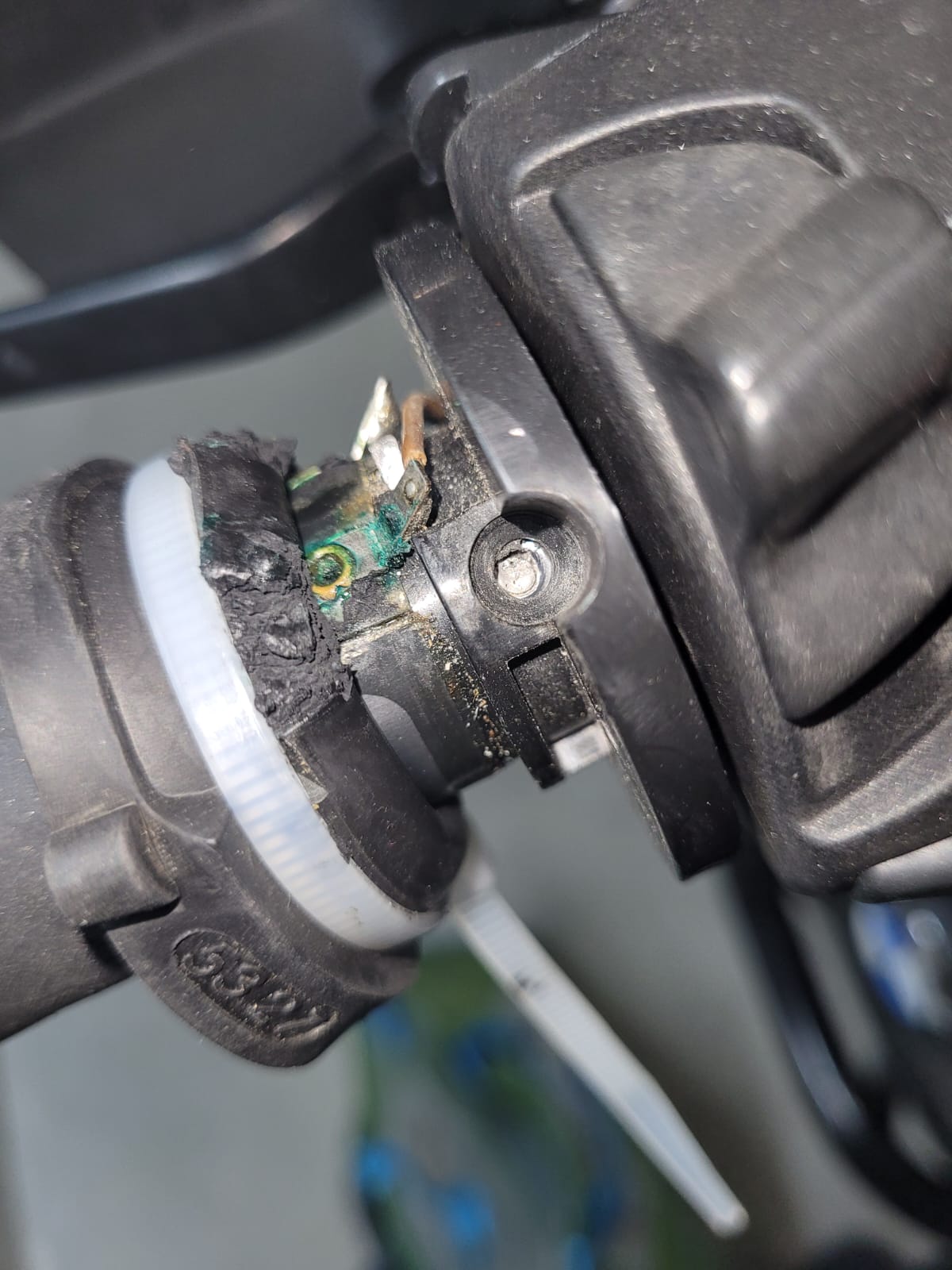

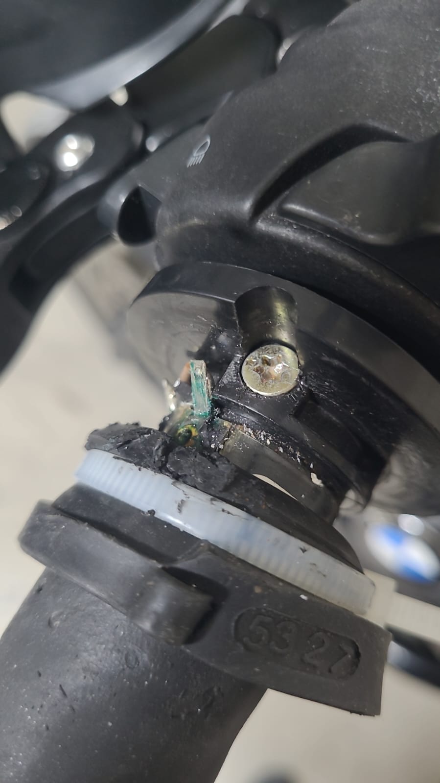

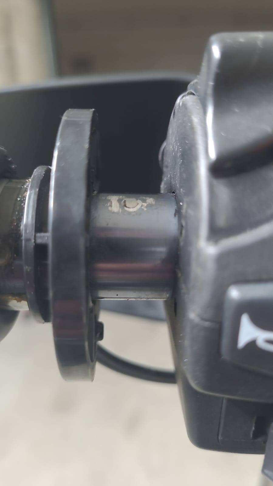

The bike has heated grips as standard. The "real biker" in me says they're an unnecessary creature comfort. But the nearly-40 year old in me likes creature comforts.
The left one was wonky since I got the bike. On the original handlebar it should be secured to the handlebar by two self tapping screws, but one looked like this:
While the other was a too-small pozi drive woodscrew.
File the busted one flat:
Put some random screws from the box in, which just happen to fit perfectly and have BMW 's favourite head on them:
There's lovely :banana-wrench:

I wouldn't add them myself nor would I spec them on a new bike I bought. But the benefit is that I can wear my thin summer gloves all year round, as the hand guards (which are absolutely useless at protection of levers or hands against trees or the ground) also keep the wind off the back of my hands.
Even though the PO has probably ran them on full power (manual calls it warm-up mode or something to that effect) too often and for too long causing the rubber to melt and look shitty, I will keep them, maybe eventually even change the rubber outer, rather than fit ordinary rubber grips.

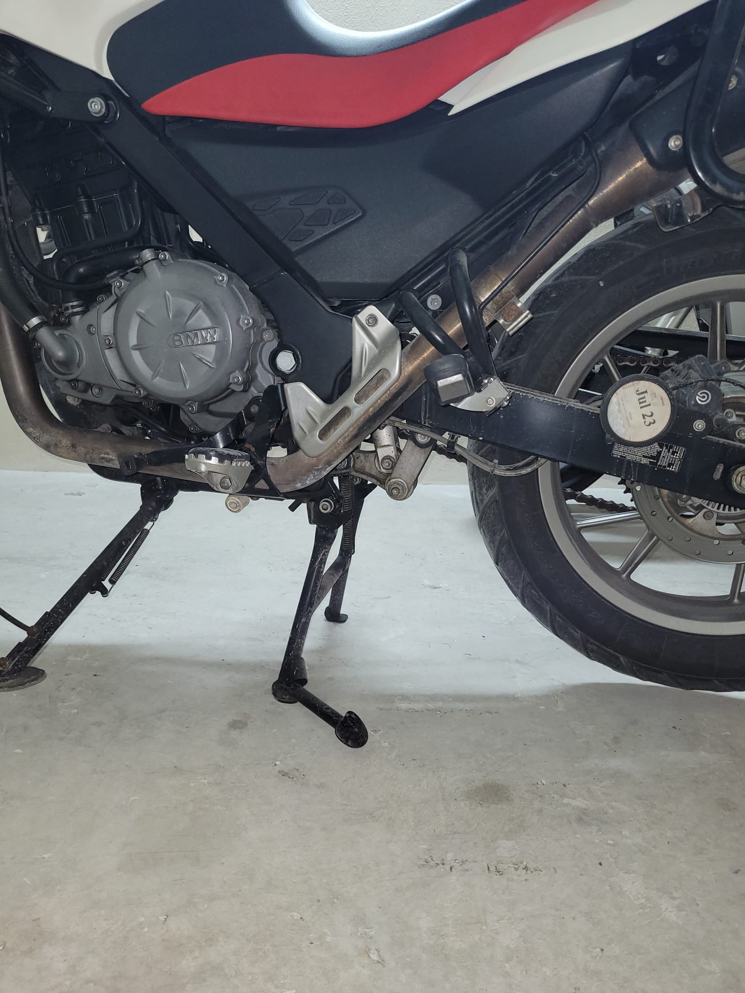

Changed the footpeg relocation brackets for my kid to be able to reach the footpegs. They'll get a test ride on the way home from school today.
The parts came from China, the main mounting holes didn't line up so needed drilling bigger, and they didn't include longer/extra cotter pins for the holes through the footpegs... not recommended!
Before
After

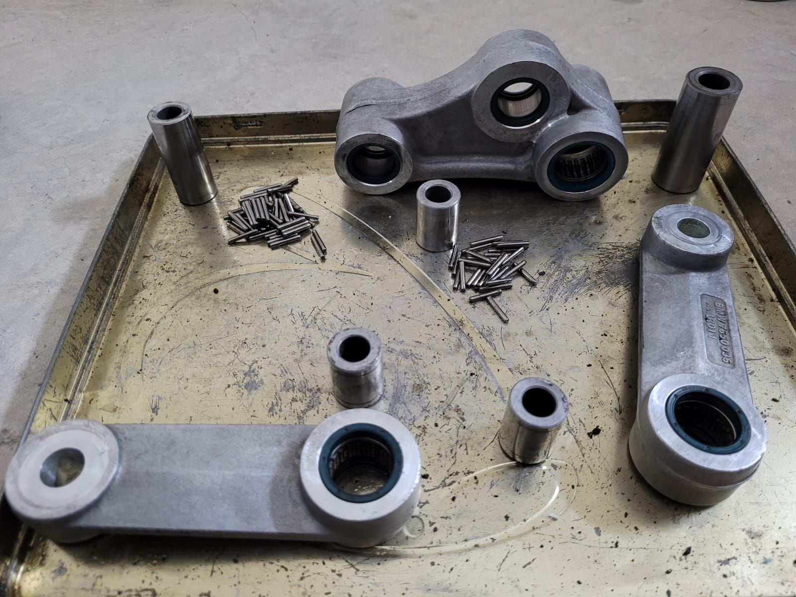

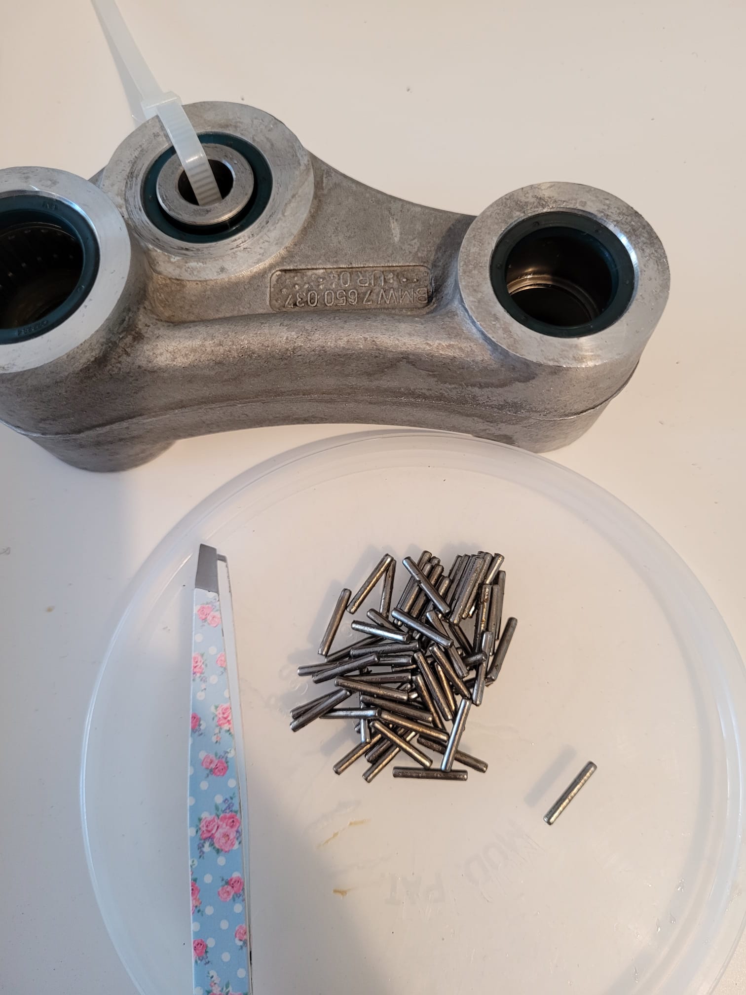

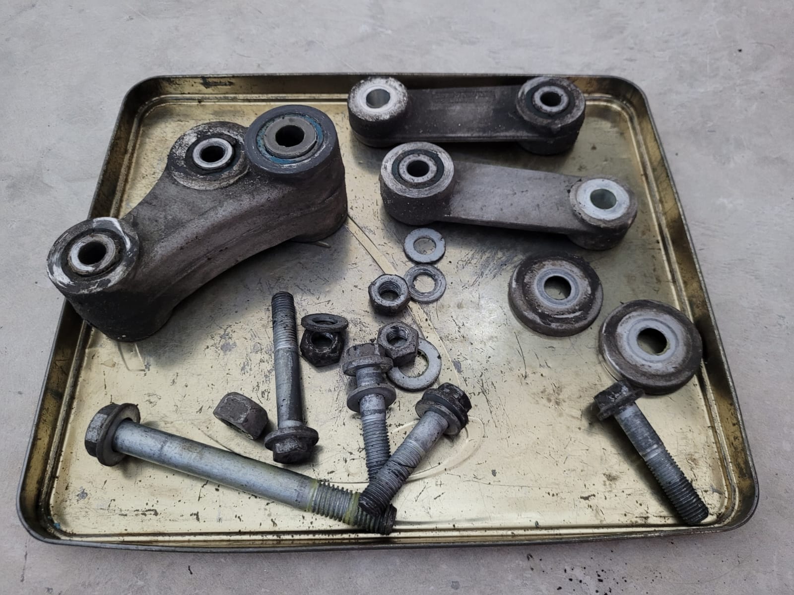

The bike always had a little squeak in the suspension, and as above I always intended to strip it down.
So, start with the linkage since it's relatively easy to get off.
Dirty, but came apart easy and no rusty hardware etc.
linkage dirty.jpg (245.4 KiB) Viewed 944 times
Gave everything a squirt and wipe down, still looking good and all the needle rollers and bushings are in very reusable condition.
linkage clean.jpg (242.23 KiB) Viewed 944 times
Always fun repacking full complement bearings!
The tweezers were Mrs_morti's, but she didn't want them back?

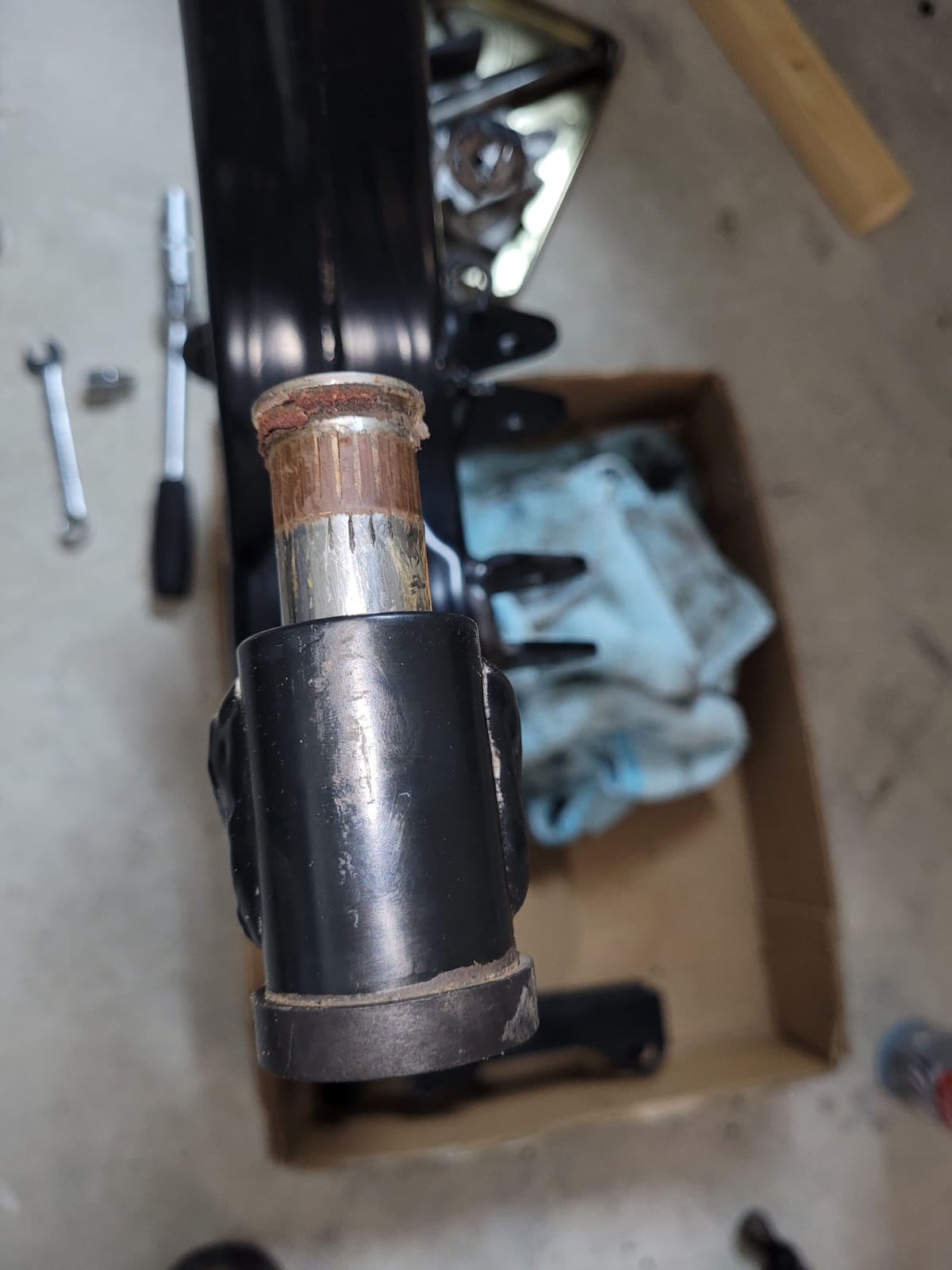

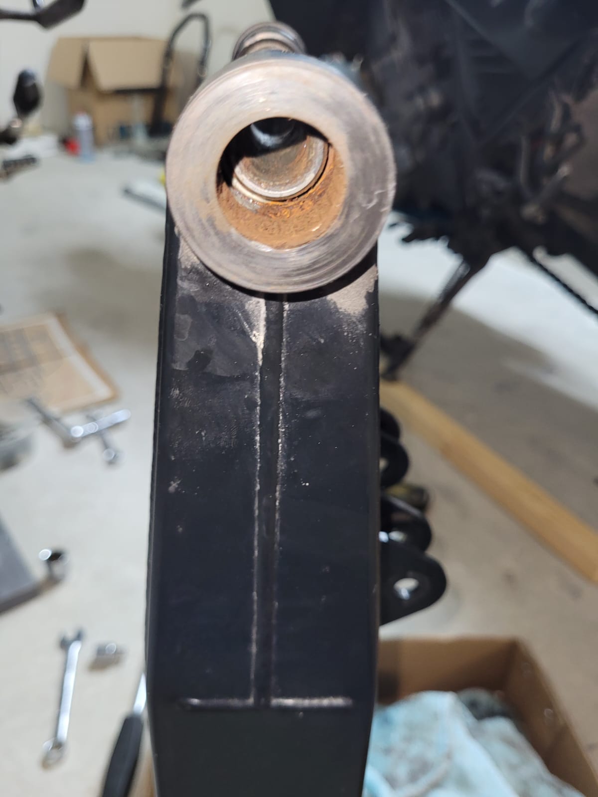

had really hoped that would be enough, but the squeak (perhaps better described as a groan?) persisted, so so on to the next job.
Welp, that ain't good.
bearing eww.jpg (103.89 KiB) Viewed 942 times
Also not great.
bushing eww.jpg (108.16 KiB) Viewed 942 times

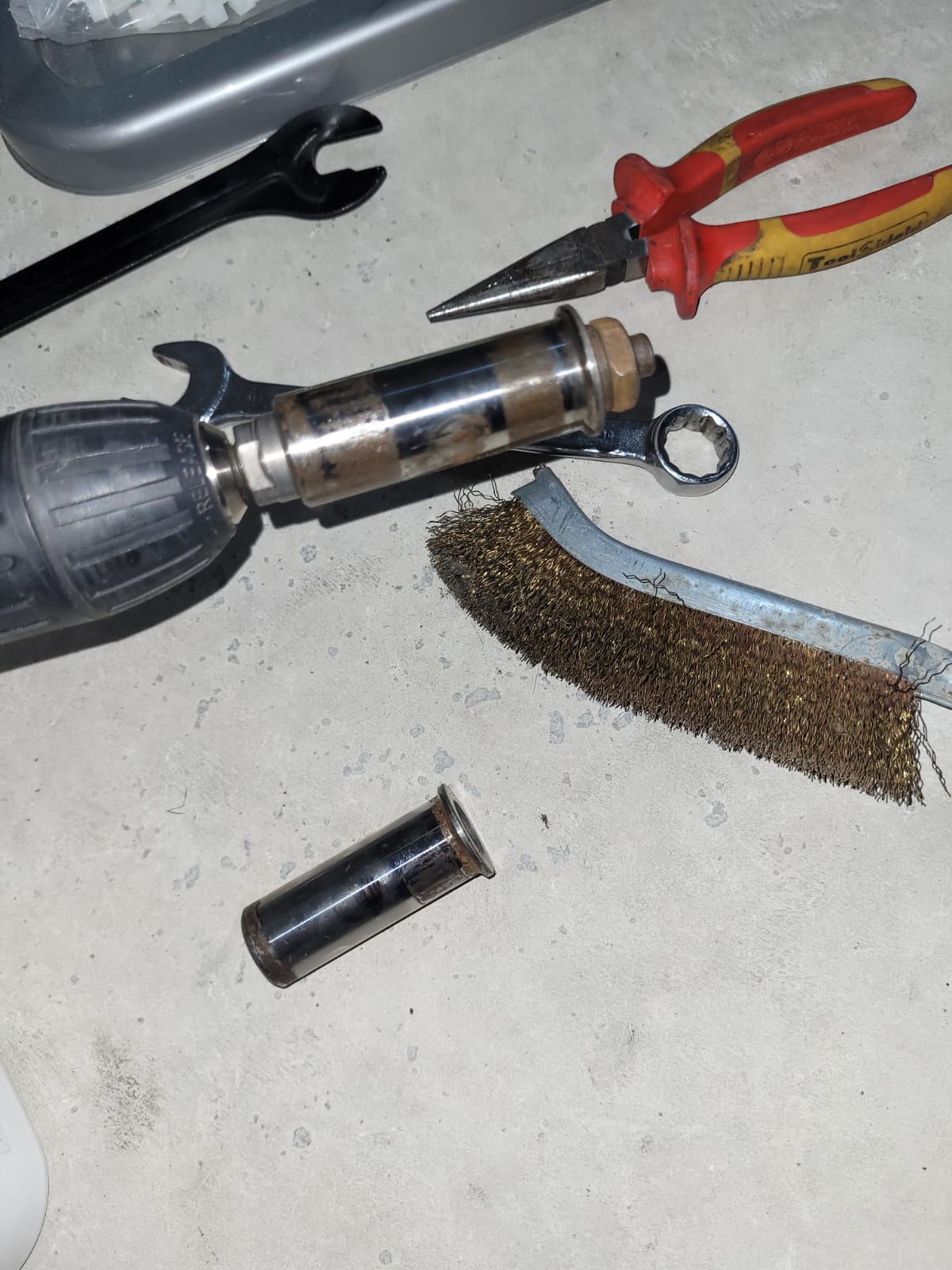

I used a bicycle front spindle as a chuck with the bearing cone for self-centring, to clean up the bushings on my drill. First the wire brush (shown here) then wire wool.
bushing polishing.jpg (208.98 KiB) Viewed 942 times
I didn't take another picture, but they got to a "good enough for a 10 year old bike with 30k miles" level.
If you're wondering why the linkage bearings were so nice but the swingarm so shitty, the answer is right here as part #2:
This foam piece of shit is meant to seal the bearings.
There's really no excuse for this, since if you drive the bearings in 2mm deeper the gap taken by the foam seals is big enough for the exact same 28*22*4 oil seal BMW used in the linkage. So, 4 of those go on the shopping list for one day when ICBA to take that apart again. Certainly before winter rolls back around.
