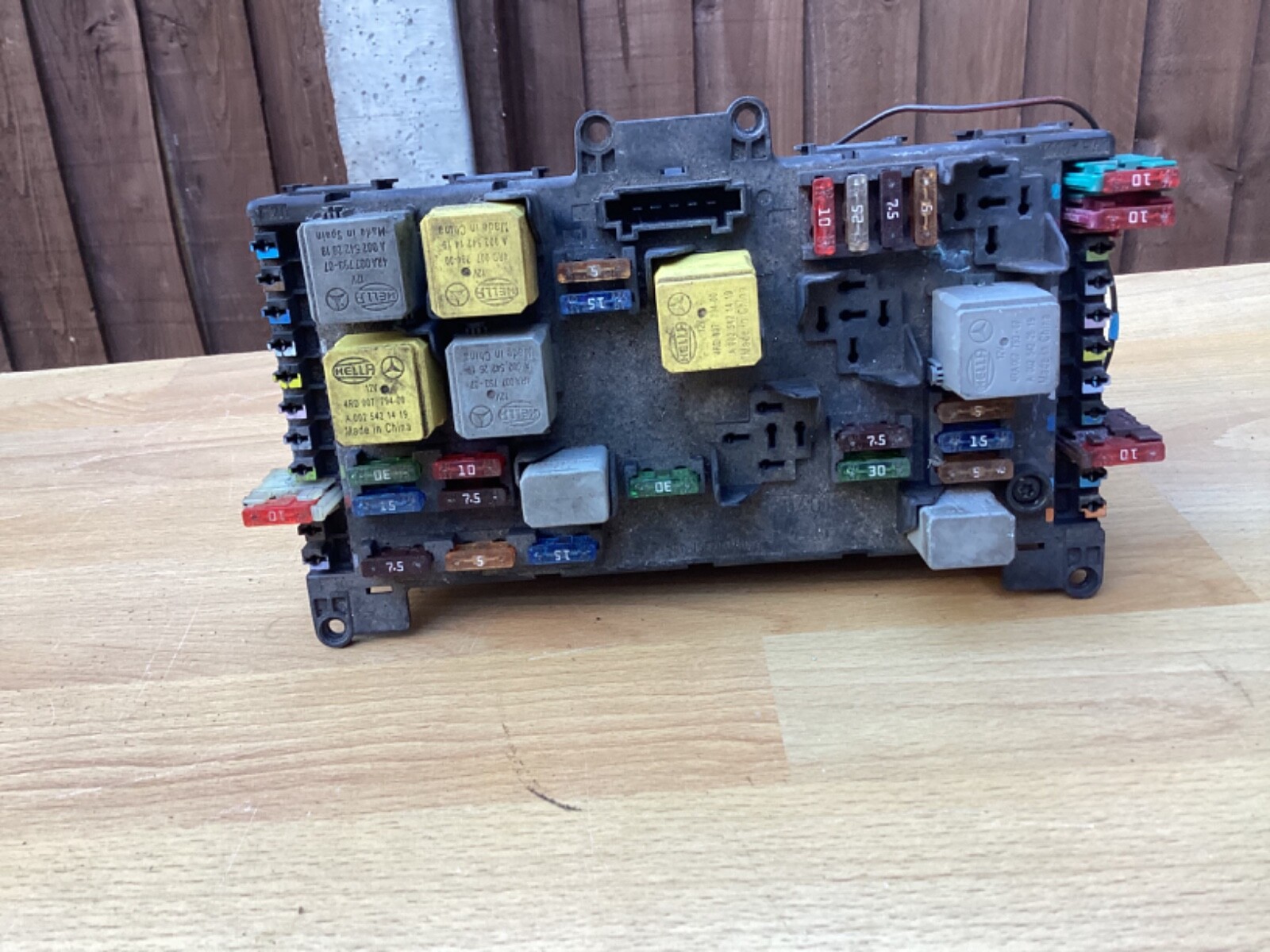

Speaking to the Tech he reckons it's this
https://www.ebay.co.uk/itm/265815652834 ... SwU7Bi7Ye2
Mercedes Vito W639 Fuse Box Sam Control Unit
He says these seem to develop a fault where they don't shut down correctly and leave a drain on the battery.
Apparently not a crazy hard job to do and not insanely expensive...
