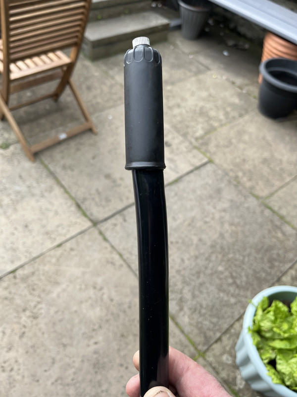

You’ll know it’s reached working temperature when things like this happen.
