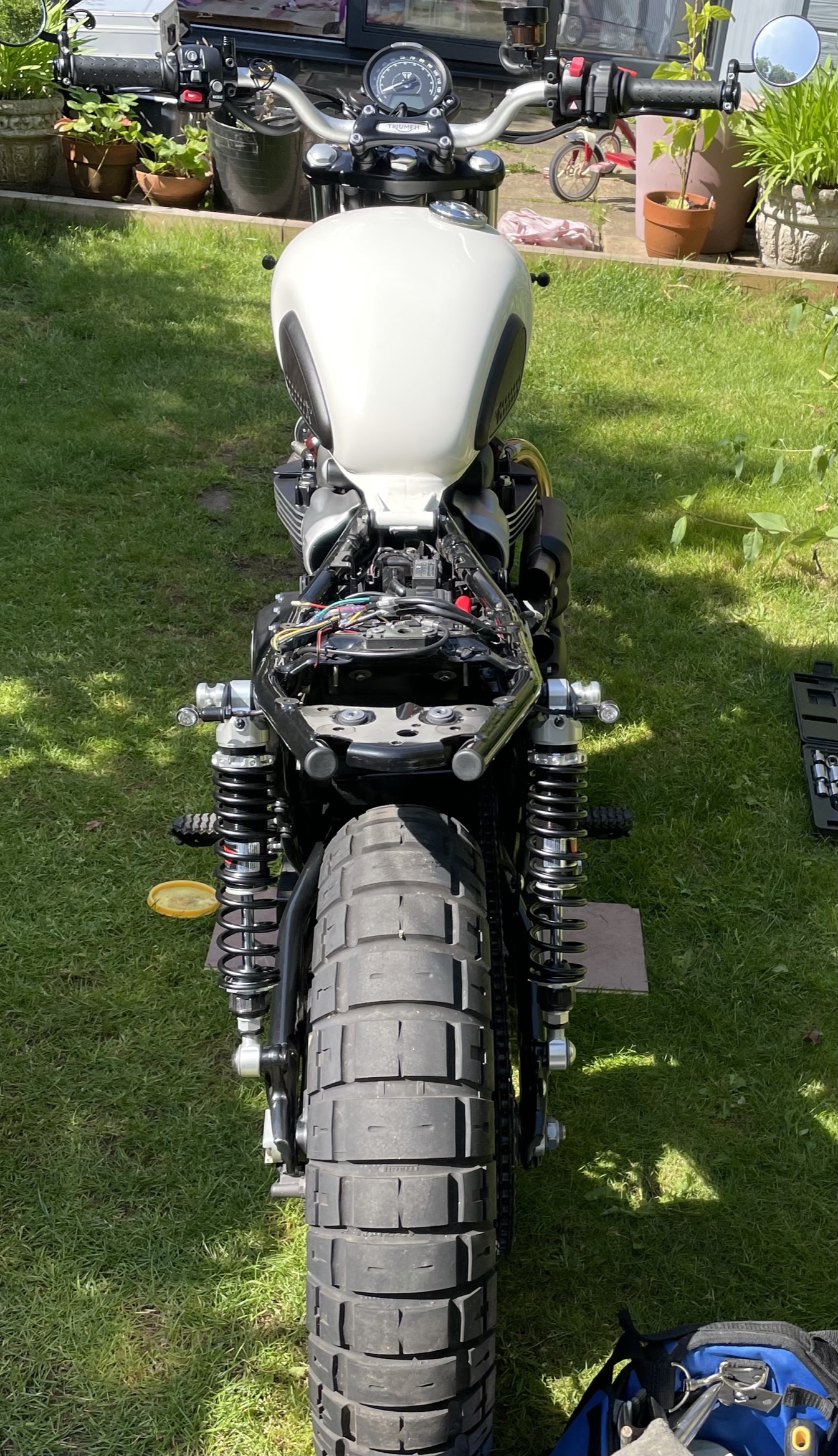

1st jobs were to tidy up the rear end, change the standard tail light, number plate bracket and indicators.
I am not a fan of the heavy look at the back of the bike so was looking to open this up a bit.
Off came the whole assembly and only the rear mudguard was refitted everything else went.
I didn’t like the various tail tidy options that were available so decided to go my own route.
Using a Motone Eldorado tail light, some indicators I’d found on line with some brackets to mount them on the top of the shocks.
Along with a slightly smaller plate the back end went from this
To this

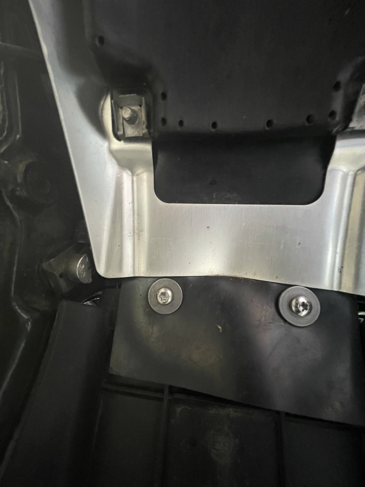

At the same time I replaced the black plastic rear mudguard with an aluminium one I was given that originally came from the 1200 Scrambler.
This was not a direct fit as I hoped and needed a bit of adjustment to fit and it also had some large holes that needed filling up somehow.
I used some 2mm reinforced rubber sheet to fit between the frame and the mudguard to fill in these gaps whilst attempting to keep the factory fitted look.
