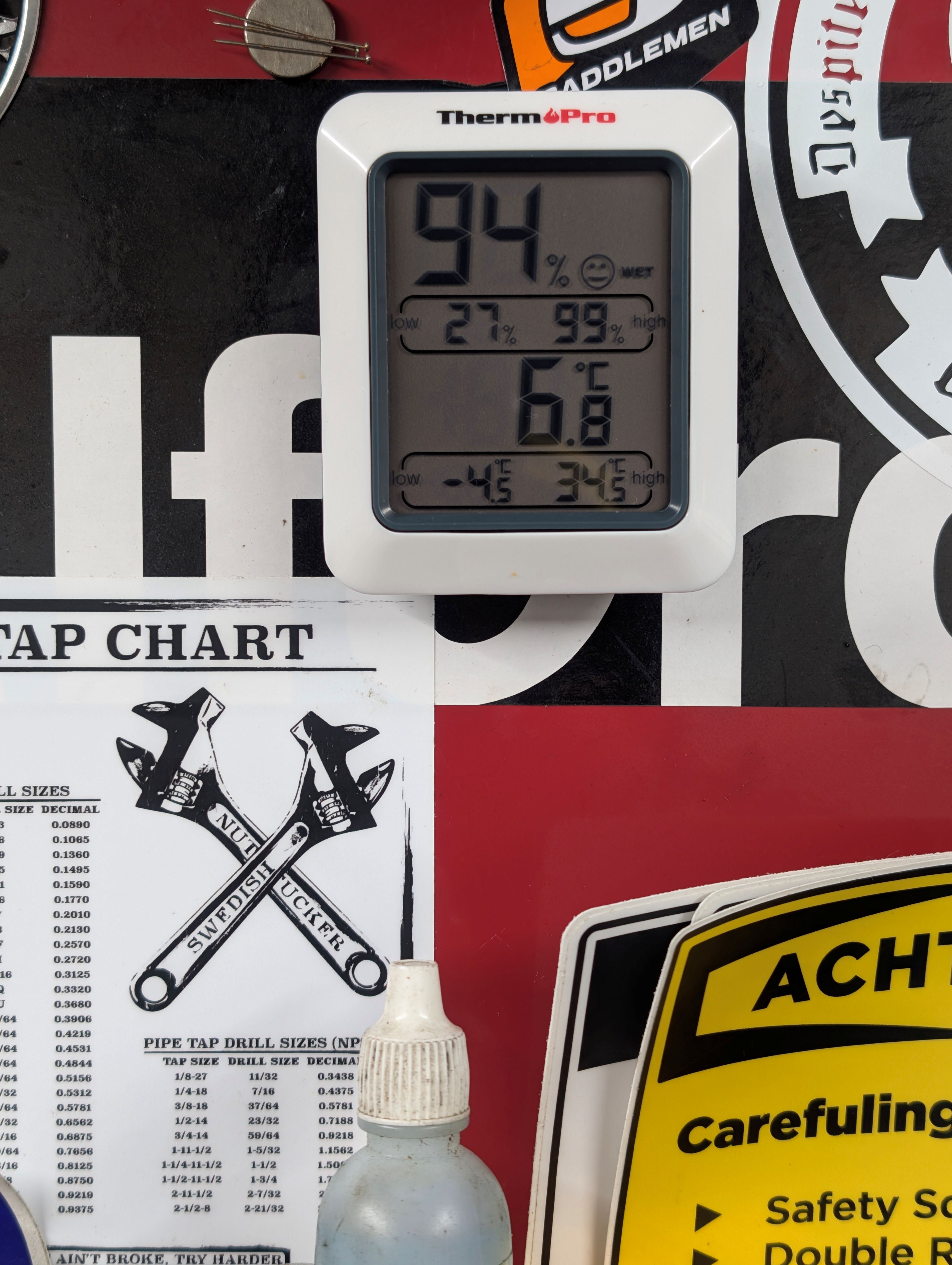

A smidge of dampness in the air tonight

I had a burst pipe in the garage last year and the humidity wasn't that high. :lol:

My double garage seems pretty watertight (it's a garage so has doors etc, never really watertight) and there's no visible damp anywhere, but the last week I've noticed that there's the start of mould on some of my textile bike kit. There definitely seems to be moisture in the air. i've kept the door open today to try and get some fresh air in but may well have to either heat the garage or get a dehumidifier.
If I have to go down that route, any recommendations?

I've got 3 Pro-Breeze dehumidifiers and v pleased with them.
Re: Condensation , perfect storm.
Nordboy wrote: Sat Dec 13, 2025 8:31 pm My double garage seems pretty watertight (it's a garage so has doors etc, never really watertight) and there's no visible damp anywhere, but the last week I've noticed that there's the start of mould on some of my textile bike kit. There definitely seems to be moisture in the air. i've kept the door open today to try and get some fresh air in but may well have to either heat the garage or get a dehumidifier.
If you leave the door open and the humidity is high outside,then it'll just add to the damp.
My problems began when building regulation dictated my oil fired boiler must be housed outside instead of happily ensconced in the garage. My solution was to run a radiator in the garage and improve the insulation,so there's not such big temperature differences between cold snaps and mild weather which is perfect for condensation.
This works well most times to keep the humidity in check,but for those time when it gets out of hand,then the dehumidifier gets pressed into use.
I use the same Meaco as @Tricky which doesn't cost the earth to run. Loadsa stuff earlier in the thread.
I use a weather station thingy so I can read the temp and humidity in the garage from the house. This allows me to spot any rise and nip it in the bud.
Dessicant dehimidifiers are better for very cold spaces but they cost a lot more to buy and run and I haven't seen any domestic ones for sale. Mould doesn't grow well at very low temps so a standard compressor version shoud help.
Avoid Peliter (solid state) dehumidifiers, much less efficient and usually sold as small cheap units but I've seen a bigger version in Lidl this week. If you pick a box up and it doesn't weight as much as a fridge then it's probably the wrong one.
I've tried different brands and found Meaco is good but maybe a bit pricey for a garage, I have a couple of own brand 12l ones form Morissons and Tesco that work well and cost about £100. You'll need to plan what to do to empty them as the tanks can fill quickly, most can attach a small hose that runs out of the door so it doesn't need emptying.
