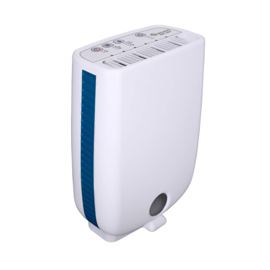

As you have power in there, my rec would be to get a de-humidifier - it's what I've done at this house for the garage and it's been brilliant- my garage is below the ground level of the house and a good bit of the garden so really does suffer from damp, and as soon as the weather started getting colder my bikes were soaking wet every morning, I fannied around with a greenhouse heater which didn't do it in mine ( might in yours if it's smaller and has better ventilation I guess) , I thought about putting vents in, but bought one of these to try and haven't looked back.
Everything is bone dry ( I'm getting 5 or 6 litres of water out of the air in there every day at the moment
), it warms the garage up a bit , and costs 3/5 of f-all to run
This is the one I bought- it has a tank and auto-shuts off when full, or if you connect a small-bore hose and run it outside so you never have to worry emptying the tank
https://www.appliancesdirect.co.uk/meac ... E2EALw_wcB

@Tricky What is the sound level of the dehumidifier like?
One place I could do with one is the unheated conservatory. The previous people left an air con/dehumidifier behind..and I found out why. It sounded like an RB211 engine! IIRC Hairy Ben had a similar problem when he tried to cool his room during a heat wave.
If it's quiet I'll try one.

It does of course make a noise, but is not what I'd call loud- I have the radio/music on in the garage and don't have to have it noticably louder to compensate. I'll see if I can record a little clip and post it up over next day or twoCount Steer wrote: Wed Feb 23, 2022 9:50 am @Tricky What is the sound level of the dehumidifier like?

Yup, agreed- the one I have is

No worries, that's good enough for me. I saw the dB figure in the link and have no idea what that sounds like but if you can hear the radio it's definitely quieter than the thing I skipped! I'll probably get one.Tricky wrote: Wed Feb 23, 2022 6:47 pmIt does of course make a noise, but is not what I'd call loud- I have the radio/music on in the garage and don't have to have it noticably louder to compensate. I'll see if I can record a little clip and post it up over next day or twoCount Steer wrote: Wed Feb 23, 2022 9:50 am @Tricky What is the sound level of the dehumidifier like?
