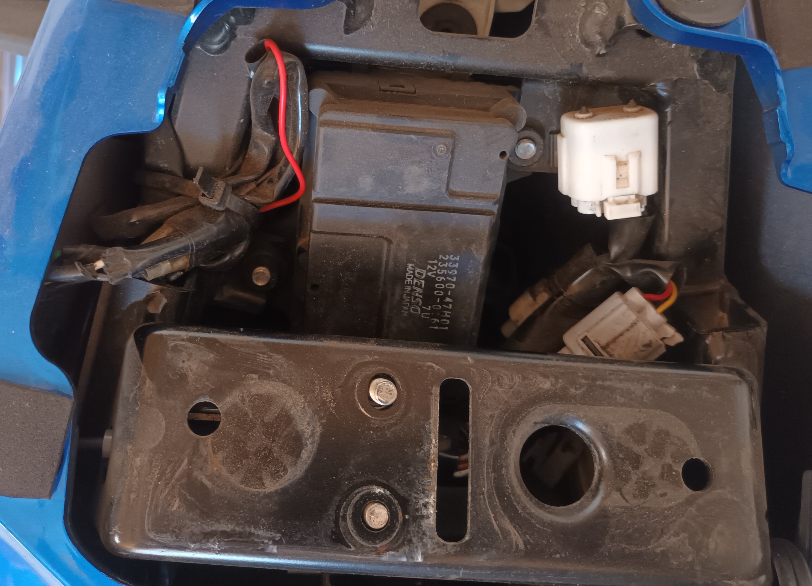

Re: Dead Suzuki
Nothing obvious...

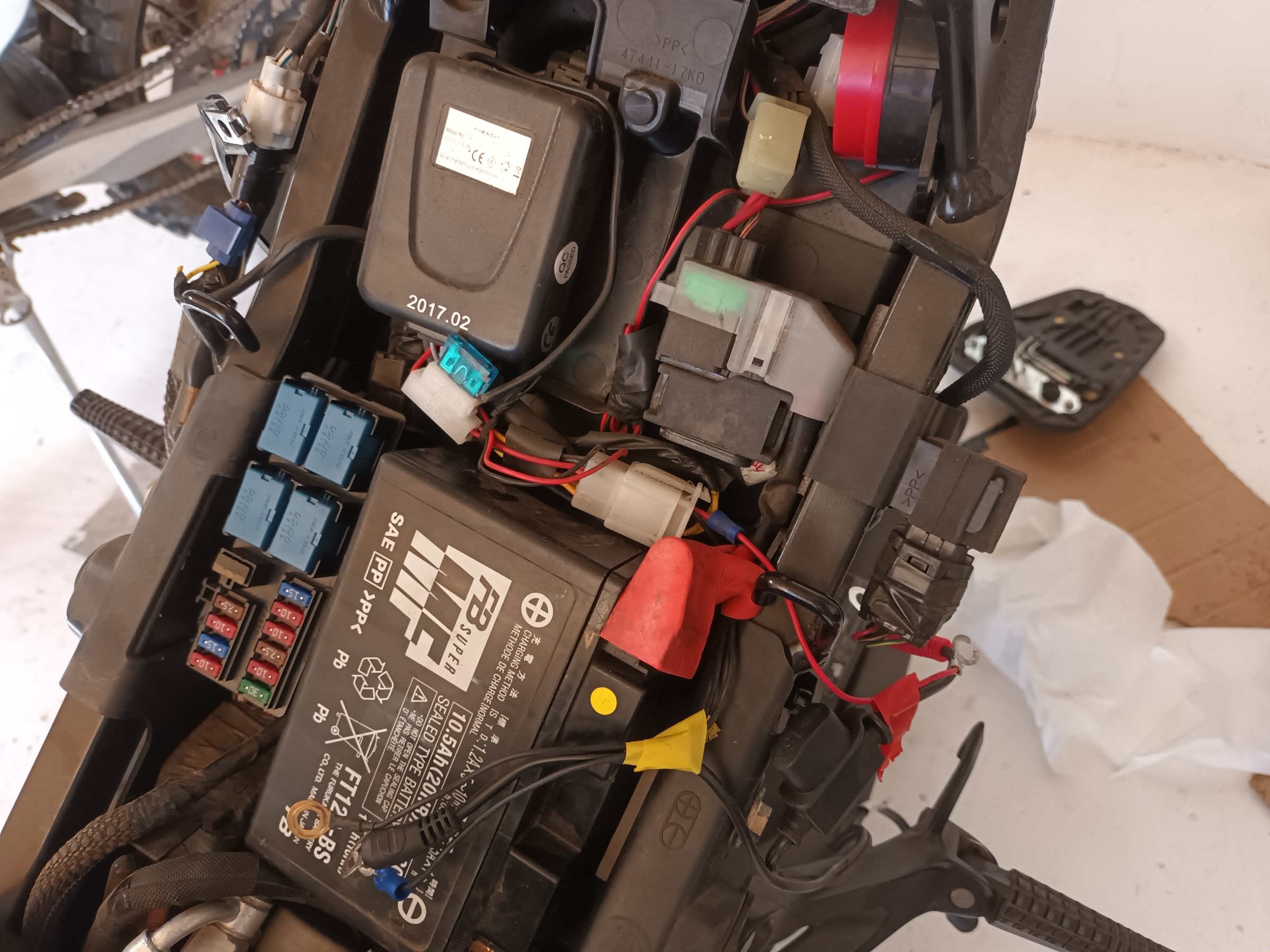

Re: Dead Suzuki
It's the green thing under the white plastic cover on the left of your picture
Posts: 12162
Been thanked: 4529 times
Re: Dead Suzuki
Is the blue fuse for the immobilizer?

Re: Dead Suzuki
Le_Fromage_Grande wrote: Thu May 19, 2022 1:22 pm Is the blue fuse for the immobilizer?
Alarm :)
